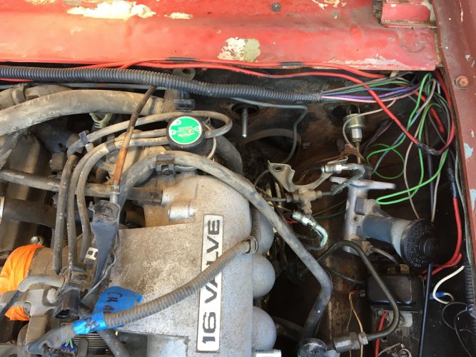

I agree, and if this Stout was in better cosmetic and mechanical shape I think I would make more of an effort to keep it original. Between about a dozen carbureted motorcycles and 3-4 cars/trucks I'm also just tired of working with carbs and smelling like exhaust because I always end up adjusting the things too rich. I plan to dissect what I need from the interior harness and ditch the rest, there's a perfect spot behind the dash cubby to hide the ecu and interior fuse panel as to keep the interior aesthetic the same. However, the engine bay will certainly be filled with some necessary plastic bits associated with a vehicle of this era. I was also driven to do this particular swap as the driving feel of the 3rz 4runner rings nostalgic for me as it was my first car and was as much a part of the deciding factor to do the swap itself.

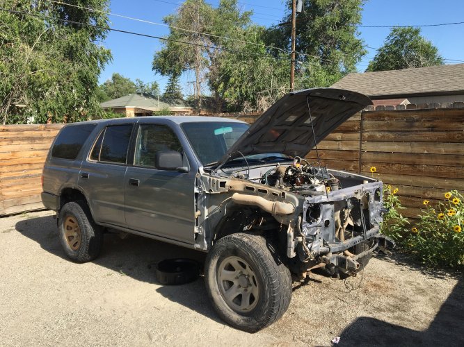

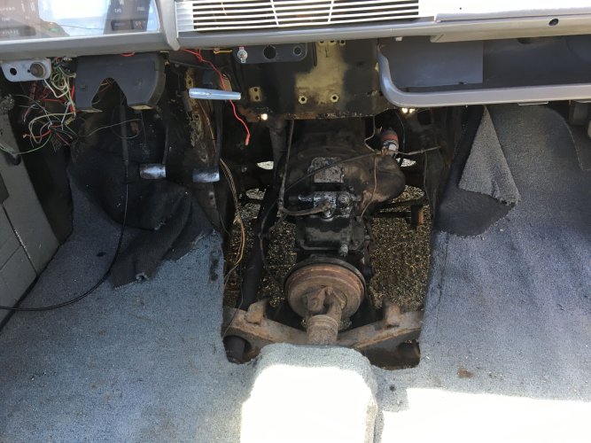

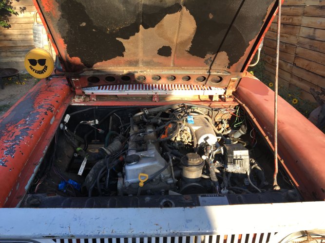

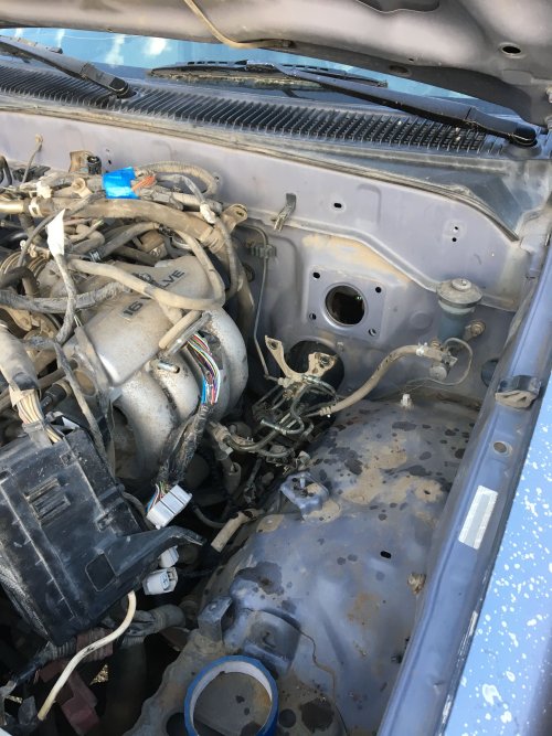

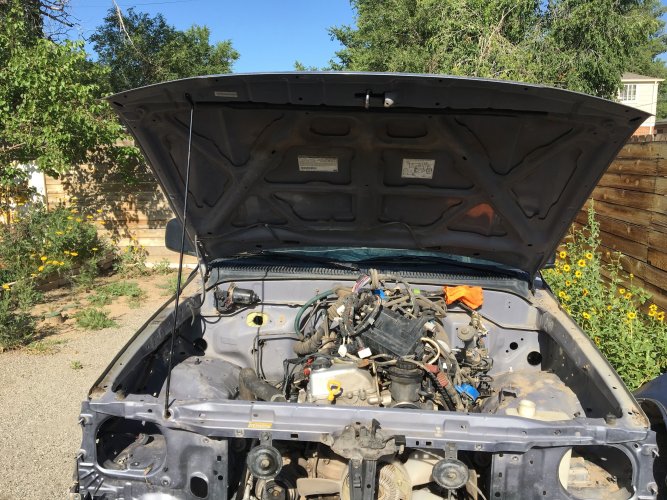

Today i reached my goal of removing the brake master and booster, clutch master, radiator, and air box.To finish up clearing the engine bay and everything going through the firewall I removed the steering column.
I continued with the theme and removed the fenders, bumper, grill, headlights, and corner lights.
I also removed the front body mount bolts and started to remove everything that is attached to the body from the underside.
Next up: Remove the rear bumper, un bolt the rest of the body mount bolts and whatever bits i find attached to the underside.

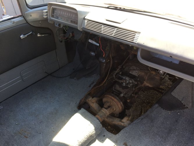

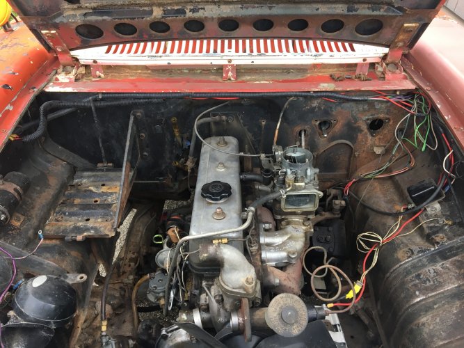

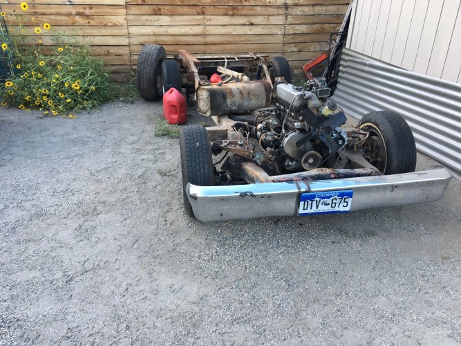

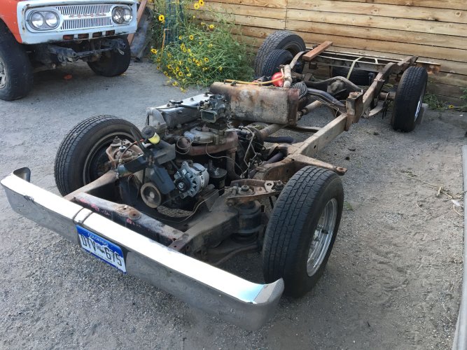

Last week i managed to get the 4runner body unbolted from the frame and other misc items removed. Now its on to dissemble the Stout. I removed the radiator, engine wiring, seat, floor panels and clutch and brake master cylinder. IMG_7384.jpg

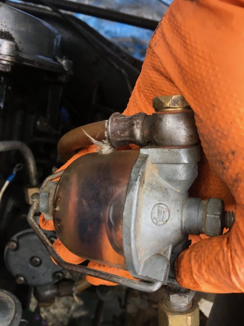

There is something about the factory Toyota fuel filter that i just love, so simple yet functional.
Although there is little to offer for sense of scale this is approximately how high the front should sit at final ride height.
Next up: continue removing the Stout body from the frame.

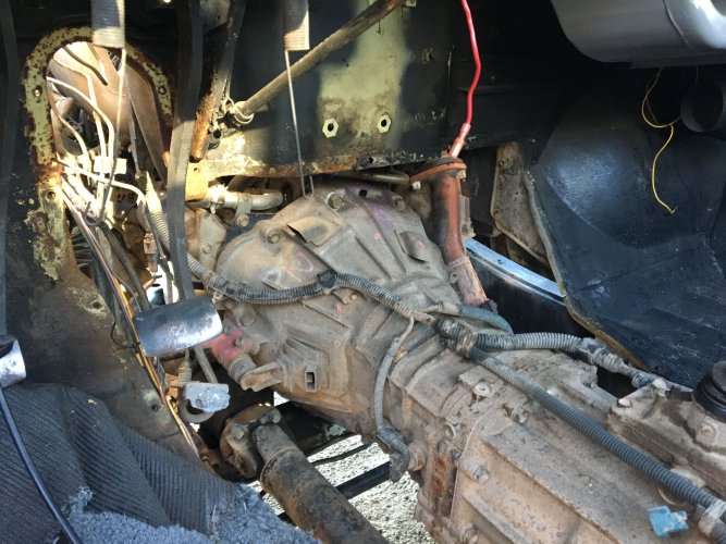

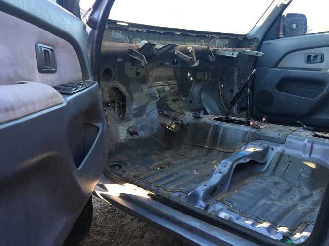

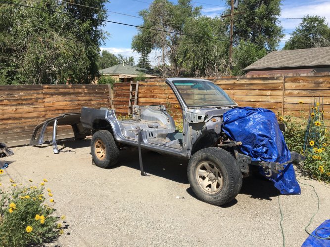

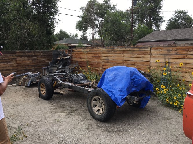

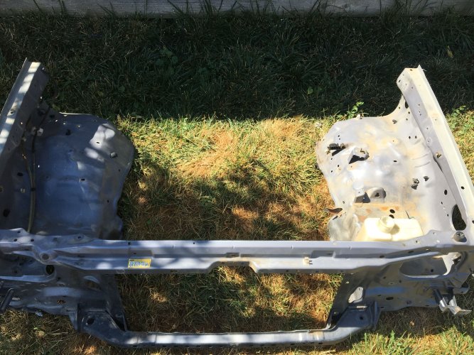

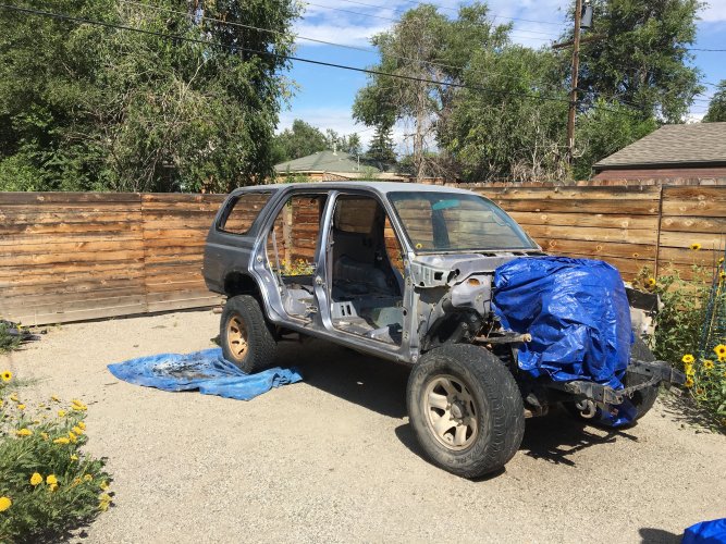

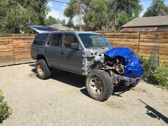

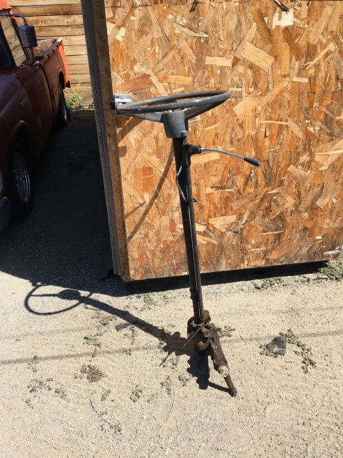

Everything is free and ready to be swapped over. The steering column was a pain to get out of the Stout. It is directly connected to the steering box so i was forced to take it out as one whole unit, whichin the confines of the small Stout cab felt like it weighed almost as much as me. The Stouts body mounts also were not coming off by traditional means so a sawsall made quick work of those pesky things.. Since the Sawsall was out already i decided to cut the front clip off the 4runner so i could power wash the frame.
Next weekend i have several friends coming over to help remove and cut up the 4runner body and lift the Stout cab and bed onto the 4runner chassis. Then things will start to slow down a bit, I'm in graduate school and have a new born child so with school starting back up and spending what limited time i have with my family i won't have free time to spend on the Stout. This is great because it will allow me to be a little more thoughtful in my approach to fabricating the things that will allow the swap to operate successfully as well as save up some money and keep an eye out for good deals on parts that i know i will be needing.
Next up: A Stout body loosely sitting on a 1997 4runner chassis

you should figure out a way to reuse the stout steering wheel, shift linkage and guages. they're super unique and cool.
HDavis
Feb 13, 2019
1,424
I agree, i plan on keeping the interior all Stout including the steering wheel and column and think that that fuel gauge, oil pressure light, coolant temp gauge, and charging light will work. I don't think the mechanical speedo will work with the 4runner stuff but that cable has been broken since before i bought the Stout and i only know it works because i drove it with it working before it bit the dust.

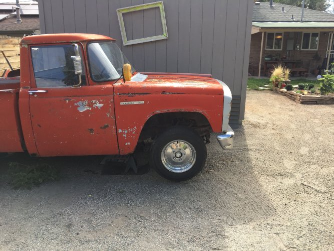

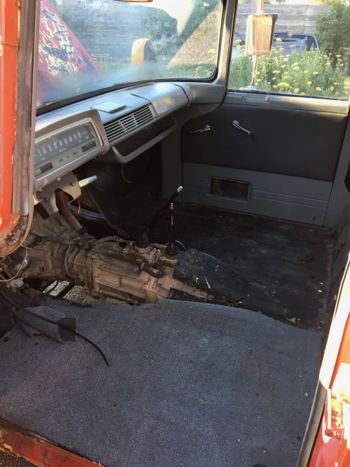

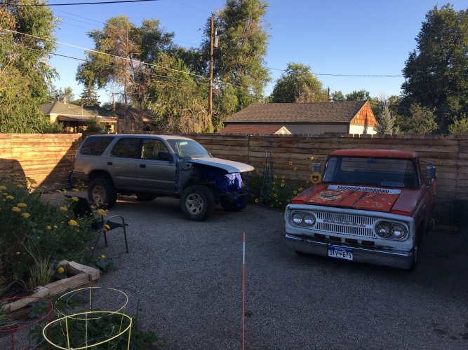

I had six of my friends come over yesterday to dismantle and remove the 4runner body and move the Stout body over to the 4runner chassis, i sure feel it today but all in all it was a success.
At first glance everything clears and lines up well and will be better with some finessing and figuring out the body mounts. I definitely am going to have to give some thought to the brake booster as that area is tight.
Now things will start to slow down a bit, ill be doing some research on all the little pieces that will help me get the Stout on the road and getting them done as i time allows. For now, its a Stout body loosely fitting on a 3rdgen 4runner chassis pretty darn well!
