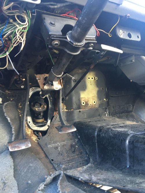

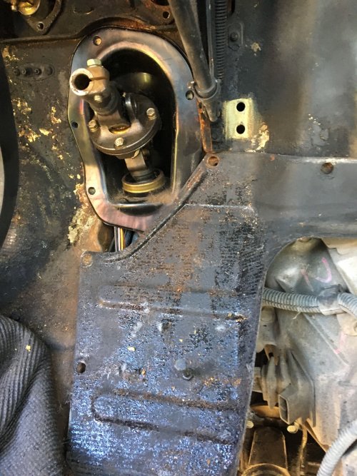

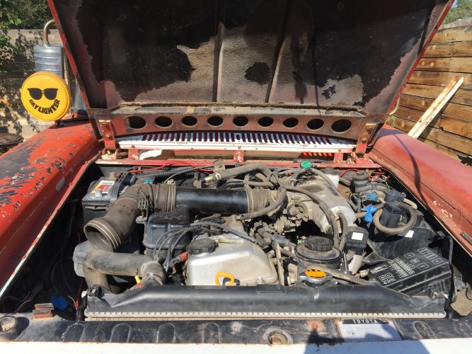

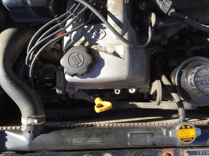

Well i was too excited to stay away from doing more work on the Stout and managed to get everything stuffed in the bay. The clutch and brake master cylinders are bolted in place and although i had to drill new holes for the studs and remove the booster ( i wanted to keep it but the last 2 cars I've had have had manual brakes) they bolted right in, who would of thought the original clutch and brake pedals would work too, i sure didn't. The gas pedal still needs mounted but that should hopefully be pretty simple. I also got the lower section of the steering column connected and what luck, the firewall bypass fits great! I still need to cut the columns up so i can marry the Stout steering wheel and column with the 4runner shaft but that should be pretty straight forward and easy.

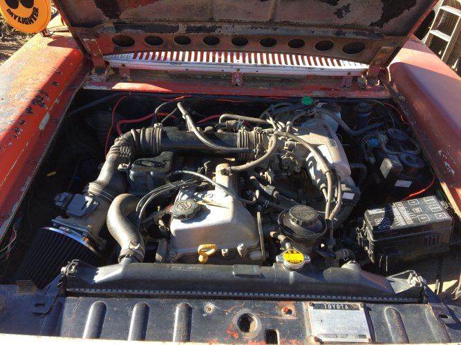

The fan was occupying the space my radiator needed to be so i removed it and the stock radiator slid right in. I was able to quickly fab up some brackets to mount it in place and ordered some electric fans to make up for the absence.
The air box just isn't going to fit with the whole set up so I ordered a cone filter to connect to the mass air flow sensor tubing and it should fit in there, although eventually i would like to fab something up to pull air from the fender since there is loads of room in there.
The fuse box and evaporative stuff fits and still needs mounting holes drilled but that will be quick work. I will need to order a longer positive and negative cable since the battery is staying in the stock Stout location, which it fits.
Underneath I have got some work to do still, i didn't want to mount the body until i had everything in the bay figured out incase it needed to move a little for a specific component. There are both wins and losses when it comes to the body mounts, there are 4 mounts that line up with the cab great and just need holes drilled and bolted in, the cab had 5 mounts originally and i need to make a 5th one to mount the front which is simple and straight forward. The bed is going to be tough, on the passenger side i can use the original Stout bed mount which also interlocks with the cab, however on the driver side the gas tank occupies the space where the other mount needs to be. The rear mounts are off about 3 inches on each side between the 4runner body mounts and the Stout bed mounts, i figure i can pull the bed off and just weld in new mounts to line up with the 4runner mounts.

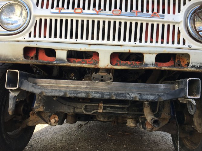

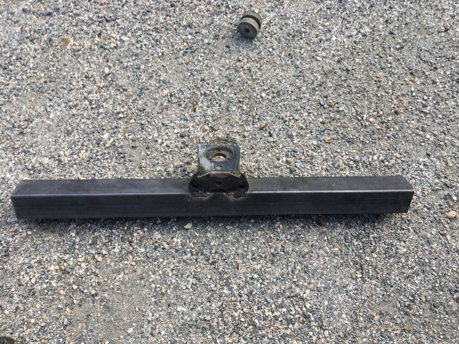

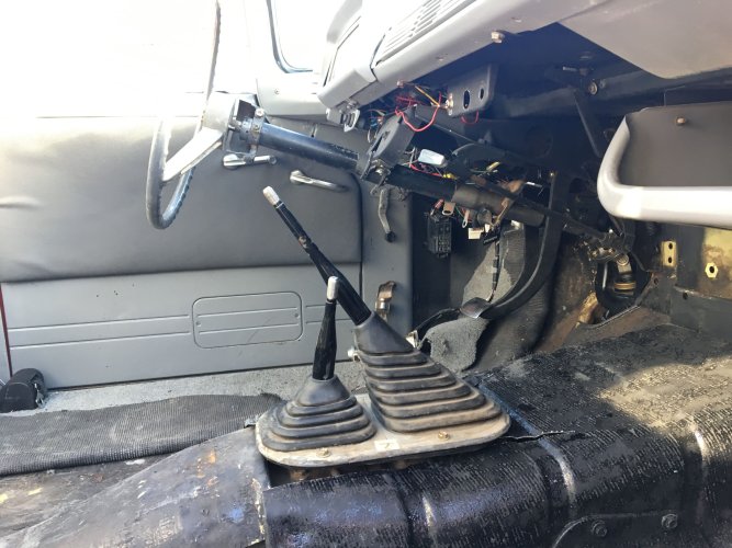

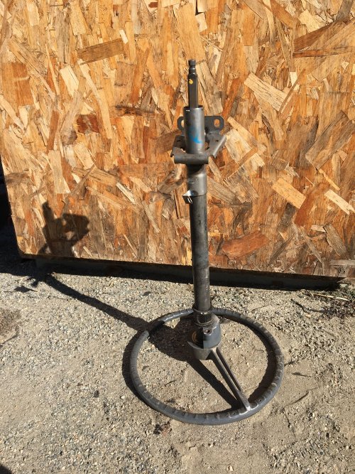

Ive been slowly doing things on the Stout as time allows. The front body mount on the Stout is located right in the center of the body so i needed to weld in a new cross member to weld a mount to. It was a pretty straight forward ordeal 2" box tubing and salvaging the 4runner body mount made quick work of it all.

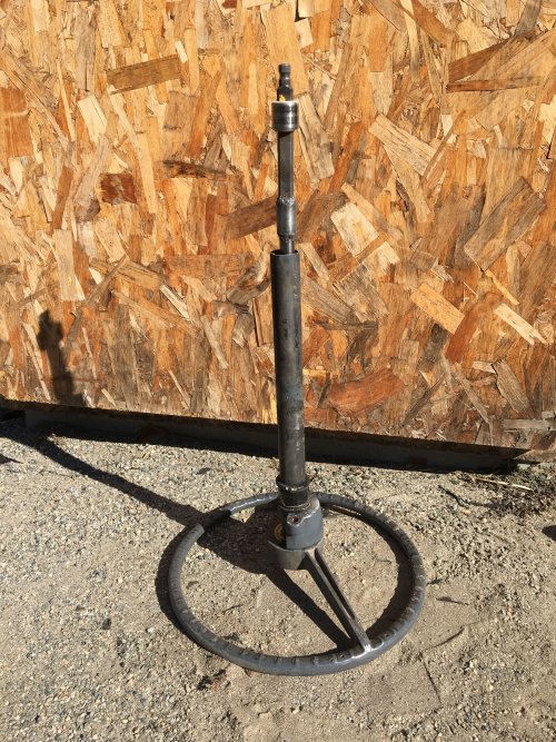

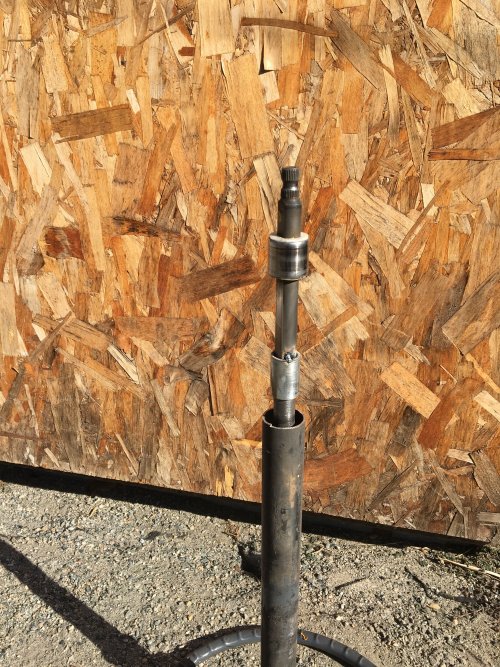

I also started working on marrying the two steering columns together. I got lucky, really lucky and both columns had an O.D. of 19mm so i found a sleeve with a 19mm I.D. and cut the columns to length welded them together and used the lower half of the 4runner column cover to clean everything up and offer a second mounting point. I will make a bracket for that when i am sorting out the floor and other interior metal work.
We have steering! And brakes! and kind of a clutch...
I also got the Brake Master, and Clutch master cylinders bolted in and connected to the associated pedals, although the brakes work great the clutch pedal doesn't offer enough throw to engage the clutch so i will need to cut and weld that to work effectively. I also drilled and mounted the charcoal canister and fuse box, got a much longer positive battery cable to relocate the battery and routed the positive and negative cables to their new location. This inspired me to throw the harness in and make sure everything works, it fired right up like nothing had changed.. a little motivation to keep chopping away at out.

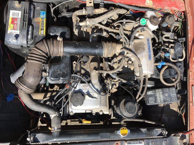

Its been awhile, but I've been doing stuff when i have had a few minutes here and there. I was able to get the clutch pedal sorted out and take the Stout around the block. I immediately got it stuck in the alley and had to switch over to 4hi but it managed to get around the block and try out low range cycle through the gears so i call it a success.
Ive since just been spending my time in the engine bay cleaning things up and sorting things. I had to weld on some new brackets for the radiator since it was in need of upper mounts, I'm not sure if im happy with them since it will require drilling into the bulkhead but we will see. I managed to get a small electric fan on the back of the radiator that also allows clearance for the power steering belt.. Im pretty thrilled about having both power steering and the electric fan on this thing!
Here is how it sits today with plenty more to do but I'm slowly chipping away at it. I've been keeping my eye out for some 40 series steel wheels and some pizza cutters as well as some low back bucket seats that will feel more period appropriate, so if you have something laying around let me know!
