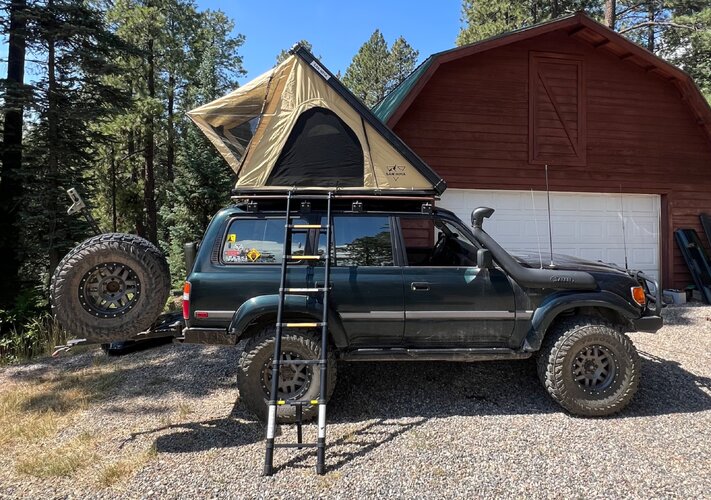

Post Alaska trip in the LC-250 I’ve moved the RTT over to the 80. This is probably where it will stay and part of the reason I choose this tent. It fits on my rack very nicely. As the 80 basically a solo mission trip rig at this point the small tent will be sufficient. This saves me about 100lbs over my larger Eezi_Awn. If Bridger and I go somewhere together in the 80 there is a good chance the Trailer will come also.
Here is the product link again. https://www.sanhima.com/collections/rooftop-tent
When funds allow I think an adhesive backed solar panel would be a perfect addition to the top. Both for extended camping and as a trickle charger while parked.
Best I could do for an interior shot.

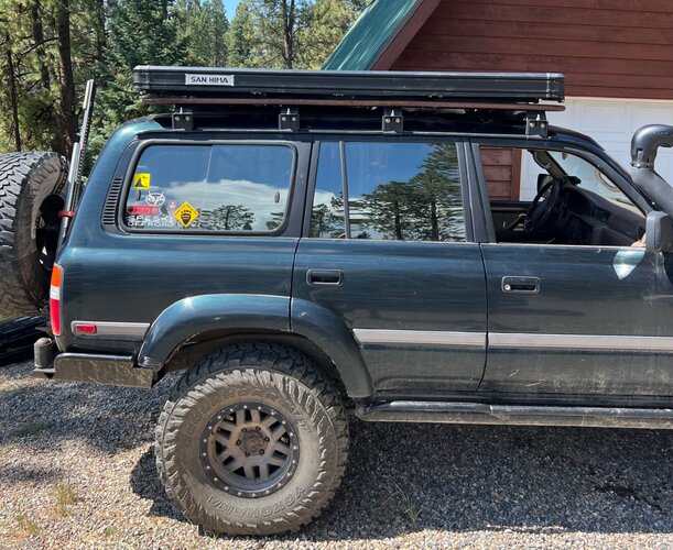

10,215
Follow-up to the Sanhima tent. Just pulled the crappy foam mattress out and placed my Exped mattress, a king size pillow, a wool blanket and my 5-degree down sleeping back inside and was able to close without much issue. Upcoming trip will be the first time I sleep in it. I'm pretty confident I'll need to find a wider inflatable mattress as this tent is pretty short and to sleep on my back I probably need to go diagonal.
