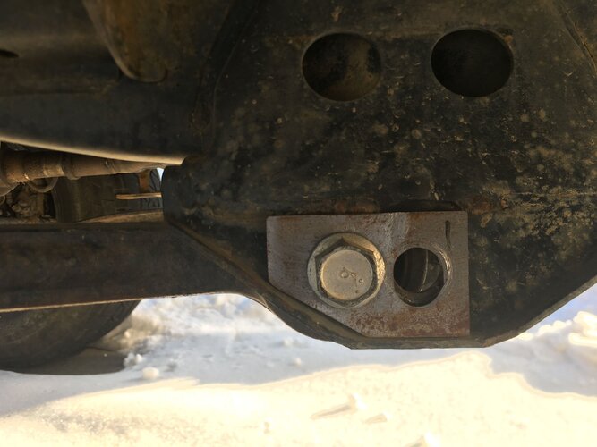

Here’s what I did. Eventually it will be welded in.

You can fit those 37's without moving the axle. A tiny bit of precise cutting goes a long way!

I like that, Jackson....washer mod on the rear of the control arm! Reminds me that I still need to correct my castor this year with washers at the rear side of the axle. I did the front, but its not quite enough castor...truck is all over the place. It was perfect for my OME lift, but not enough for my SLEE 4".
