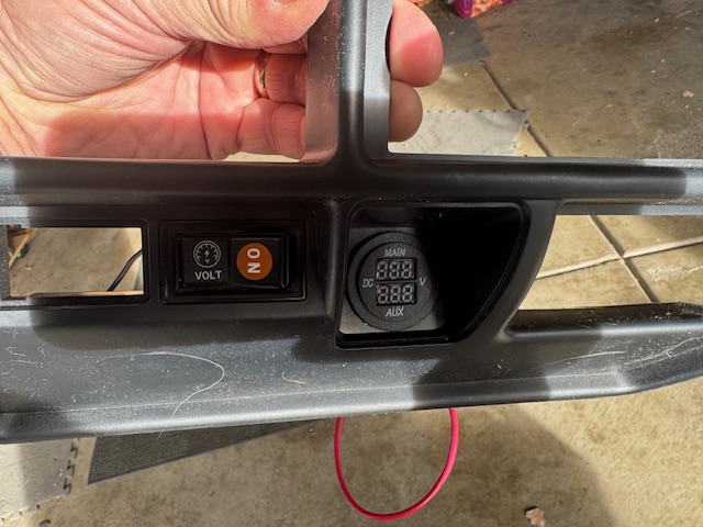

I have an old defroster switch that I want to repurpose to toggle on/off a dual battery monitor. I put a "volt" sticker on it from my Aux Beam stuff to make it look fancy... going for a setup that looks like this:

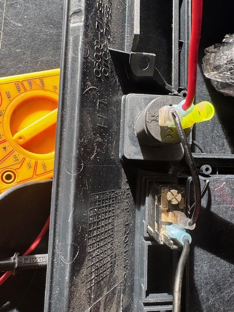

So I'll run + wires from each battery into the back of the voltage display, then run the shared negative through the switch. Simple enough right? I've done this before, but not with a Toyota switch... here's what the back of the switch looks like:

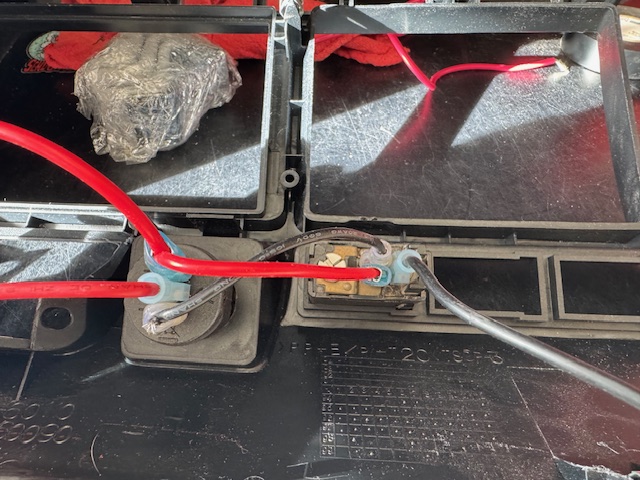

Zoomed out... do I have this set up right?
My next step is just hook it up to a battery and try it... but thinking someone here has already done this. I don't really care if the light in the switch lights up, and only running negative through it I kinda think that's not an option anyway. I'll know it's on by the volt meter 4" to the right being lit up, right?

Ok so according to my multi meter, this is the configuration that makes the switch work...
which means that other terminal must be for the light. So if I jumper one of the + wires over there, think that'll make the light on the switch turn on?

Forgot to mention - I use the same old switch from my FJ60 as part of my driving light circuit. My driving lights are set to come on with the highbeams using the Slee aux harness. If I want just stock highbeams I can interrupt the circuit with this same switch. And it reminds me of my 60.
