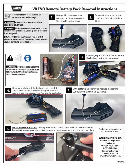

You could do it like Warn suggest in their Evo remote recall document. Looks to basically make it a wired-only remote. Is that a possibility with ComeOn?

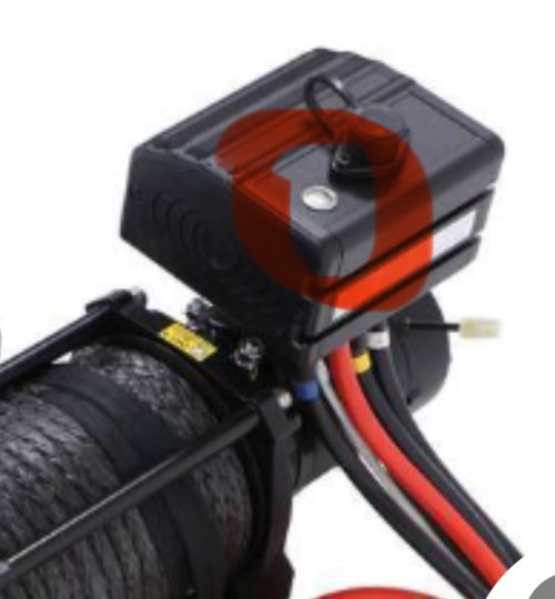

Newer (last 4 years or so) Comeup seal solenoids have an on off button.
