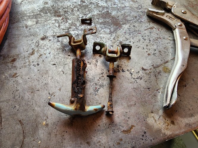

Pulled windshield hooks off one of the parts rigs and replaced the crusty ones on the 25
