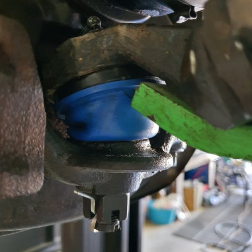

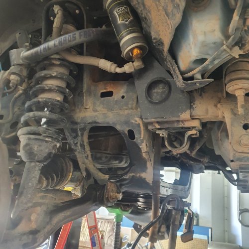

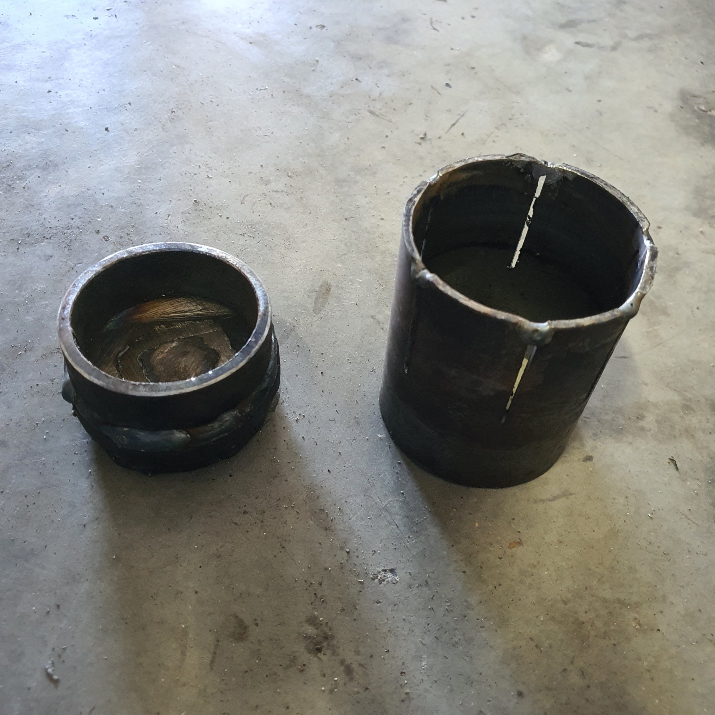

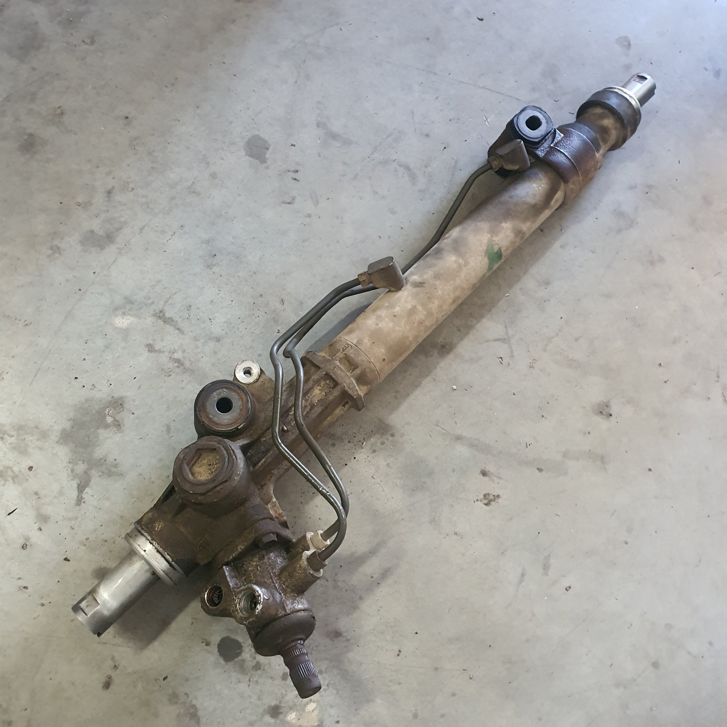

New rack, lbj's and tie rod ends on the GX...
The lbj's proved to be an exercise in patience as well as a lot of heat and beat. Had to fabricate my own adapters for the ball joint press as the ones in the kit will not work...

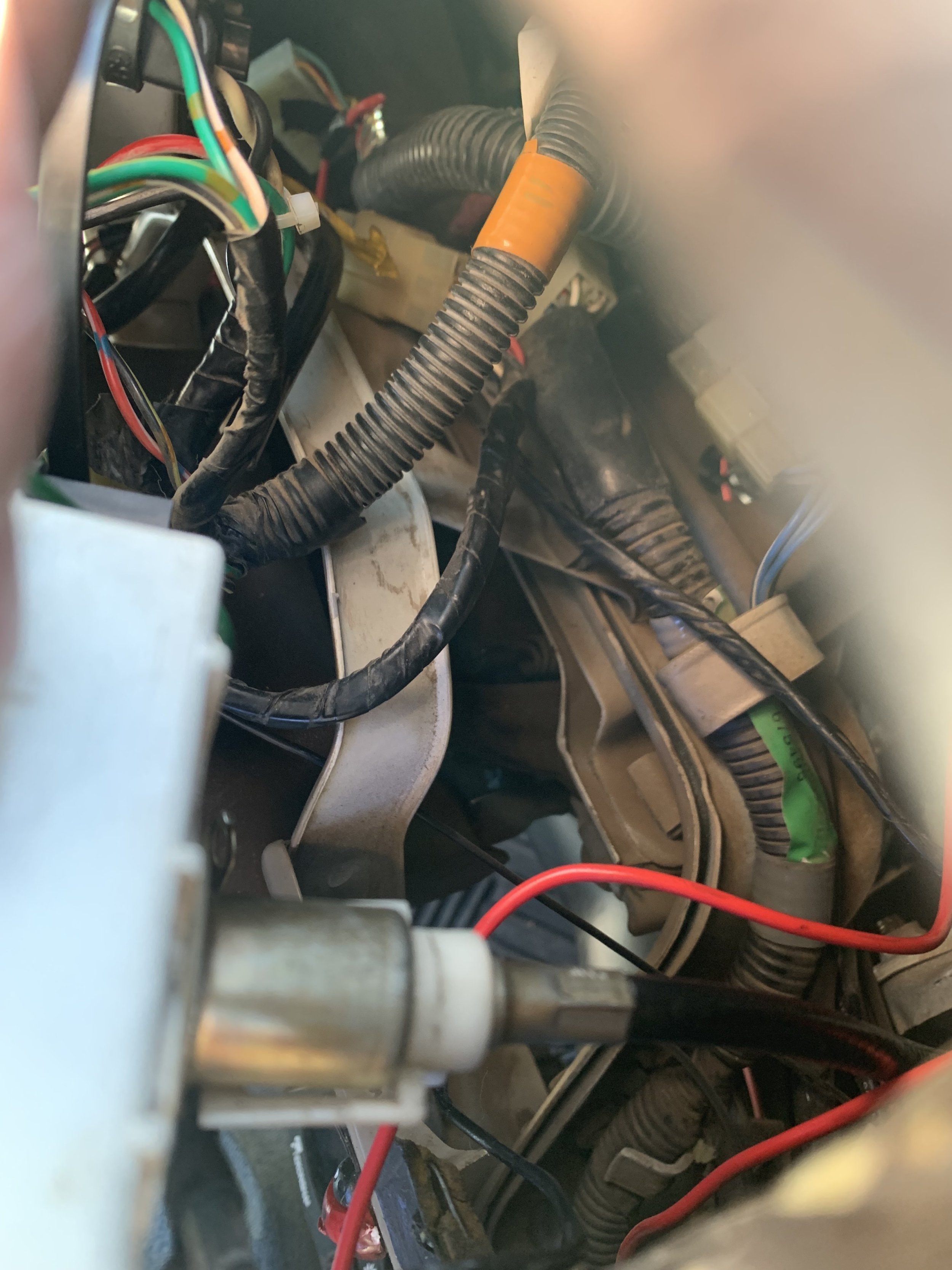

Tried to replace the clutch pedal torsion spring bushings on my 3rd gen 4runner. Spent 40 minutes trying to get the last leg of the spring back in its hole working in the cramped footwell. Look down at the carpet and realized that at some point I broke the bushing off that was the exact thing I needed to replace in the first place. Going to call the dealership tomorrow and see if they have the 4cyl clutch pedal linear spring and do this mod. I was stubborn and wanted to stay OEM but not go through the trouble of removing the pedal assembly which is fairly involved. I might switch back to the torsion spring if I ever have to replace the bushing in the pivot for the pedal itself as that more obviously requires removal of the assembly (will probably just replace the master cylinder at that point too anyway). At least the spring and it's tab on the pedal are still in perfect shape if I ever decide to do this.

Update: Ended up driving it around a bit yesterday with the spring completely gone (originally the plan was to head down 3 miles to Hazard Fraught to grab some velcro ties for my 4way air up/down setup) only to realize that I really like the clutch feel with no spring at all. I feel like my shifting, especially from 1st to 2nd, is way smoother without the stiffness that spring gives right around the engagement point on my clutch. Would have never found this out had I not broken that bushing so ultimately my $20 in bushings wasn't wasted completely lol.

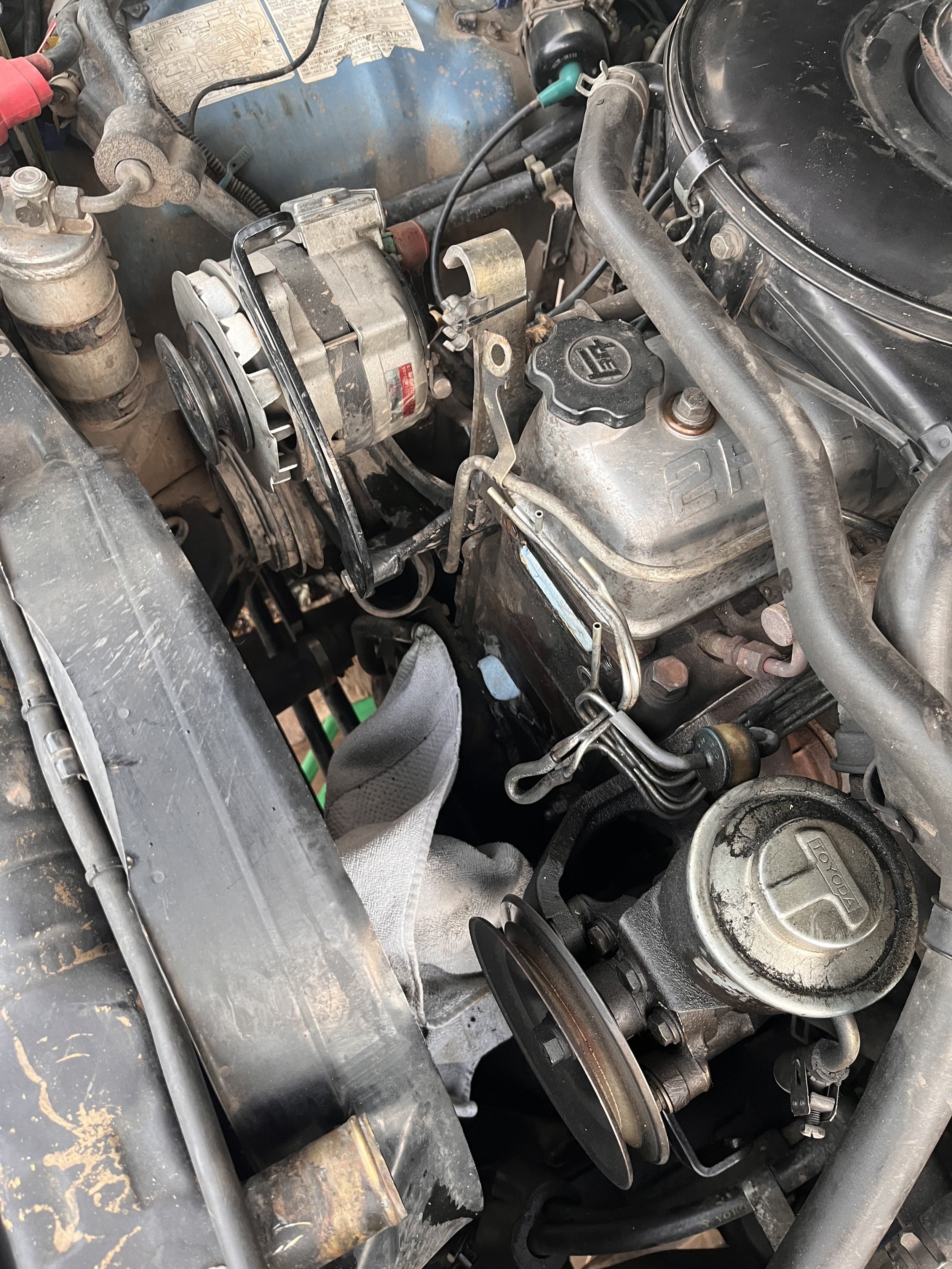

Why did nobody warn me that replacing the water pump on a 60 was a total nightmare??
Did that this weekend as part of a total cooling system overhaul with mostly new hoses, thermostat, fan clutch, and double flushing the heater cores engine block and radiator separately.
Seriously though, that WP and the two lower hoses - it all has to get fit at one time, with hose clamps dangling off the hoses, trying to slip off - is a nightmare. 4.5 hours for that alone yesterday. Maybe it was more of a pain since I left the alternator, AC compressor, and fan shroud in place. Oh, and the radiator drain plug housing (not the plastic plug) pulled out of the radiator. Here’s hoping last night’s JB Weld in the dark holds that. Got all the main bits back together last night though. This afternoon will be a final flush on the block, and then filling the system.
I’m writing this from a Lyft on the way to work because I’m not done yet haha.

It appears that the water pump I removed was probably original. 130,000 miles of service over 41 years. It was still functioning just fine, but I overhauled the cooling system as part of my baselining. The thermostat upper gasket was busted, so I was seeing 150*F temps on both of my gauges ... and that turned into major scope creep: replace the thermostat, thermostat housing, water pump, and all the front, hard-to-reach hoses.
So no complaints that the old one went this far. It was time to replace it though - no sense in waiting for it to fail out on a trail far from home.
