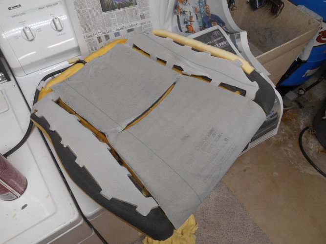

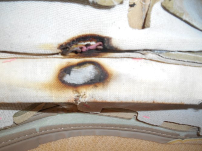

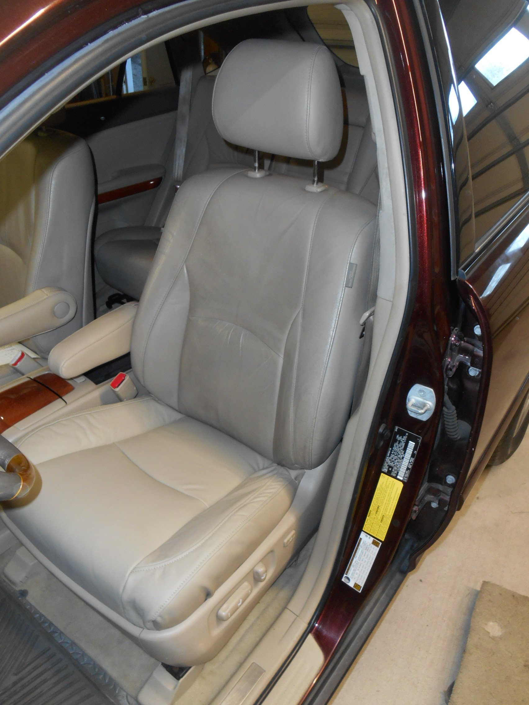

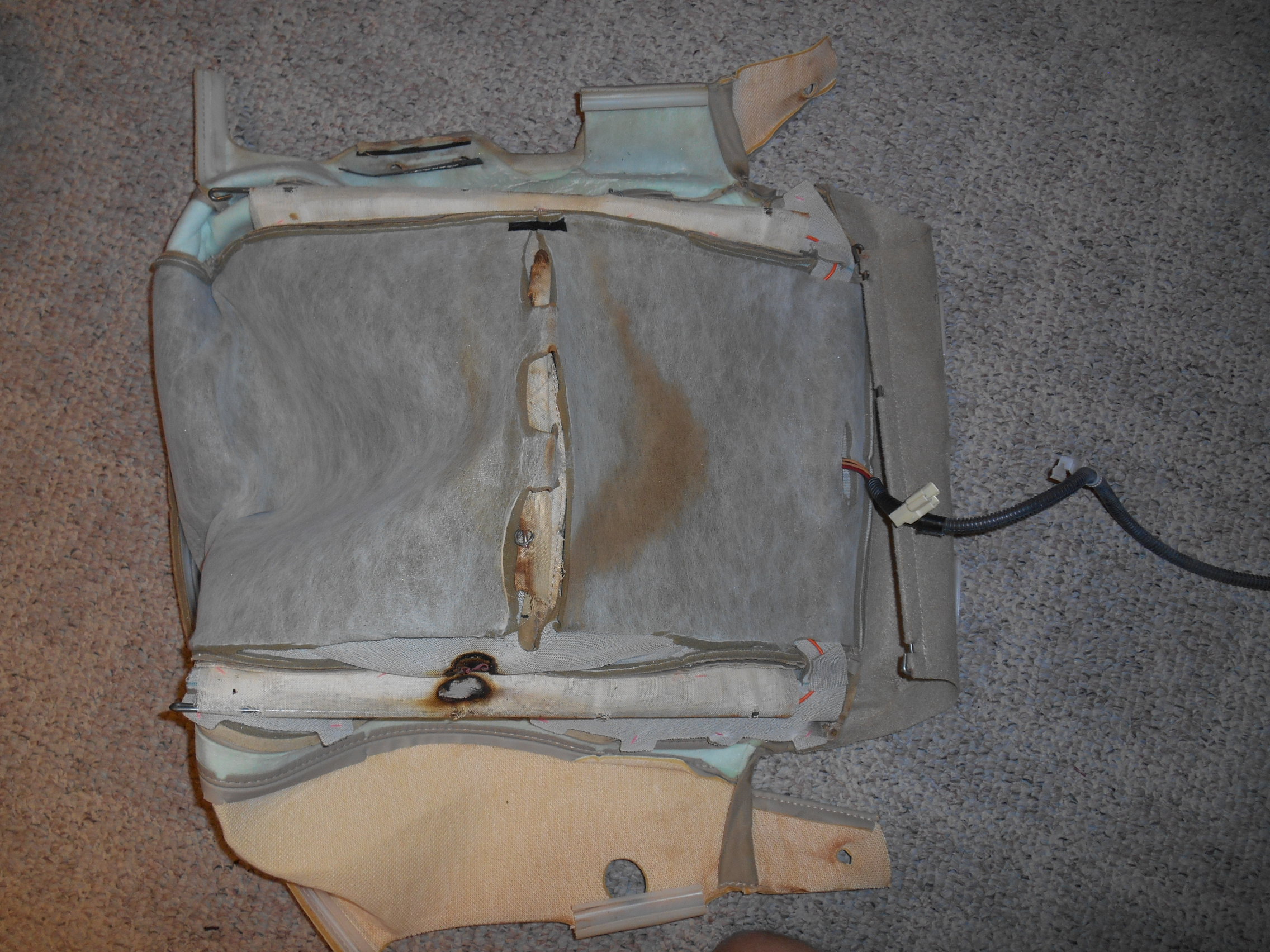

My 'rig' at the moment is an '09 RX 350 I bought for my daughter. She commissioned me to find a replacement vehicle for her, since I'm a 'car guy'. Been doing lots of catch-up PM and detailing.
The seat heater (driver's) did not work. After extensive troubleshooting, I found that the heater element in the bottom pad shorted and burned through. I bought a junkyard seat, cut off the heater pad (sewn to the seat bottom leather) and swapped it into my seat, with a new eBay leather seat bottom cover. The seat now heats, is comfy, and looks better.
Way too much time and hours, but that's what fathers do for their kids...

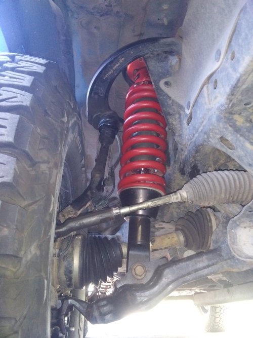

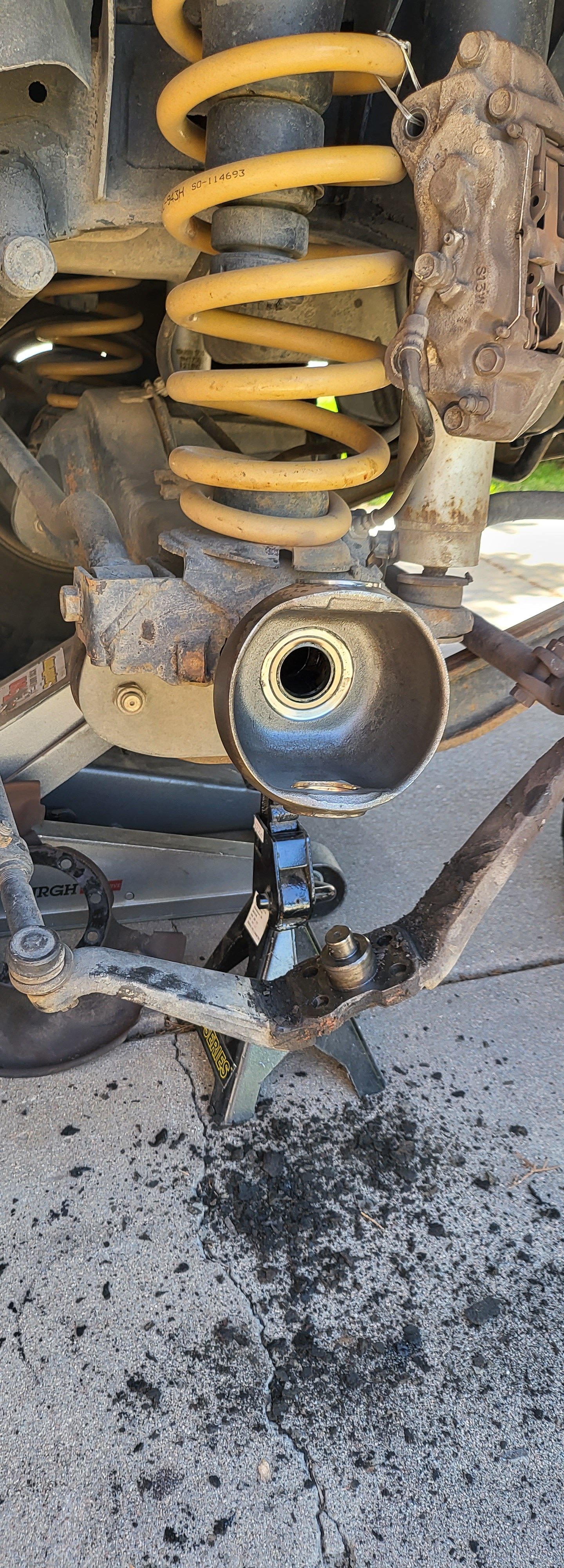

Replaced Lower ball joints and front diff output needle bearing with solid sleeve from ECGS on the Taco. Chasing a mystery clunk and throwing parts at it. Old LBJs were Moog loaded control arms installed 10k ago and had some excessive play. Due to cost point and availability, Moog problem-havers were installed again. (Forgive me @DaveInDenver ) I guess this means I have another 10k to save up for aftermarket LCAs.😛
cleaned up some related parts and replaced a worn tie rod with a less worn tie rod. Sadly, still chasing that clunk.😕

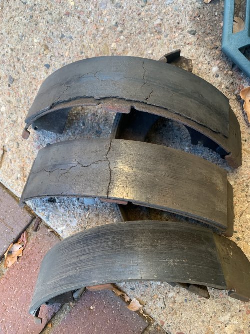

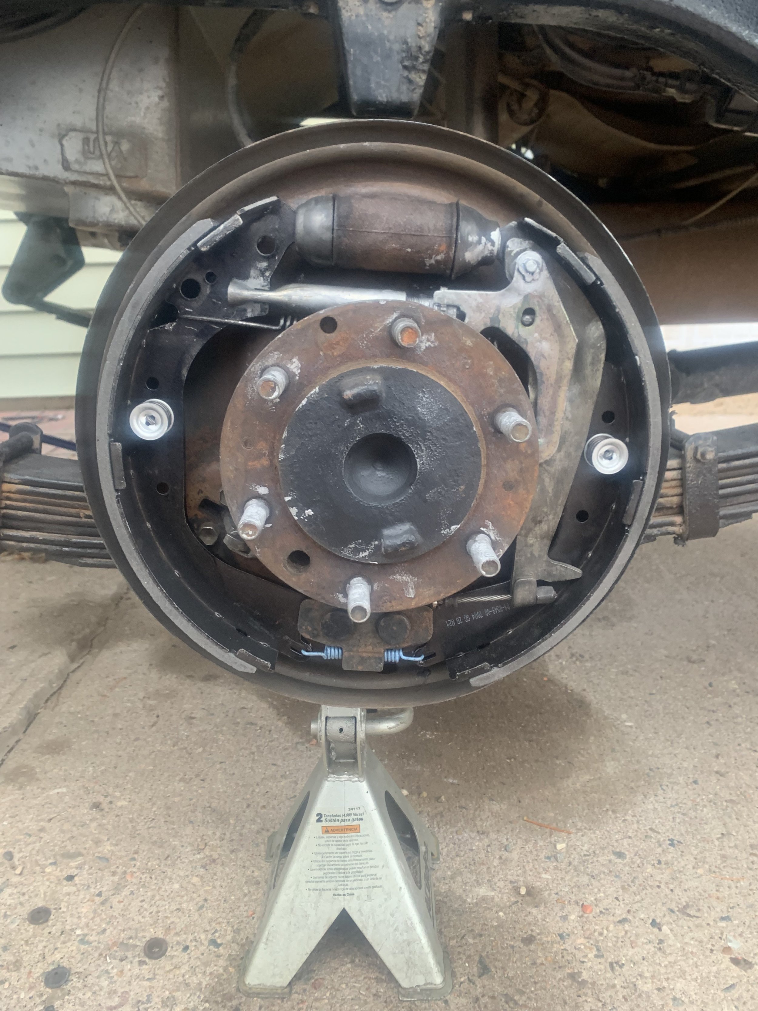

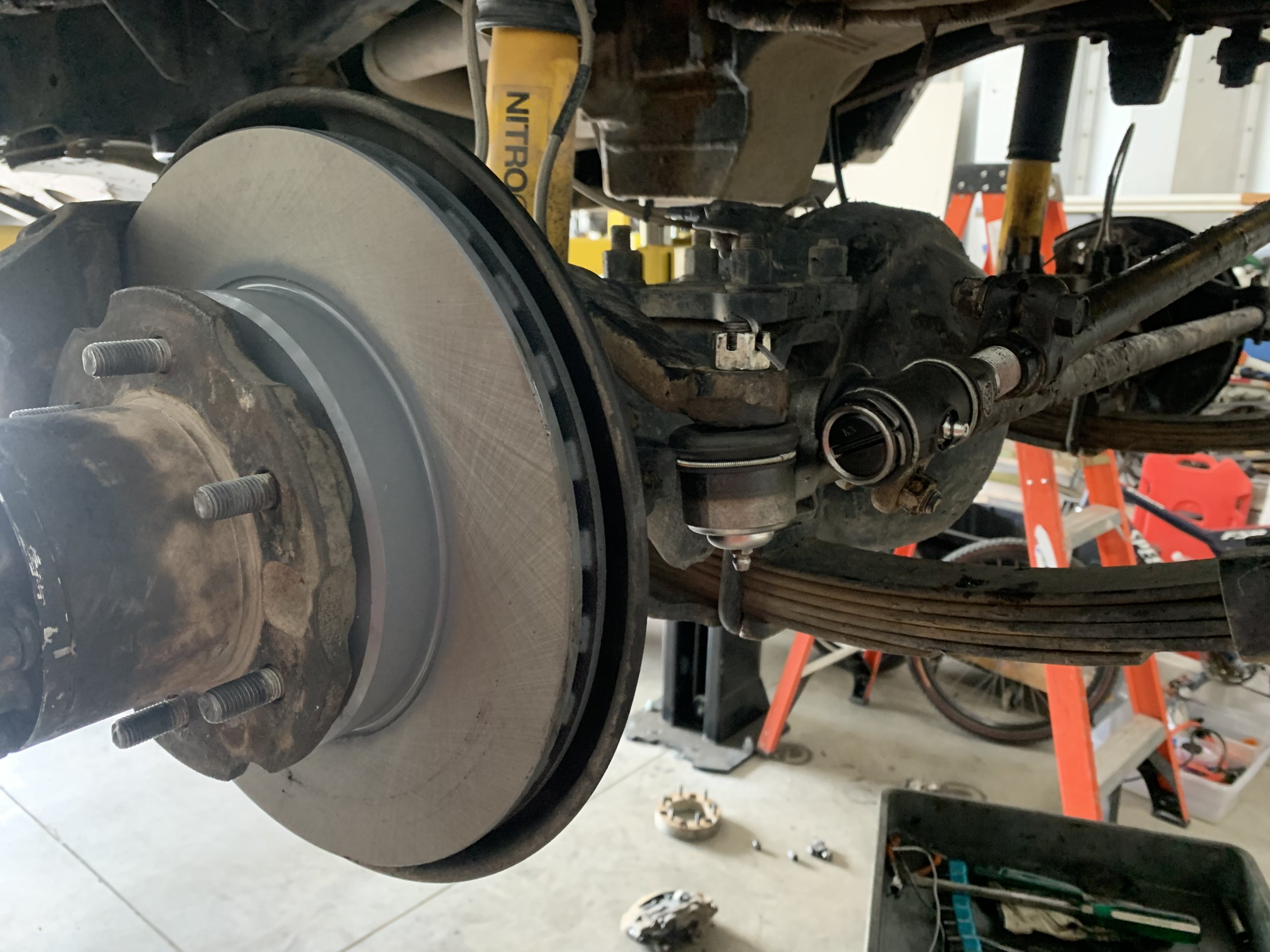

So, back in Nov I changed rear brake Pads, kind of glad I did. Had a really bad wobble between 38-45 mph, just prior to CM -22 ( towing a camper going over and down passes BP issues). Yesterday, by expertise of @PhatFJ, threw couple things at it. New tie rod ends all around, added zirks to bottom ends. Changed to new rotors, brake pads, bearings and set preload. Has made a World of difference so far. Ok, got to change steering wheel from 11:00 to 12:00. So far I’m really happy, little more time and braking in pads will tell.

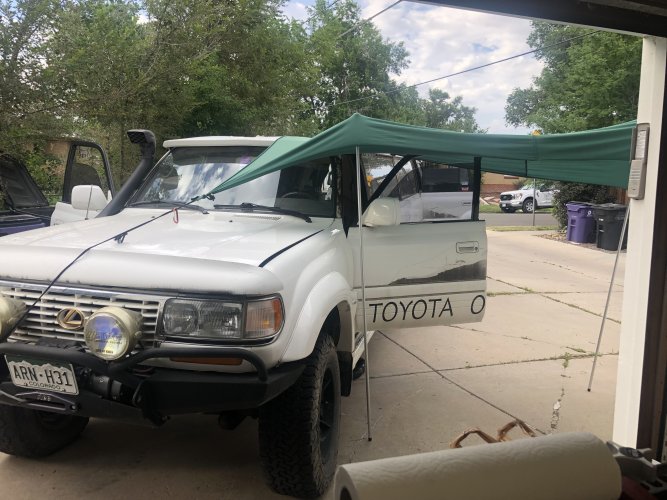

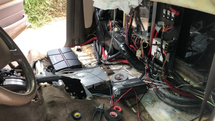

Long Cruiser is getting prepped to drive to Seattle.
Greased 10 driveshaft zerks
Lowered three carrier bearings to inspect. All good. Reattached.
New cap and rotor. Was already smooth. Now smoother.
New stop lamp switch (brakes). Cruise control works now.
Replaced all accessible vacuum hoses.
Replaced hoses to evap canister.
New head unit ($117 at Amazon!) and cleaned up miscellaneous wiring.
Secured a few things in the engine compartment that were bouncing around.
Ordered new seat covers. I was fine with the leopard print but Anna wanted a different aesthetic....
Air in tires (they use a lot of air!)

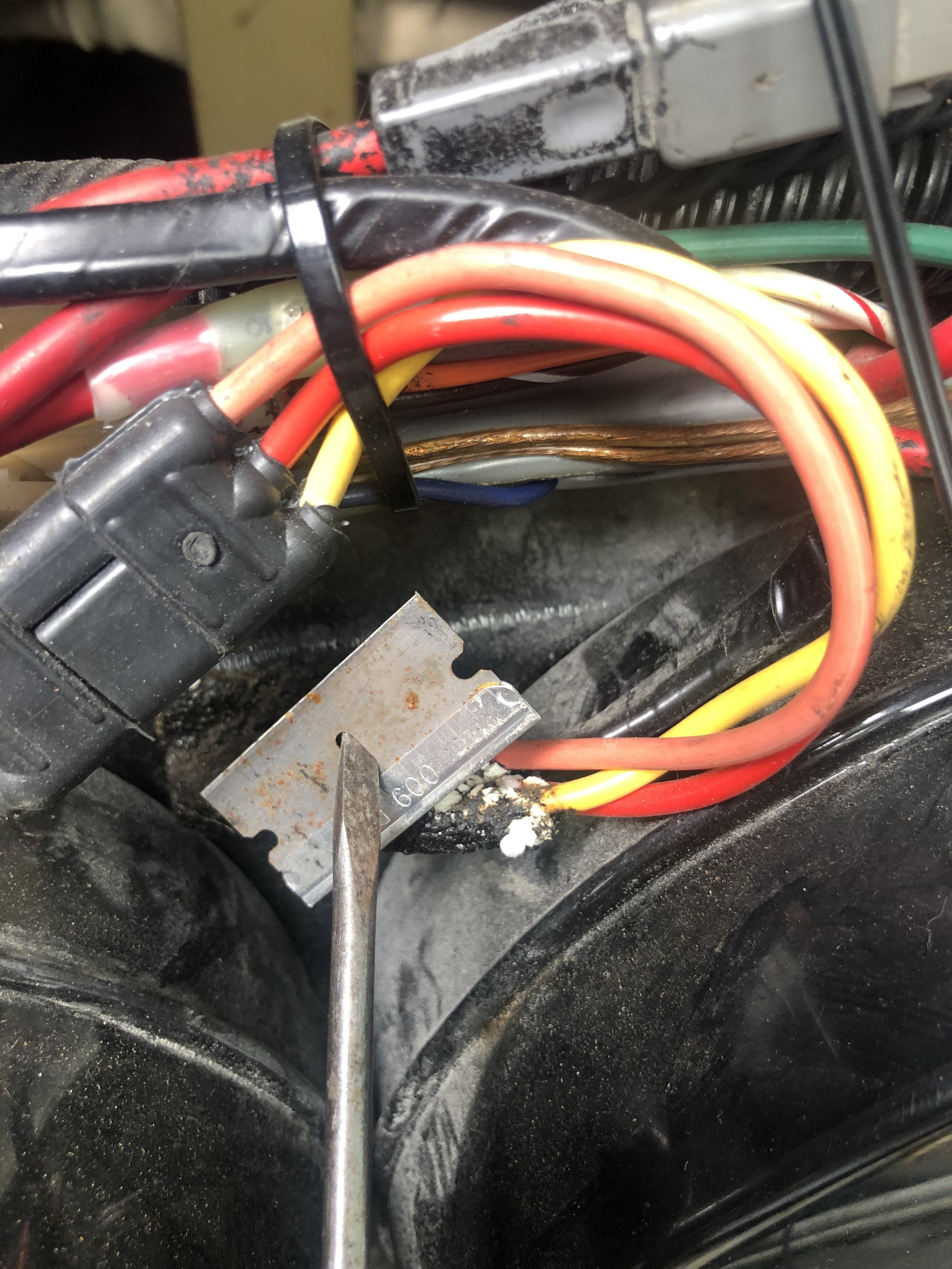

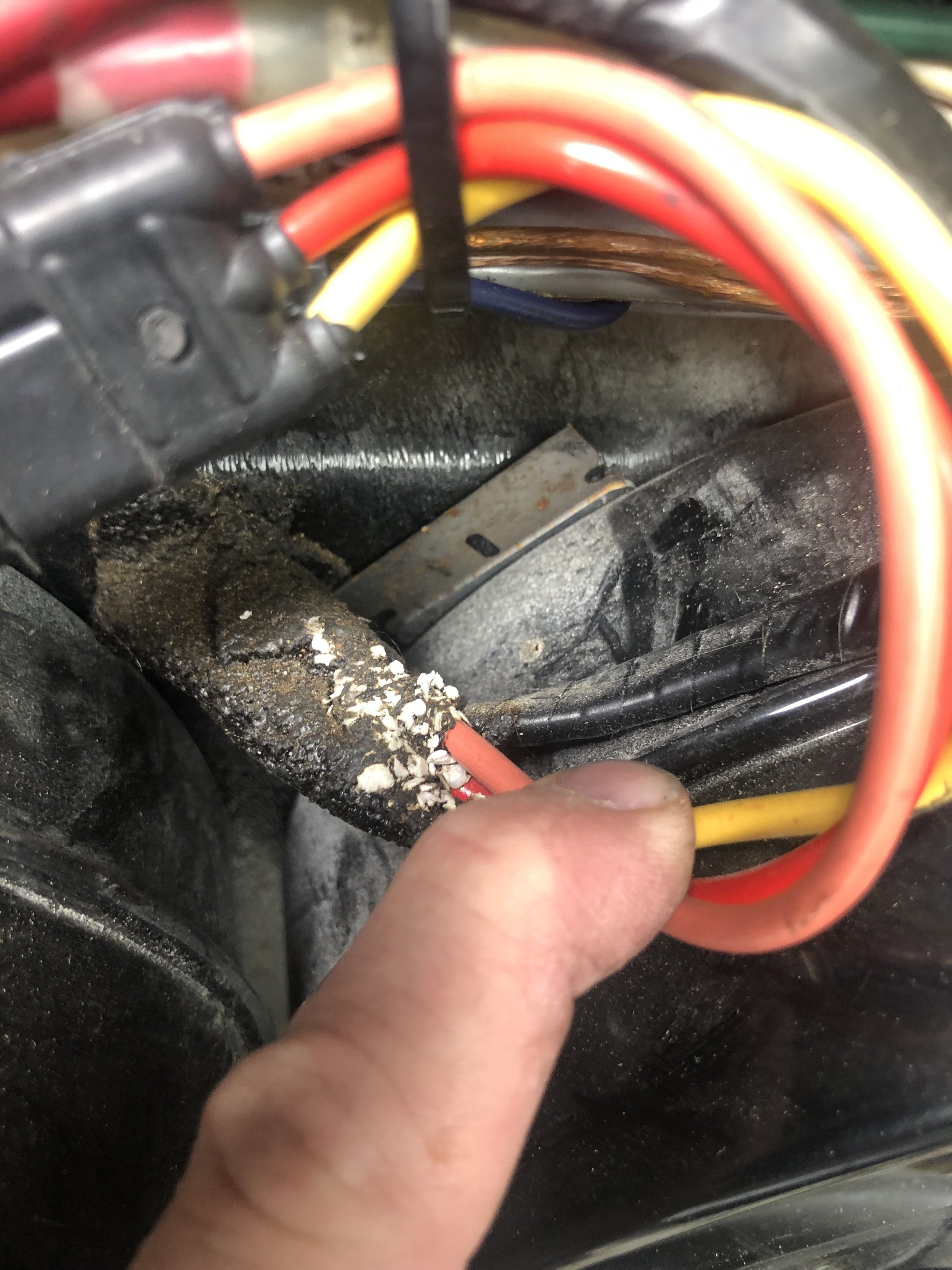

Pro tip: Do not stick your hand in dark places. Luckily here I did not:

@Inukshuk what head unit did you go with? I've been looking for a low cost upgrade now that my hillbilly Bluetooth setup with a tape deck and adapter has finally died.
Amazon product ASIN B01IBWDF1OSo far, so good. The "brake trigger" to view video goes to ground, FYI.
This one looks almost the same, seems to have a front "aux" input.
Paired with cheap amp ($118) so the amp runs the rear 4 speakers and the head unit runs the two front speakers.
I kept the existing speakers. They seem decent, probably 15 years old and a hard life. LOL
