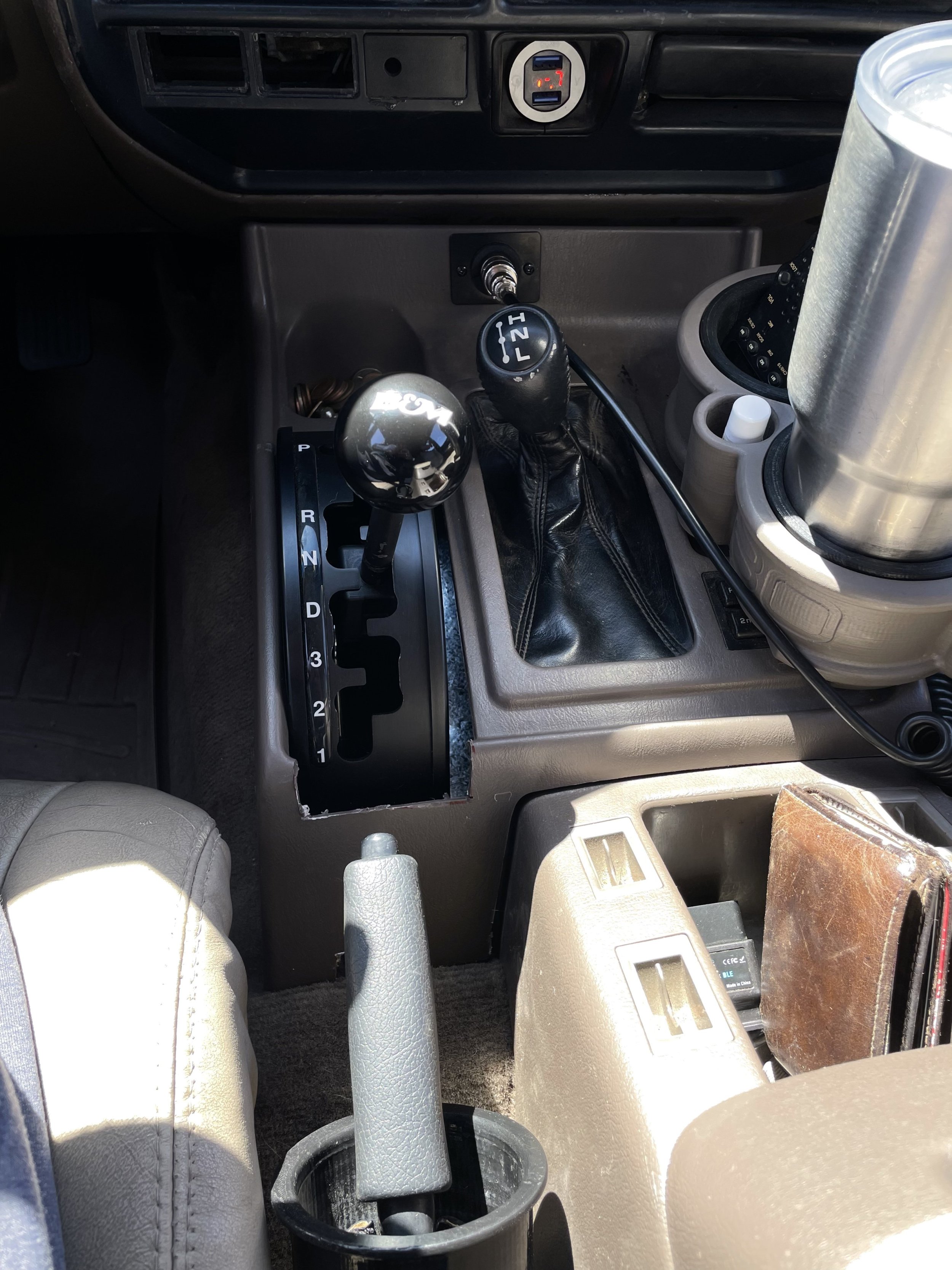

Installing this tonight. Tired of the sloppy Frankensteined stock shifter shifter w/ a trailblazer shift cable.

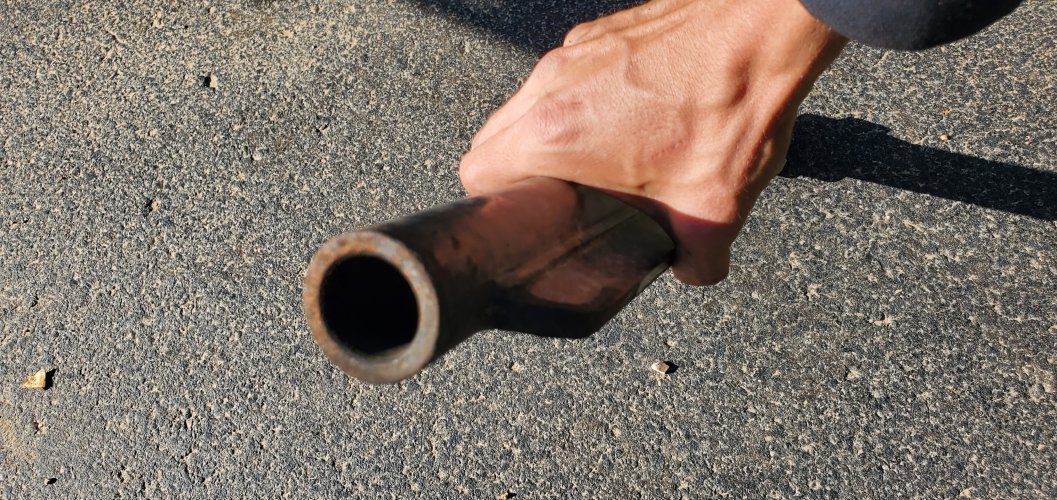

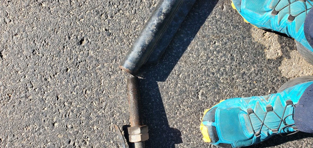

2022/07/08
Driver window run
Front pass tire
Straightened steering wheel with relay rod
Removed lots of decals (Anna did)
Painted sides
Added LongCruiser decal to sides
Hooked up vanity mirror lights

Install of shifter done. Very happy w/ it so far.
Tomorrow I’m going to install a 10” fan in the trans cooler w/ some brackets that @DomOfTheDead made up for me. Nut and bolt check, and top off fluids. Off to Black Hills Wednesday!

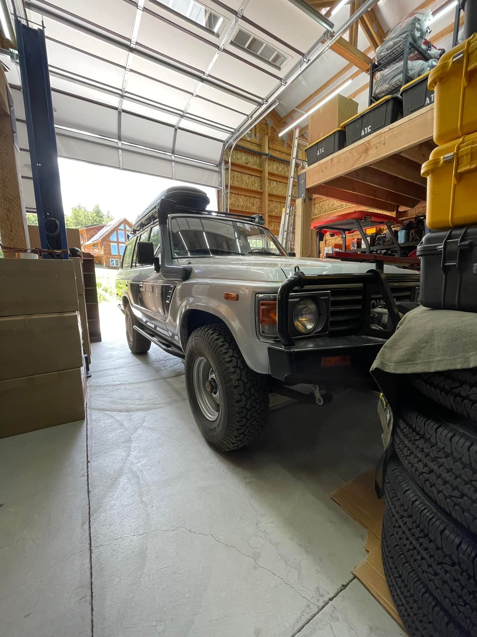

Finally got mine into the shop to assess a valve adjustment and carb swap. Also, trying to figure out options of camperizing the back. What have others done with the rear of the 60's to reduce weight, clutter and just make it a "grab and go" camping rig?

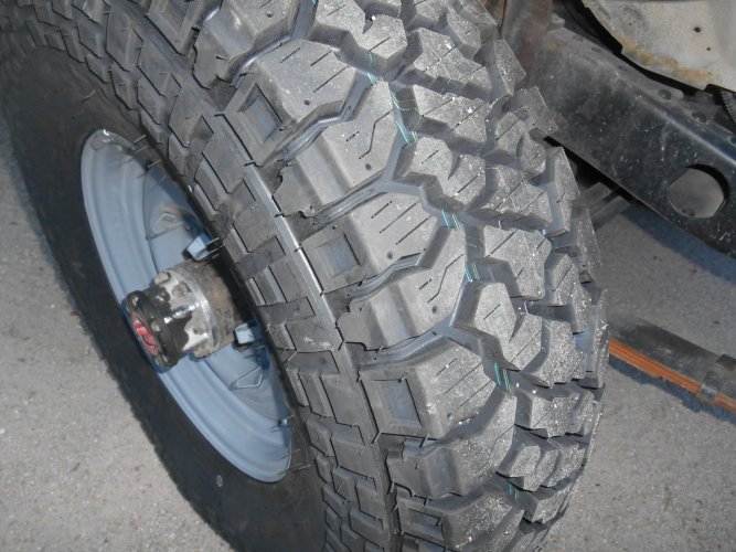

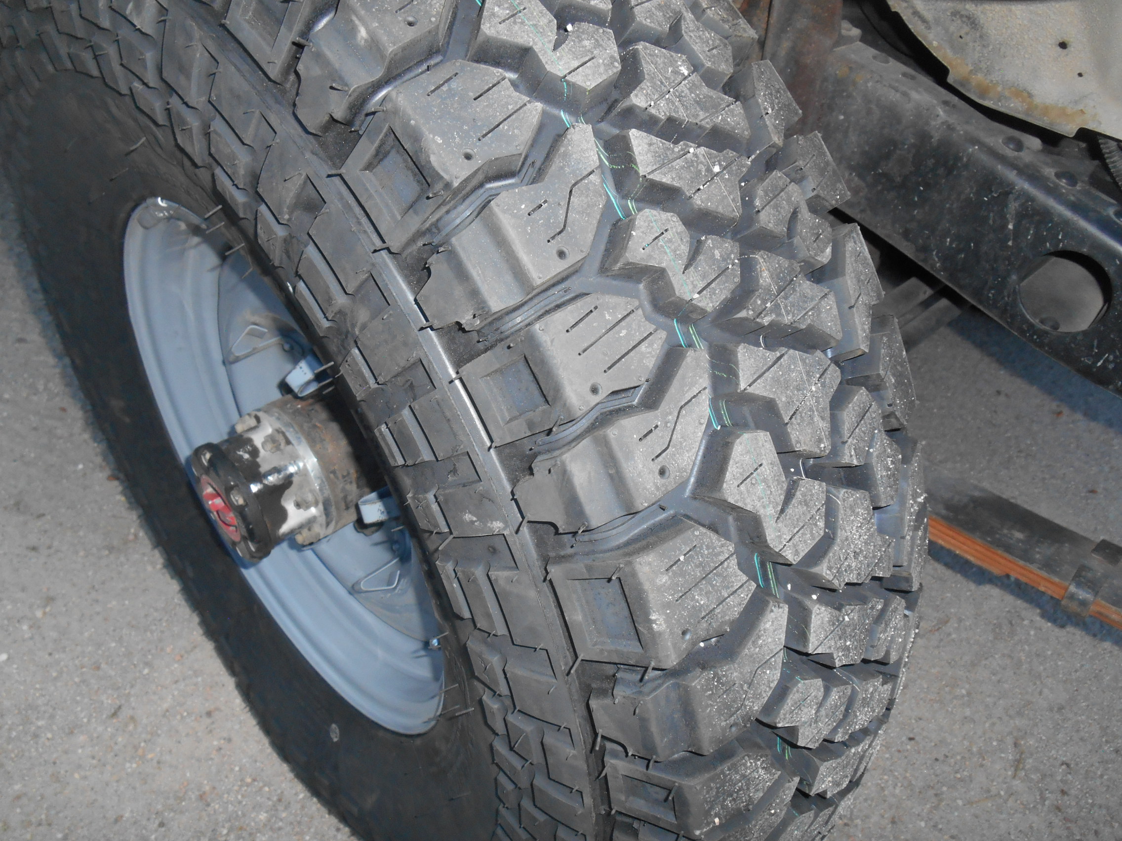

I had a local tire shop install the Walmart-online-sourced Kenda Klever 33x9.5s on my FJ40 rims yesterday. Each tire took half as much balance weight of the old BFGs - just an ounce +/- per tire.
They are smooth at 70 mph, seem to have great traction and ride well. I put 29 psi in them, since that is plenty for a stock FJ40.

Great to hear. Still love mine on my 80

Tell me more about this smooth 70mph in a 40

It’s been a little over a year, right Daniel? I would wager you put your tires through more miles and more diverse conditions than most people so it’s good to hear they are working out well for you.
8,647
Since the 2020 Baja 1000. Used heavily!

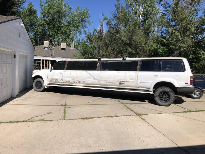

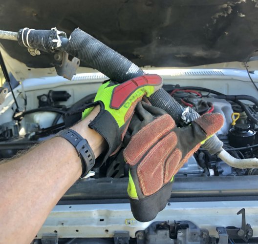

Saturday July 9:
1) 98 degrees out. Start LongCruiser drive to Seattle.
2) 98 degrees out. Have R134 dump out somewhere in the LongCruiser AC lines in the engine compartment just as fast as you can put it in.
3) 98 degrees out. Start calling club members who tend to have parts.
4) 98 degrees out. Park under a shade tree at @Notyourmomslx450.
5) 98 degrees out. Cooler in shade. Remove T on low pressure side and install a stock line from Andy. Remove T on high pressure side and reconnect lines with new o-ring.
6) 98 degrees out. Cooler in shade. Add R134. No hiss.
7) 98 degrees out. Cooler in shade. Take three Jordans for ice cream LongCruiser ride and test run.
8) 98 degrees out. Cooler in shade. Cooled in Baskin Robbins. Eat Ice Cream.
9) 98 degrees out. Cooler in shade. Cooled by Baskin Robbins. Drive Jordans home.
10) 61 degrees out. Type this message from Seattle. Drove here in LongCruiser through temps as high as 99 degrees with A/C on bast the whole way.
:bowdown::risingsun Thanks this time to @Notyourmomslx450 and @NotyourmomsWife
11) It will be in the 70's Saturday July 16 when I drive my nephew and his groomsmen to his wedding in LongCruiser.
If you read this far, I may have shed a tear writing this.
