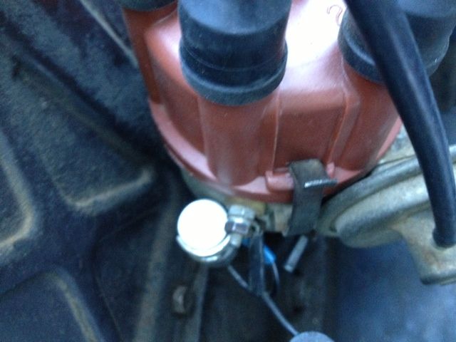

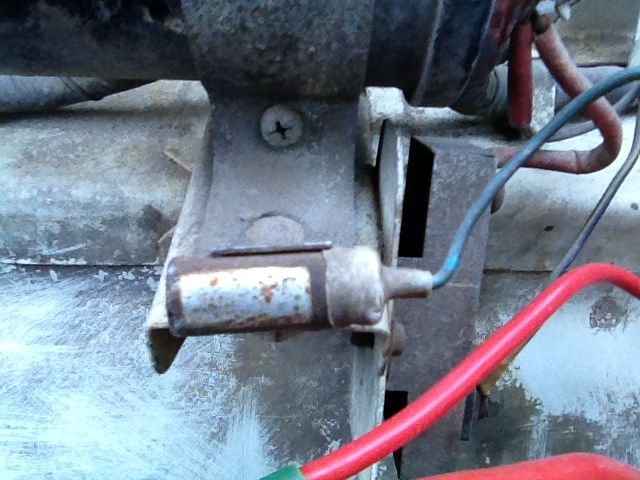

I believe this is a condensor at the coil:
... and this is a condenser at the distributor...
The distributor condenser is as I would expect it, but the one at the coil looks to be redundant (though it may be the other way around). The condenser is eliminated with the electronic points so it's fairly moot, but for my own betterment I want to make sure I'm not going crazy.

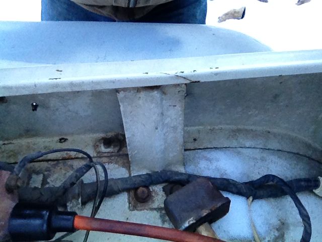

There's also the question of this little guy:
I've looked through all of the wiring diagrams I can get my hands on, and through the various manuals and I'm really not convinced I know what this is. I THINK it's the ballast resistor, which would also be eliminated with the Pertronix setup, but a little assurance would be helpful.

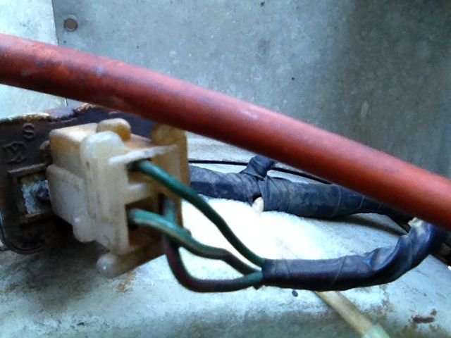

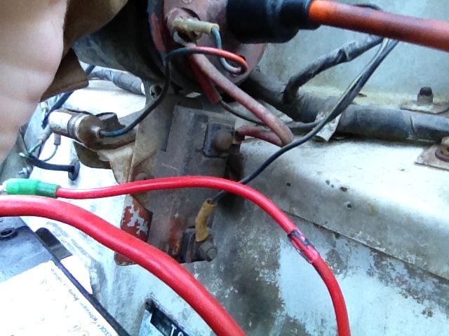

Finally there's the question of this guy....
It's in context with the ignition pieces, and right alongside them in the harness, but again I'm not seeing anything about it in any schematics or manuals... There are two green/yellow wires and a green/red wire... I might be blind, but this is giving me pause.

Just in case anyone comes by later, the answer to the ignition system identification questions are that the condensers are both condensers and redundant. I imagine the distributor condenser was installed alongside a set of points sometime in the not too distant past.
The third photo is the ballast resistor and is optionally removed with the install of the Pertronix setup (instructions are included).
The part in the last two photos is the horn relay. A quick glance at a wiring diagram more or less confirms the wire colors. A quicker glance at the horn relay diagram on SOR's website furthers my conviction. Some poking with a multimeter would further confirm if I weren't convinced enough, but it's cold out there...
