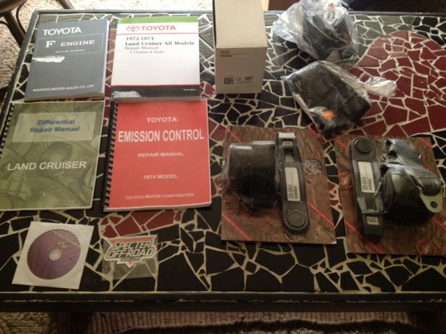

First piece of the parts order puzzle has arrived. Unfortunately, there's not much I can do with this half until the other half arrives save study the manuals. Definitely nice to have all of the printed manuals in front of me, definitely annoying that SOR felt the need to put cheap non-removable stickers on the covers of my brand new manuals AND have the nerve to charge such a premium...

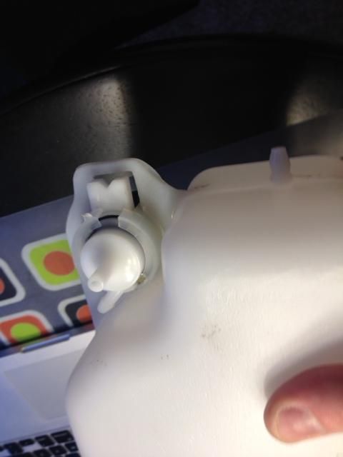

I looked through my SOR goodies again and looked on SOR's website. Nothing about how this pump is supposed to be hooked up. I googled it and ended up on CCOT's site, and they have a scan of a copy of a copy of a copy of the installation instructions for the same kit. It's ALMOST mostly legible, but the part I need clarification on is completely useless. I called SOR, and they have no idea either (no one's ever asked...). So am I an idiot here?
I have to be honest, I've never dealt with a windshield washer pump... I THINK the nozzle at the bottom of the reservoir feeds to the clocked nozzle on the pump, then the nozzle pointing straight up goes to the sprayers on the hood... Anyone have any insight on this?
Regardless, I'm going to try to use the original one (I got the kit as a spare/insurance), but I have my doubts that it works.

IF (big IF) that's a tiny itsy bitsy centrifugal pump, which it looks like it is, then the suction would be the nozzle "pointing straight up" and the discharge would be the tangential nozzle. Is the motor on the other side of the plastic tab?
Never messed with an aftermarket washer reservoir though, so take that for what it's worth.
