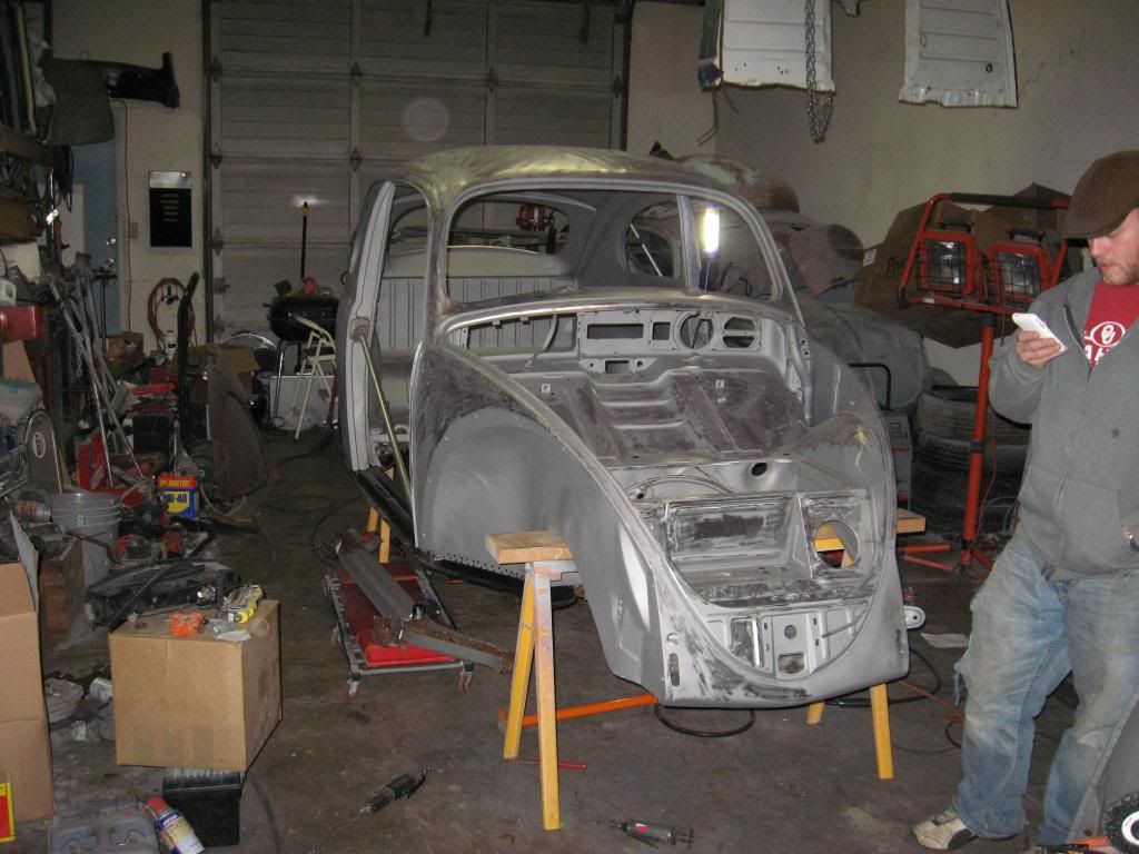

Here's my '58 Beetle (more or less as it sits now).

:thumb: like the pictures of the VWs. We've got some VW fans here in the club. A couple (ex?) Ghia owners too...

The pics are cool BTW. looks like you take good ones, also dig the vw stuff. We have been toying with getting a bug of some flavor for a while now.
