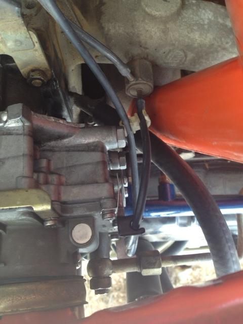

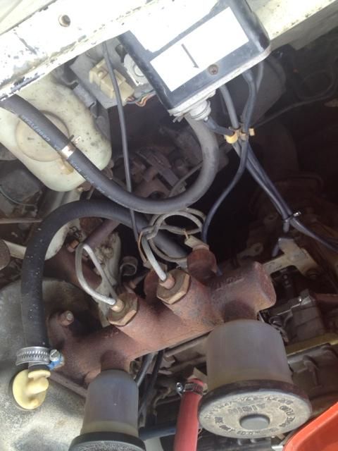

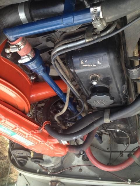

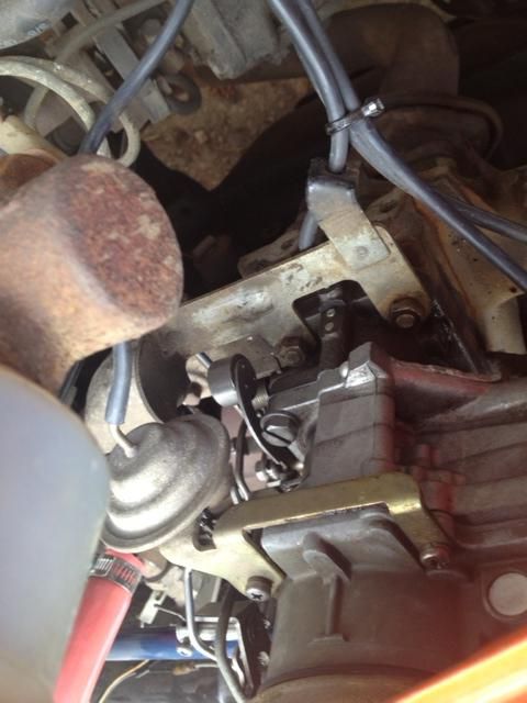

Vacuum line that goes out of frame top right goes to the vacuum diaphragm on the carb (which tested fine by hand while I was rebuilding the carb). The one going to the left of that goes to the carb base. The other two go to the air pump and the distributor advance.
10,637
Yep - nothing obvious from the pictures. And disregard my previous EGR comment - I keep thinking yours is a '75 (dang you Jacket) ;)

As others have indicated, the hissing sound is very likely a vacuum leak. Looking at the photos, you still have the Vacuum Switching Valve (VSV) installed. I don't have any insight on how it should be connected up. If you decide to bypass it; you will need a connection from the carb base to the choke pull off diaphram and then the connection from ported vaccum to the dizzy - everything else (if it exists) on the carb can be capped off.
