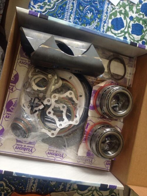

Well this weekend was both a productive and frustrating one. Friday I picked up my diamond. I'm not sure if they got their name from their price, their shape, or their ridiculous strength, but I'm gonna go with all three. This thing is SICK.
Squishy!
Mar 20, 2007
2,711
Littleton, CO
I got the 4th gen housing all welded in and strapped down. The 4th gen is about 3.25" diameter which I had not accounted for. After a long discussion with Brian at FROR, he convinced me 3.5" ubolts would be fine. He provided the plates and I found the bolts I needed at Napa.
I got both housings primed and painted before I stuffed the rear underneath and started working on the front. Got it torn down, parts cleaned and started the swap process.
We didn't have a micrometer that opened beyond 6" so after much frustration and a Harbor Freight employee locking the door in my face we called it a night.
To Be Continued!
