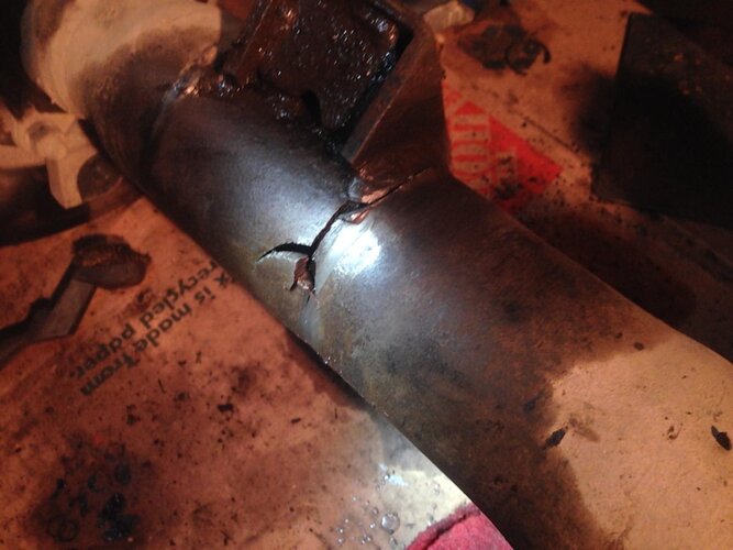

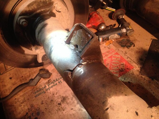

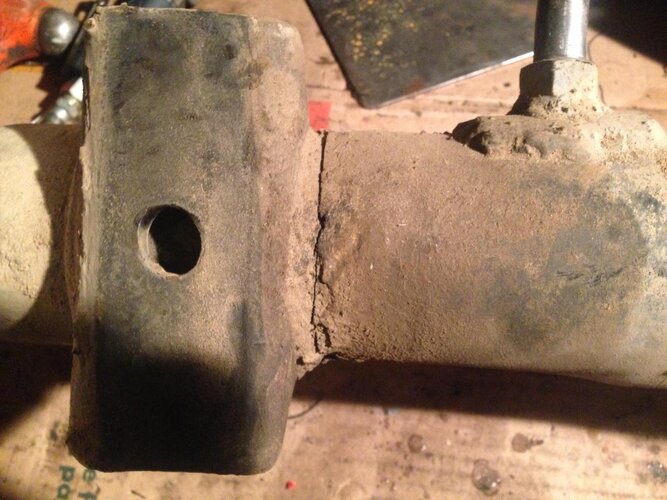

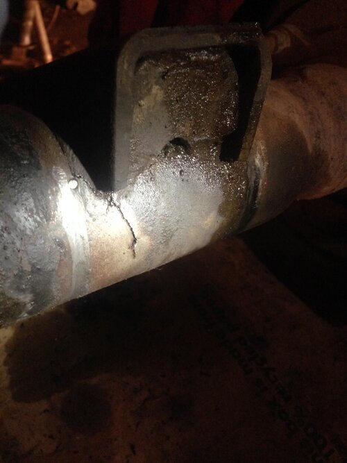

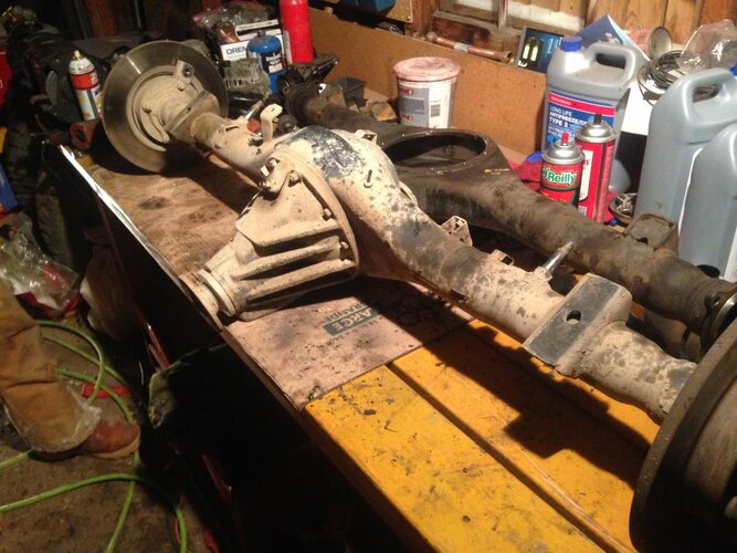

Well I (we :Princess:) decided that while the wide axle mods are the way to, it looks like the budget is holding us back. Isn't it always? Late winter or spring we'll look at getting all that put together.
Anyway, spent $90 at Jim's and picked up a replacement housing. Got the rear assembly pulled tonight and here is the carnage:

On the new housing, have you considered welding tube sections around the spring perches? Essentially halving a tube and making a "cover" for the axle housing that will prevent those types of splits happening on the bottom portion, and then two smaller "half tubes on either side of the perch to prevent the top cracking?
Squishy!
Mar 20, 2007
2,711
Littleton, CO
That's very similar to what my wide housing will have. For now I'm just going to swap it out like for like.

4,223
wow! that's an impressive oops
