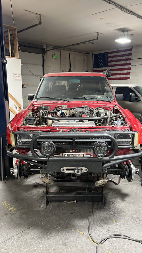

Redid my cockpit some. New switch panel and tidied up the electrical and other odds and ends like new shift boots. So nice.

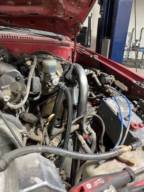

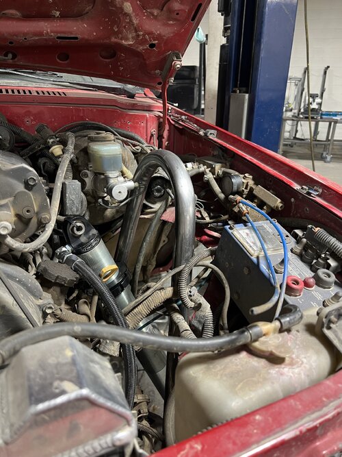

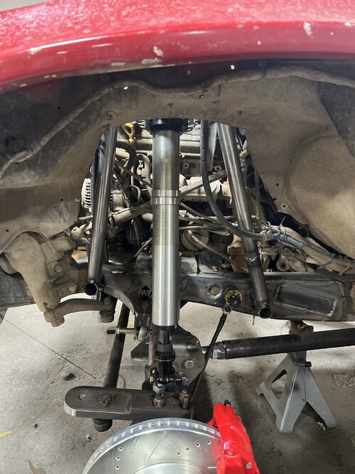

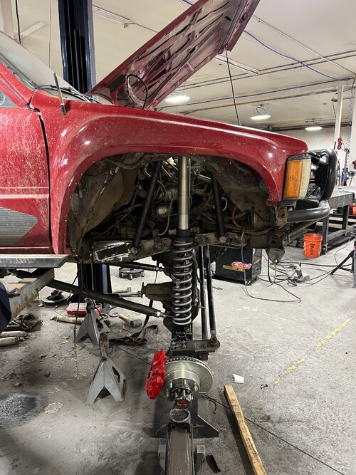

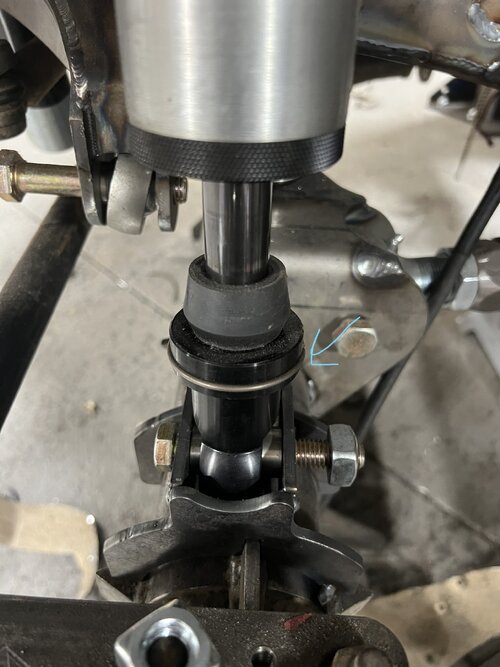

It's been on the lift for over a year at this point and I'm finally making progress thanks to a push from @HoneyBadger and Will. Here are the pictures of progress over the last year. So yea, thanks to those guys and @74fj40 for filling my coilovers today. Hopefully it'll at least be on the ground by Friday.
These are my initial mock-up of coilover hoops. Trying to get 2.5x16" monsters to fit under the hood. 😱

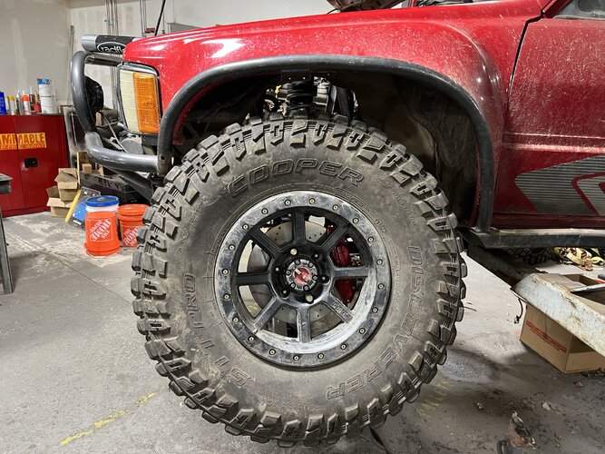

Here is the geometry sorted out and an idea of the flex I'll have. The 37's are going to STUFF in the monster fenders I have.

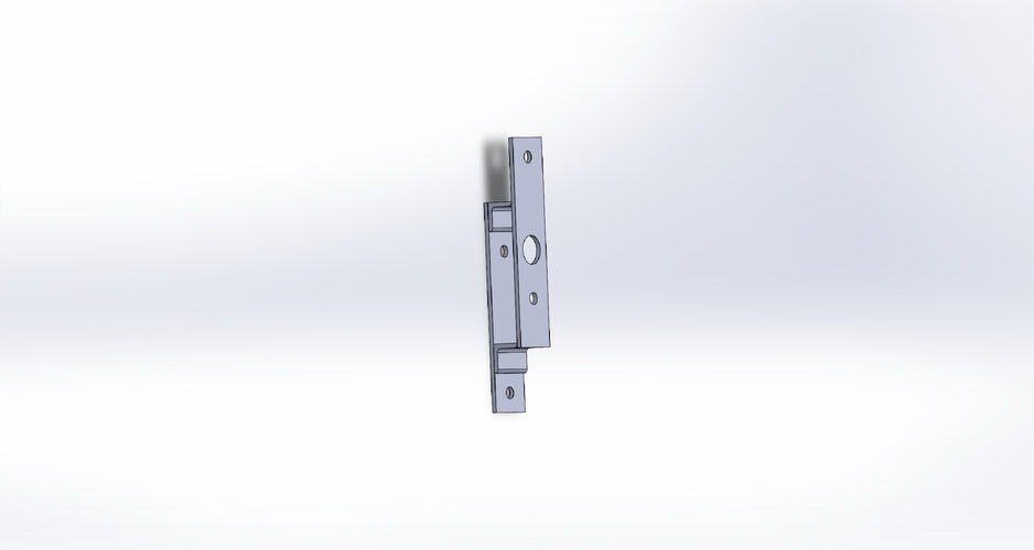

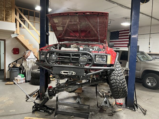

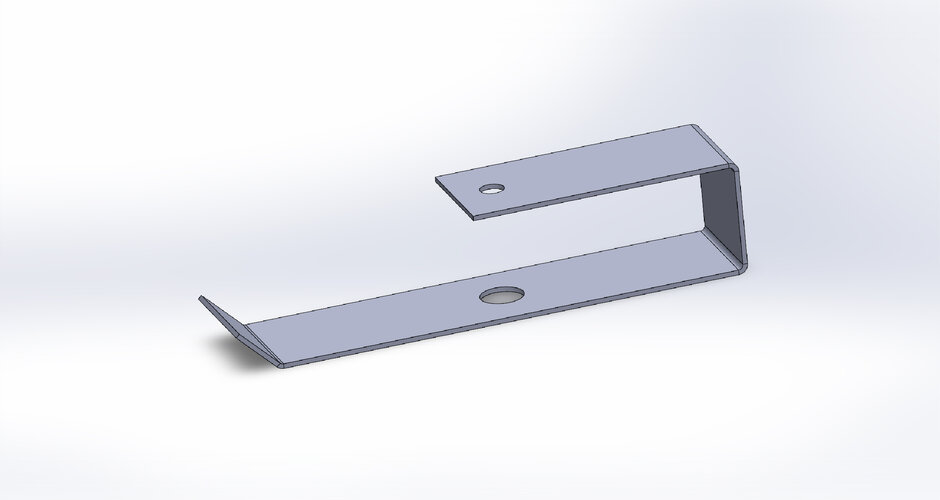

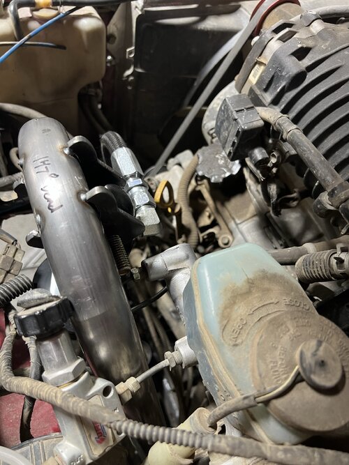

And just a quick picture of the coilover brace. We knocked out a bunch of little brackets, painting and other various small bits. Having SolidWorks and a plasma table is super cool and allows me to make quick little parts. I had to move my fuel filter up 2.375" up as well as have a better bracket and routing for my 0 gauge power wires. Bill had them just zip tied to the brake lines... :bolt:

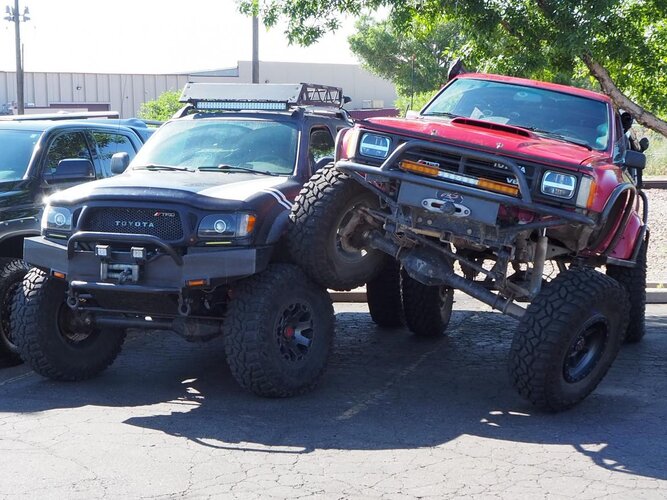

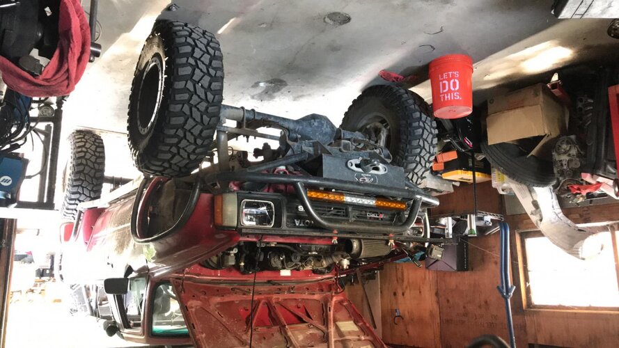

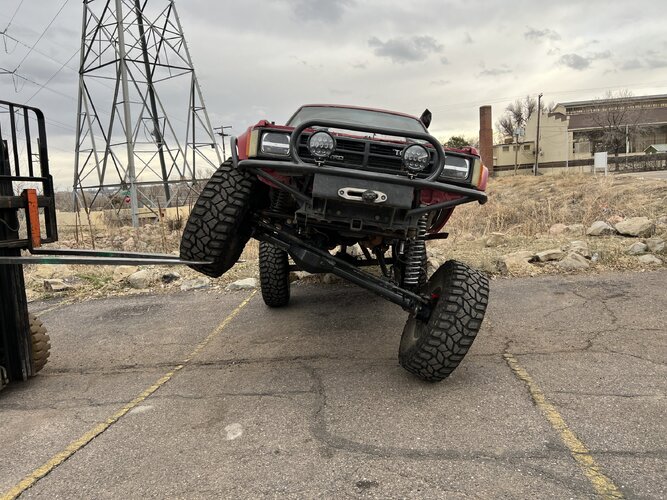

I haven't posted much in the last year, but the truck is almost ready for Moab. Hopefully I can get a shakedown run in before... Here she is flexing, but not flexed out entirely :oops:
