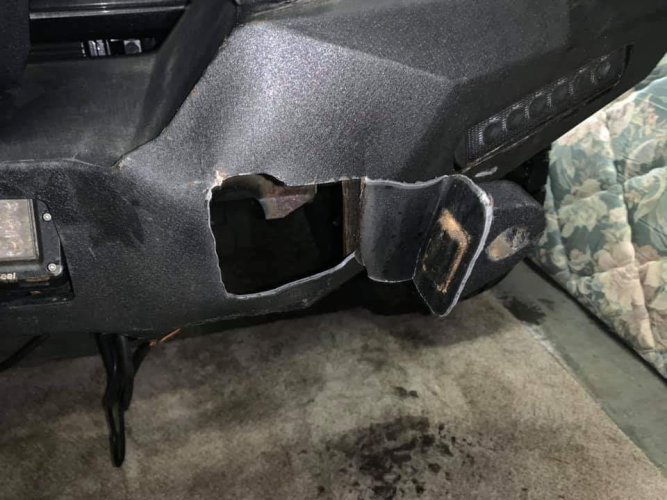

Now speaking of recovery mistakes. They were uber lucky the bumper face contained the failed tie point. In fairness to Ford and whoever made the bumper, that full throttle yank had to be in excess of 3x working load, even a properly done frame-tied point has a limit.
A way under appreciated aspect is the rating of the point you're tying to on your truck. The OEM aren't any more helpful than aftermarket in giving you guidance there, either. Tow ratings are OK but Toyota is terrible, no better than Ford or Jeep or Rover. WTF *is* that point rated for?
View: https://youtu.be/DXlJrDyAYHk
How sure are you of yours or the one on someone else's truck? Hanging a 7 ton shackle on this Amazon beer can POS wouldn't have made it any safer.

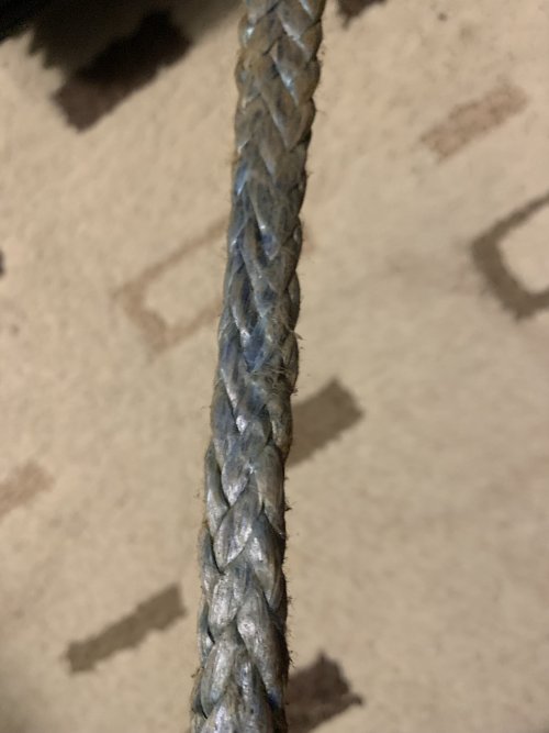

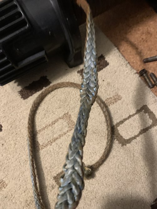

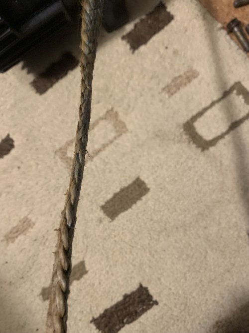

So, I threw the line away but had a little line left on the spool. Not really a bad part of it, but has some cracking noise when bending or trying to compress it. Getting a new winch with synthetic line on it, so I’ll pull it and respool as you suggested.
8,465
Visually that one is fine. Handling is the only way to know if those flat and compressed spots are good or bad.
Better safe than sorry? Of course, always, except when false sense of danger turns out as bad as false sense of security. The goal is understanding so as to properly use equipment. It would suck to not deploy a winch fearing bad line that is actually serviceable.
Quality HDPE line is incredibly tough. And visually indistinguishable from garbage. I have some true 3/8 Amsteel Blue Dyneema that is hard to cut with Kevlar shears. I have some genuine authentic 3/8 Amazonite that is easy to cut with Kevlar shears. Same size and *higher* (cough cough) rated on Amazon, but plainly weaker.

So the new Winch will come with Spydura UMHWPE line, I believe that will be good based on my little research. Bending that old line and hearing it cracking, certainly did not instill any confidence and the pic's does not show any of the worst part of it.
But thank you all for very valuable info.
