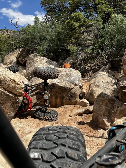

Is it a vehicle weight thing? No way to straight pull this guy. One pulled him over with a rope and ring and I straight pulled it back off the Boulder. No issues. I can see them degrading over time but I replace my rope regardless every few seasons and if one breaks we just thread it back together.
8,053
Buggies are a whole level up! o_O
More weight = more friction, right?
If rope breaks under load bad things can happen.

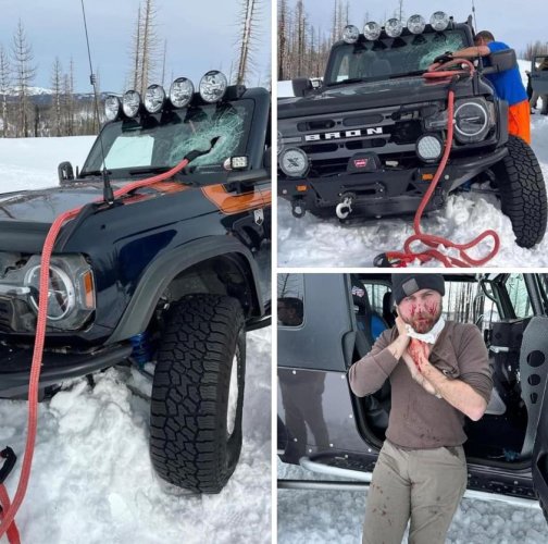

ouch
On the RX
Nov 19, 2016
2,145
Superior
Was this a winch ring?! Doesnt seem like the correct application if this is the case. Either way, these dynamic ropes always make me a bit leary since they build energy initially. If something fails before the built energy is used up, it adds to what ever choas unfoldes when something fails. Reckless Abandon!
