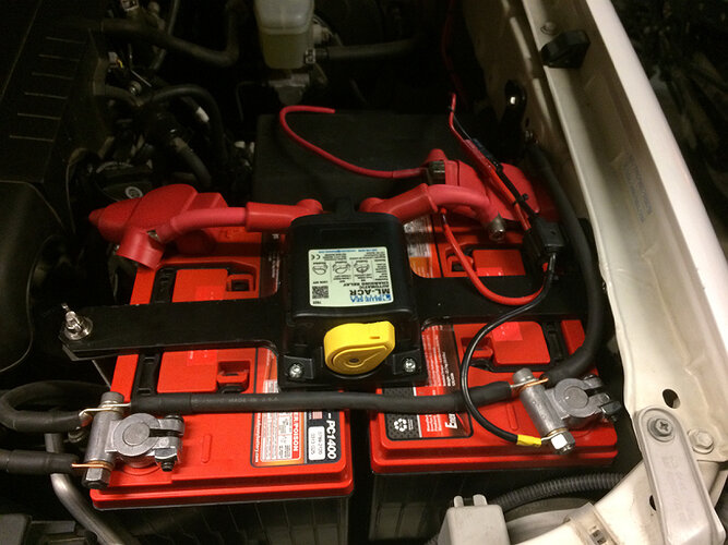

My main knock against AGM's is that they just don't get charged well, unless you modify voltage somehow, or augment with a charger at home. that said, I still run them, even just put one in the Tundra as my 2nd... the AGM's in the GX are old and they don't have a ton of capacity anymore, even when I charge them for a while I'll come back a few hours later to see voltage around 12.1 or so... but the car still starts, and if I need to keep a fridge running in the sun I'll add a fold-up solar panel. I like the blue sea VSR's the best...

This was the dual set up where I was chewing through Odysseys, just a simple VSR (ML-ACR) so there was no special handling of either side and I surmise this was especially tough on the nominally house side.

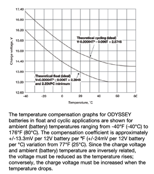

Keep in mind this is the battery temp, so consider how warm it is under the hood.

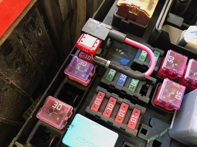

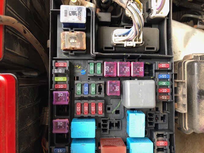

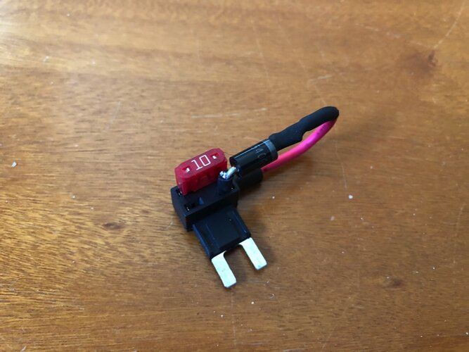

The ford diode was considered, but I didnt feel comfortable using it to protect the circuit as a fuse
14,150
I understand your concern.
It never bothered me when I considered that it's essentially just a 1N400x diode molded into a case with leads. That is rated 1A average forward current and will handle about 50% more constant current before overheating the junction. The ALT-S is a 7.5A fuse.
So if the alternator sense circuit was to short these would burn up long before the fuse would have. I'd worry more about it opening too soon. Nice thing about a PTC is it should close when it cools so the device doesn't self destruct like this diode would. I could never figure out what the PTC curve for those is so I wasn't sure if it was the same as an ATC fuse or that it wouldn't start to impede at high underhood temps and affect charging. I assume since they get very hot down under that they'd have accounted for that.
Just to complete the thought this was how it was installed in a 2008 Tacoma.
One advantage to a diode is that it's a negatively proportional device, so forward biased the voltage drop goes down as temperature increases. This is favorable to the application and tends to avalanche when overheated, also a fail safe.
So I tinkered with a way to do both. It wasn't reliable enough and wouldn't ever really soak full enough to stabilize and charge following any predictable way. I eventually just concluded using a diode drop to trick the alternator is just too variable to be of benefit. But should mention this is a 3A Shottky rather than a general purpose silicon rectifier, so the voltage drop was lower and more consistent part-to-part but temperature dependency is slightly worse in constant conduction.
