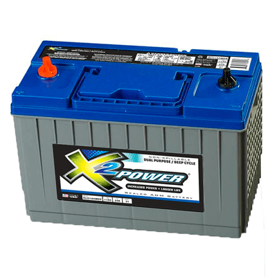

It is kind of spendy, but the "x2" blue top at batteries plus, has been the best battery I've ever owned. It is made by Northstar.
9,965

First time I've ever cross shopped batteries for more than CCA. What's amp hours in the real world mean? That X2 has double the red top I've been using, but it weighs almost twice as much too. What do you look for to get a quality one for the kind of stuff we do, but NOT one for use in a dual batt setup?

One nice thing about the X2 Power is that you can get it in a group 27 size. I'm assuming the 100 series uses that like an 80? https://www.batteriesplus.com/productdetails/sli27agmdp
Plenty of battery to run a fridge and what ever else without the need for dual batteries. This is what I have as my primary. I have a group 31 in my garage waiting to become my secondary along with a National Luna controller. Now I need some time.

Yeah I don't want to spend that much on the x2. I could get a red top and yellow top for that much and start a dual batter system. I'm just trying to land on one between the yellow top and odyssey.
