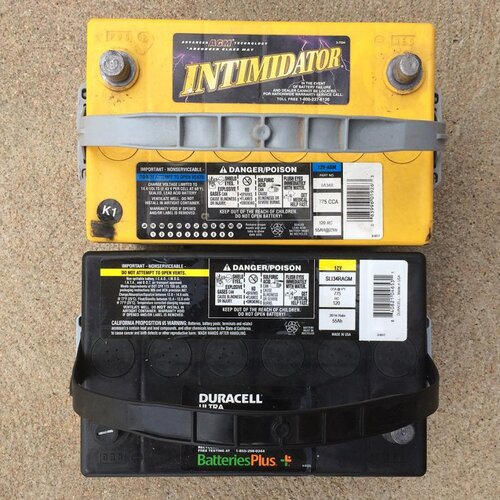

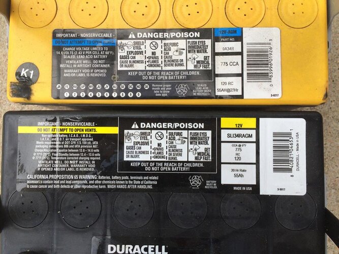

Due to some suspect electrical issues, I decided to replace my Deka Intimidator AGM 9A34R. I purchased it 4½ years ago from Hensley in Denver: good price, but inconvenient location (for me) and only open M-F.
I found that Batteries Plus sells the same battery under the Duracell Platinum name: model SLI34AGM. They gave me a $20 discount so my price out the door was $163 -- which is only $6 more expensive than the Deka I bought from Hensley in 2011. Better yet, Batteries Plus is open 7 days a week and has tons of locations.
Photos attached. It's the same battery: same specs, same case, same warranty.

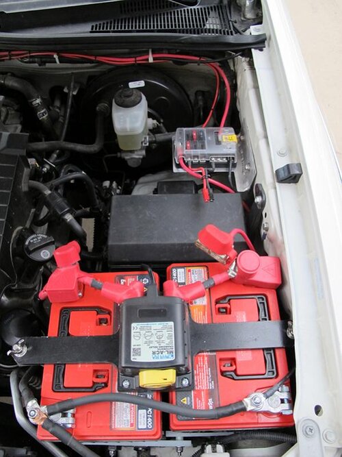

New batts are a good feeling. Just had two Odyssey PC1700MJTs shipped from VA but one is now in Bloomington, CA. Overshot the target by just a bit. Replacing two five year old PC1700s that I picked up as new blems and are probably good for another 1-3 years. Just being cautious as we have a couple of off-grid camping trips coming up. Will post an ad for the old PC1700s when the missing second new one shows up or PM if interested. $40 each or $65 for both.

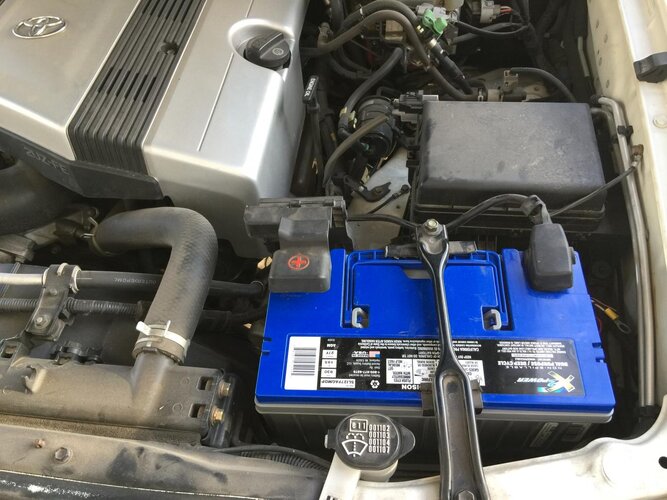

I wound up with an X2 after mine started dying if the car sat more than a day. It's huge compared to the one that was in there, and so far the truck starts much faster than it did. I still need to run the fridge hard a few times to see how it handles that, but has to be better than what was in there. FYI, you need a longer bolt on the front battery hold down point.
I have heard good things about the X2.
Not cheap, but a full 60 month warranty (not pro-rated) is nice.
BTW, our local CostCo does not stock the 27F for our 470, too bad.
