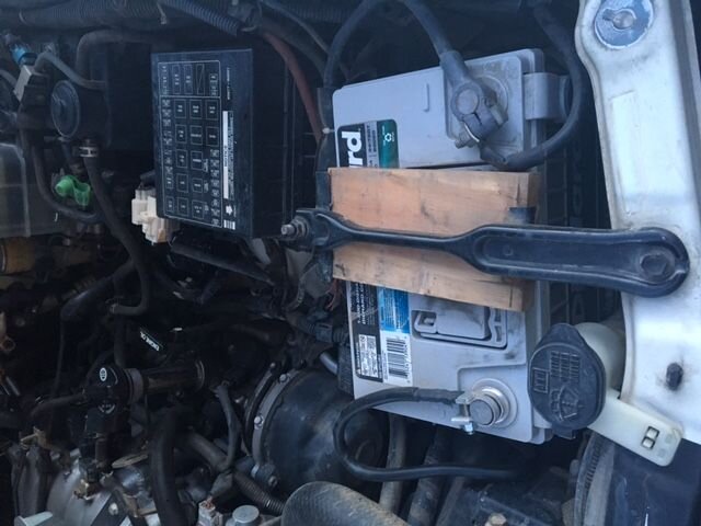

Mike you may be right, I'm going to try to breathe some life back into these DHP's, just seems too early to give up on them. Maybe a couple weeks on the charger like Andy did is what it will take.. if I can get these batteries to be good again I'll put them in the GX, which is going to get a dual battery setup sometime this summer.
In the meantime, I joined the X2 crew. I think I lost the OEM positive clamp so had to run to the store after dinner, it's all bolted up now even though it could be a little cleaner. But it's actually a lot more legit than what I had hooked up before. First impression is wow- hearing the starter wind up that high makes this truck sound like a little Honda or something, that has to be 30% more RPM easy.
before and after... yes I did finish in the dark. :hill:
