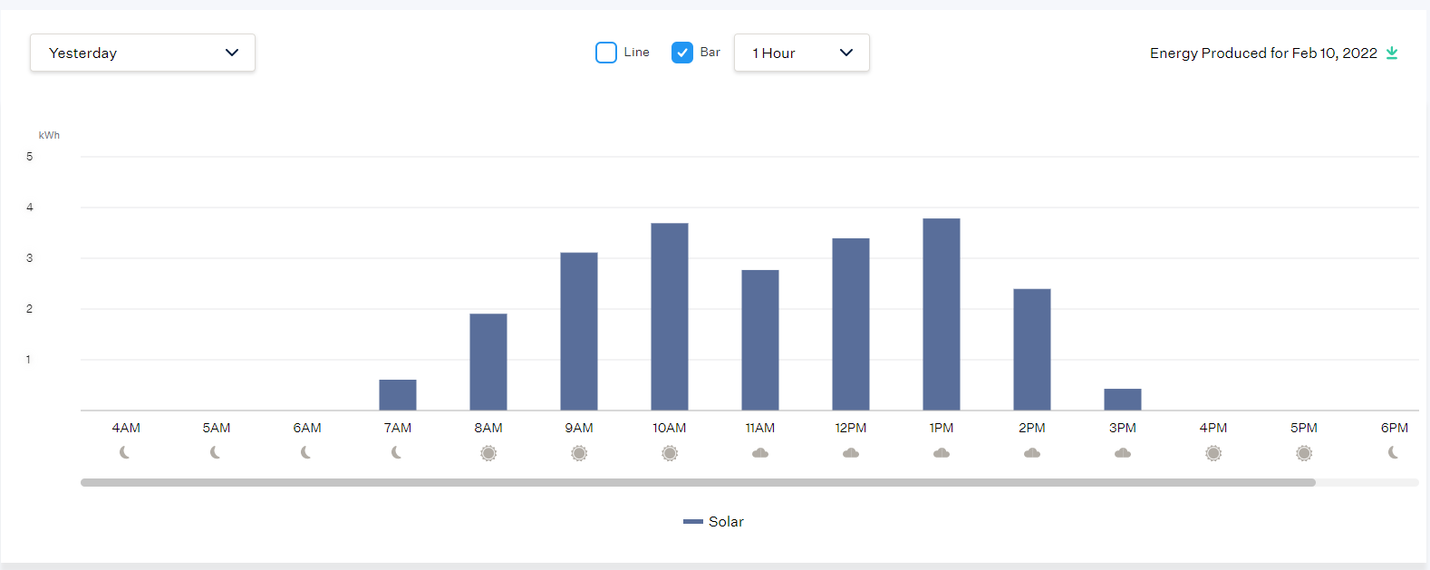

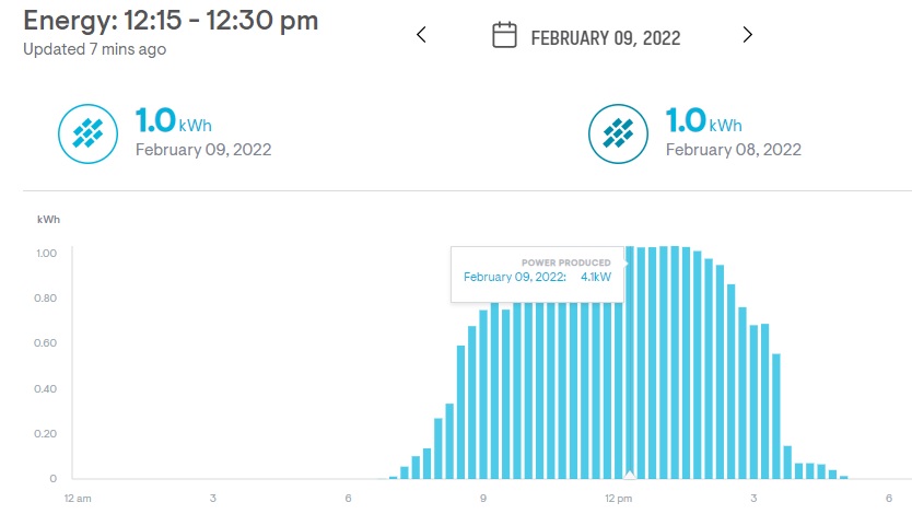

Yeah the graph is weird but it looks ok to me. I went cross-eyed counting the lines but it adds up to the KWh produced by your system from what I can tell. It looks like the graph program just makes a new bar once 1 kWh has been produced.
Interesting. What an odd way to display it. The point of charting something is so that you can tell the information at a glance. Kind of silly to have to do an analysis to understand a graph.

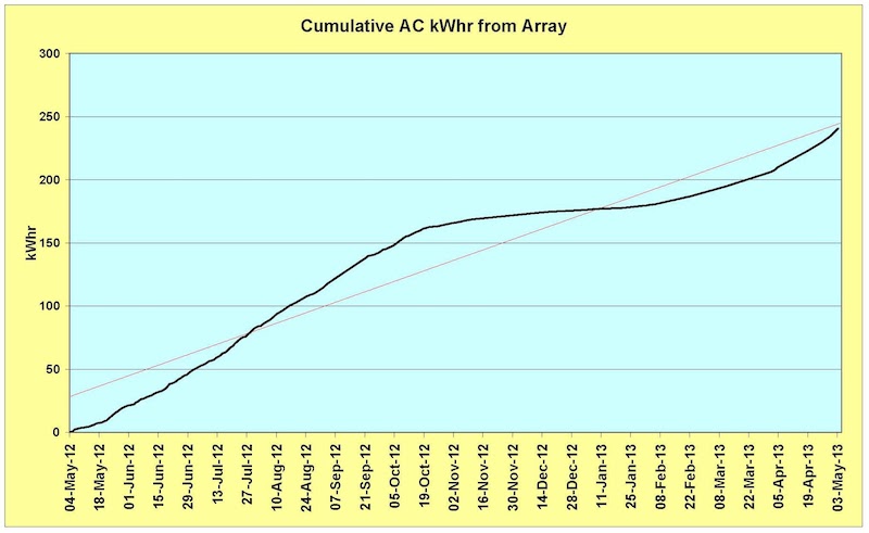

For cumulative I'd think this would make more sense, e.g. kW-hr accumulated in this case per day.
Or for hourly generating something like this, e.g. instantaneous watts per hour like Marco thought.

They are just 15 minute bars. There are 12 of them every 3 hours. It is just a coincidence that his system is producing about 1kWh every 15 minutes.
14,135
Just (to me anyway) not intuitive to do kW-hr per step time. Either accumulate or drop the redundant time. It seems to be normalizing to end up with another way to display the power generating capacity at any given moment.

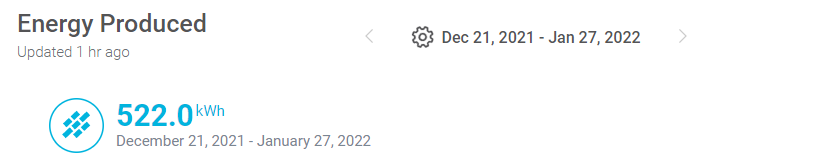

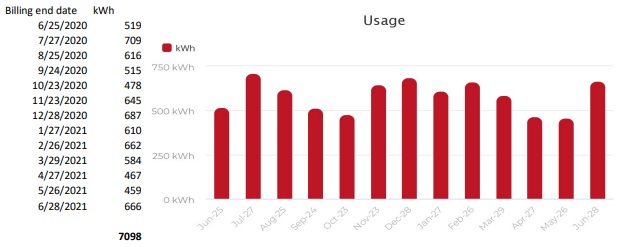

the usage seems in line, I have a hot tub now that I didn't have a year ago, which was on the whole time. My usage a year ago this same time period was 610kWh. So +87 kWh to power a hot tub in January, I'm good with that.
My solar production in this same time period was 522 kWh.
All of this seem great. Except the part where they deduct the 522 from 697? Can any of you guys show me on your Xcel bill what this looks like? I feel like I should either see that line item deduction, or the bill should only be for the difference between the two here... maybe I don't understand net metering.

So I seemed to have stumped the expert. Got a call back from the tech support guy, who started off telling me how well my system is running... I've produced 590kWh this year, yippee. I asked why my production graphs have such a severe plateau to them. Was told they are intentially governed at 90%, to allow for sudden spikes such as a lightning strike or something. Then we figured out how to see my data in watts (or kilawatts, but I can move a decimal point), rather than kWh. I just need to mouse over one of the bars.
So my system peaks out at 4.1 kW, or 4100 watts. My only issue with that is I purchased 17 320 watt panels, which is 5,440 watts. scale that back 10% and I should still see 4,896 watts.. So why doesn't that graph peak out at 4.9, rather than 4.1? I'm throttled back 25% here, not 10. And as the angle of the sun improves, I'll produce no more power, just longer periods of 4.1kW. Apparently I'm the first guy to ask this question, they're going to have to call me back.
14,135
You will rarely get exactly 100% from a solar panel. Their rating is based on what is known as STC, Standard Test Conditions. These are based on the temperature of the panel itself and the ambient air both being 25°C/77°F, 1,000 watt/m^2 irradiance falling upon it in an air mass (AM) of 1.5.
At this time of year Denver will get about 3.25 kWh/m^2 on a panel facing directly south at a tilt of 42°. This is over about 4.4 hours, though. So the daily insolation average is maybe about 800 watts/m^2 this time of year. It would also be lower if your panels aren't tilted at 42°, which is possible if they're fixed and your roof isn't that steep.
So getting ~75% of nameplate rating this time of years isn't bad or surprising. You'll get a lot more in June and July. Wouldn't surprise if you got more than 90%. Insolation is maybe twice as high in the summer here and would be more than 1,000 W/m^2.
In the summer what hurts you is the panel temperature gets very high. The temp coefficient is on the order of -0.30 %/°C. So if your panels go to maybe 45°C (+20°C over STC) that means even if you have ~1kW/m^2 and perfect tilt (about 70° then) the panel will still be ~6% lower than nameplate rating.

I get that it will never be 100%, but it's just so obvious that it is being limited to 75%. I can scroll back through days and days of data where my graph plateaus at that 4.1 kW mark. In fact if this continues, my next test will be to go up there and unplug 3 of my panels, I'm guessing I still hit 4.1. My panel tilt relative to the sun couldn't be better right now... 4:12 roof pitch facing dead south.
14,135
Yeah, that came to mind as I thought about it more. It is obvious your inverter(s) is(are) limiting, but that's not unusual, like they say, to have significant overhead DC capacity to achieve your AC rated power under marginal conditions and as panels age.
I've mucked up you thread to the point I may not see this, but did they sell you a 4kW or 5.44 kW or something else for the system? I mean you say you purchased 17 x 320 watt panels but what is the AC capacity they actually promised?
Those Enphase inverters might just need new setpoints, if they're programmable anyway. Or maybe you're still not getting all 17 online. That should be easy to tell. Do you know the exact model of inverter? They might be undersized and just clipping.
You know, now that I think about it you might be seeing a watts vs. volt-amps (VA) problem. You're used to seeing watts, which is real power. In DC power is always watts. When you work with AC the idea of imaginary (or apparent) power has to be introduced. If your inverters are 250 VA then everything is actually working as you'd expect, you're generating 17 * 250 = 4,250 VA and can only do 4,250 watts of work.
Xcel has always taken care of this for you. You only pay them for real power, e.g. watts, since that's all that can be metered or do actually work.
However their power plants are also generating apparent power (reactive) to handle the fact that loads aren't all real. Any motor, for example, throws the relationship of voltage to current off due to inductance. This is measured in what's called the power factor and will tell you how out of phase voltage and current can get. A PF of one is when watts = VA. When PF is anything other than one they you're asking Xcel to do generating work for free. They put capacitors on the grid to correct PF, since non-resistive loads are historically inductive. Ultimately the power factor feeds into a calculation for required engine power (or DC panels in this case) necessary to drive the alternators (inverters) to maintain stability. Ultimately the total apparently power is what circulates in the grid, the reactive part just can't do anything useful but does cause real problems.
When you're tied to the grid you have to account for this so that you don't overtax your system, which could cause issues to both your system and the grid's integrity, perhaps if you suddenly fall off voltage or frequency. Maybe ask the system engineer to look into PF, explain whether the inverters are sized or set correctly and meet the promised capacity.
Maybe you actually were supposed to get 290 VA inverters (290 * 17 = 4,930 VA), for example. That would give you around 9% DC-AC margin.
