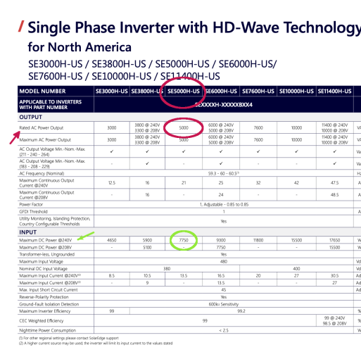

These what I see for now, its a 5kw system FWIW. 5kw inverter and 18 x 295w panels with 18 optimizers. My power will clip on a real sunny day in summer since the inverter is a 5kw unit and the panel output is slightly higher.

Yep, that's how I figured it was going to work when I designed the system with headroom for more panels... I only wish I would have gone with a 7600w inverter given the efficiency they are rated at but hindsight is 20/20. Initially I had the system designed around a 3kw inverter and 2950w worth of panels and did the initial build with 2950w worth of panels with a 5kw inverter instead.... I thought that was decent. Pretty immediately after I finished I added 8 more panels since the cost was negligible. Anyhow, That's also why I just looked at Tim's graph and instantly just thought "clipping" but I wasn't looking at units.

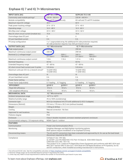

I believe Tim said he had Enphase so just picking arbitrarily the IQ7.
Knowing the exact model would determine if this line of reasoning makes sense.
But 240 VA x 17 = 4080 VA and looks like they can handle up to 350 watts, so would be safe with his 320 watt panels. So perhaps they were supposed to use the IQ7+ at 290 VA, like I was saying, like a BOM mistake (simple typo) or supplier mistake or sourcing issue with the one sales promised.

Marco that's exactly what I was curious about, thank you. So your system on paper is 5,310 watts, almost the same as mine actually a little bit smaller (5440). So at a 90% threshold saving a little room for spikes, that's 4779 watts, or 4.8 kW. And dangit wouldn't you know it, your graphic example of "clipping" has that mark right at 4.8.. maybe even a little higher. So your system is doing exactly what it should be, IMO.
And down here, I'm capped at 4.1.. I was told today there's a software update they're pushing to my inverters, and to give it 30 hours or so to catch up. So I've got another call scheduled for Monday with the tech guy.

Call me weird (yes, I know, I know) I'd put eyeballs on name plates to make sure I got what I paid for.
Marco's is clipping at 5 kVA because that's what his inverter is designed to do.

Dave you're correct on the IQ7, I have had a few calls now trying to understand why they aren't IQ7+ which would have given me the expectation I had. But I'm also tripped up on the AC to DC conversion here, so apparently shouldn't be looking at the data so closely. The fact that I am clipping for 80% of the day is supposedly a positive, and my kWh numbers seem really good for this time of year. Anyway my attempt to push back and get my inverters upgraded was essentially denied.

Ok a couple months in and I've decided to ride out the year then assess if I want to go through the trouble of swapping out my inverters, to boost up my output. I have also learned that adding a hot tub and EV has about doubled my electricity usage, at least in February, to the point where our bill is about the same now as it was before we added solar. Just doesn't feel like I'm netting much savings here, but not ready to make any decisions yet based on only a couple data points.
I did call Xcel though after my lasts bill, wondering how I used 1300kWh this year when last year I used 700kWh in the same period, thinking something may not be right with their net meter? And can they tell me how much electricity they received from my system... I was promptly correctected that Xcel has no idea how much solar energy I produce- all they know is what the meter tells them, so if it spins one way that's me making power, if it spins the other way that's me using power, and I pay for what they measure that I use.
So now I'm back to looking at my output and trying to decide if there's an ROI in upgrading the inverters- would be a ~$2k event so my gut says it's probably not worth it. But here's a typical graph now on a sunny day:
As you can see there are a good 4 hours now where I produce 4.1kW, or 4100 watts. My panels (17x320) could technically max out at 5,440, but we could peel that back to 5100watts just to be a little more conservative, and to make the math easier. So right now in April there are 4 hours per day where if I had better inverters I'd get another 1000 watts/hour. Currently I top out at around 35kWh in a good sunny day.
So just trying to run the math out here, if there are 20 days/month for 6 months where I could net another 4000 watts, that's another 480 kWh of electricity, right? I think I pay $0.158 per kWh, so that's $75? that's a 26 year ROI on swapping the inverters... doesn't seem right.
