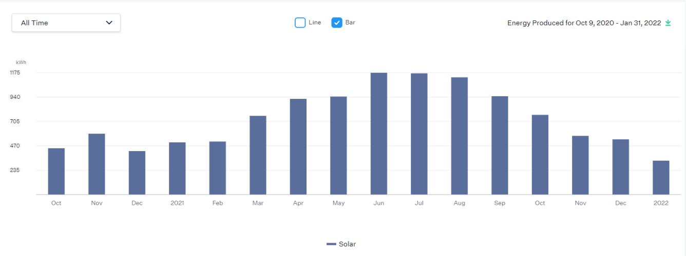

15,695
Hey help me understand this... the last three days it's been pretty sunny, and I made 26, 28, and 22kwh per day. But when I look at my graphs I appear to be topping out on production right at 1.00 kWh.
It's like I'm hitting a limiter. Is this the most my system will produce? So the only way to produce more than 1.00 is to add panels? Or could there actually be a governor on the system setting the limit? My system is rated at 5,440 watts. but I don't get how that correlates to what I am measuring.
9,779
Usually that happens when the array is oversized for the inverter. what inverter do you have? how many panels and of what wattage? It's not a bad way to design a system and I think harkens to a time when inverters weren't as efficient when they were running at lower than rated power.
14,282
The graphs look odd to me, too. They seem misleading since there's no instantaneous kW-hr measurement. You have power, which is watts, generated over time. So if 1kW flows constantly for one hour you have generated 1kW-hr.
To get 24 kW-hr per day you need 1 kW generated for 24 hours. But this is impossible of course. So 24 kW-hr per day is generally something like 6 kW for 8 hours midday. So given that reality it makes sense that your 5440 watts would have 26, 28 and 22 kW-hr total generated per day (about 8 hours) in the winter.
Graphs like that would I think be a cumulative or average kW-hr amount of energy made. So it should be either increasing or decreasing as the sun arcs overhead. It can't be exactly flat for several hours.
Maybe it's showing how much energy you're putting into the grid and that is capped at 1kW? Or starting around 9AM your household uses most of the power, e.g. the ~4kW difference is being consumed? It seems too ideally flat for consumption but maybe it's just a fluke that furnace cycling and that sort of thing average out.
Best thing to do is check your net meter and compare it to the readings on the app. If you are generating power you should be flowing backwards or negative. I do this from time to time to make sure everything is on the up and up.
Do you have a monthly graph or just daily? Curious as to what the monthly or annual graphs look like or how the measurements are determined.
10,709
Centennial, Colorado
the graph doesn't make sense to what you say you are producing a day. The flat top is indicative of "clipping" meaning something is at is limit which most likely would be an undersized inverter as stated above
Are you sure that isn't a panel or just a string? If so then that could be that panel or string reaching its normal saturation point which may be OK
you would expect at a system level to have a more bell shaped curve like I posted above.
15,695
Marco: I've got a micro inverter at each panel. 17 panels 320 watts each. even at 50% I should still see double what I am seeing on this graph, right?
Dave: appreciate the comments, and I agree it doesn't seem to add up here. I have asked Project Solar this same question, haven't seen a response I suspect it's getting bounced around internally there.
Ray: How would I check my net meter? the thing on the side of the house? All it does is have little squares that go left to right when I'm consuming power, and right to left when I'm generating it... are you comparing the numbers on the readout?
yeah I can graph a month, or a year. Here's January:
So I made 435kWh in 31 days, that's 14 per day. Big difference between the sunny days and cloudy days, no surprise there. But 14x365=5,110, and I have a 5,440 watt system. So this totally adds up to me... once the sun is out for longer that daily average will climb, take a dip again next fall, etc. But maybe I'm getting my units mixed up, still don't know why it would top out like that.
Ken: that graph is the whole array, I don't think I can get indivual graphs on the panels. What I can see though is what each panel does each day? Here is yesterday for example:
So the sum of all of those panels is 28.4?

Aren't each of the bars representing ~15 minute intervals? If so, that comes to about the about correct kWh per per 15 minute interval for your system in the winter right? Then multiply times 4 for each hour equivalent. There are on average about 4.4 sun producing hours per day at the winter solstice and about 5.7 during the summer solstice. The snow/clouds has skewed you lower for the month of January. Your 5.4kw system should be able to produce 5.4kw per sun producing hour assuming 100% efficiency. Your system is probably about 97% efficiency right? So 4.6 (sun hours) x5.44 (kW) x0.97 (efficiency)=~24.27kWh per day on a sunny day right now during winter.
Iam assuming that your meter has a digital number read out on it plus three little blocks underneath the numbers that move from left to right or visa versa depending on whether your producing energy or not.
What you can do is go out early in the morning and read the number on the meter then check it again in the afternoon when the sun goes down. Obviously you want to do this on sunny day so you can see if your meter is running backwards or counting down. You can compare this number to what your app is telling you what you're producing.
Personally I think your app may just be acting up. It looks like in your monthly and annual charts are reading correctly.

Yeah the graph is weird but it looks ok to me. I went cross-eyed counting the lines but it adds up to the KWh produced by your system from what I can tell. It looks like the graph program just makes a new bar once 1 kWh has been produced.
