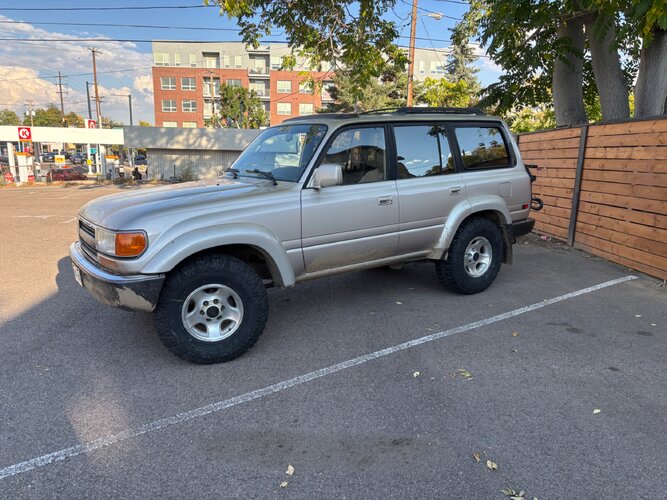

Thought I’d treat myself to a set of fresh tires. She’s fitted up with some 285/75R16 Patagonia m/t’s. Still haven’t had any rubbing driving around town but I suspect it will on the trail. I’ll install a lift over the winter. How do we think she’ll do in Moab as is?IMG_3712.jpeg

Looking good
every tire is a little different, but I never had any issues while stock and full flex with rubbing when i had 285/75/16 duratracs on LX wheels.
should be fine, but i'd put sliders on first..... just my opinion......
^^THIS^^ 100% agree, protect that expensive sheet metal first. I've seen tons of non-lifted 80s do all kinds of stuff at Moab. IMHO the reason for any given lift is to fit the bigger tires you want to run.

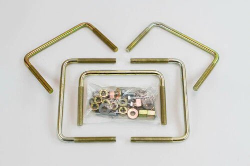

Slider mounting question: I'm looking for u-bolts to wrap around the frame, does anyone have suggestions on dimensions and the best place to source them?
I have a set (unmounted) that I will be using, but if you'd like to measure them to diy yourself a set. But $85 without measuring and wasting and afternoon sounds like a solid bargain.

I saw those online, only issue is my set has 6 attachment points at frame and that fit only comes with 5 bolts. Also when wrapping around the frame what do you do about brake lines?
Haven't mounted mine, but I'd shoot 'em an email. My best guess is that the other nut is either not pictured or it uses a factory existing but.
