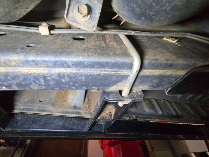

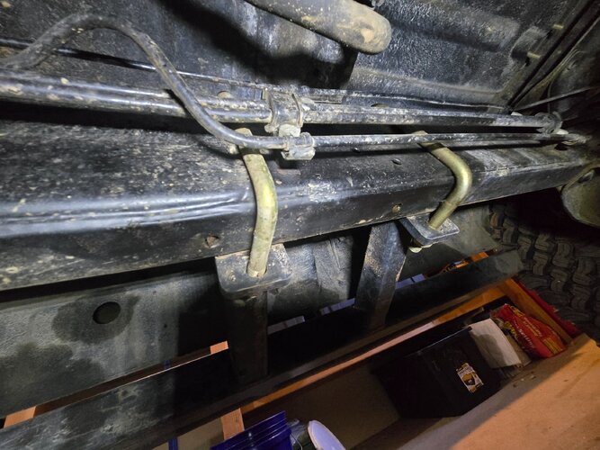

I saw those online, only issue is my set has 6 attachment points at frame and that fit only comes with 5 bolts. Also when wrapping around the frame what do you do about brake lines?
You should place the ubolt inside of the brake lines. Might need to unbolt them in some spots to fish the ubolt in, but no need to separate anything.
I do not recall the slee sliders having any spacers on the 80. On the 60 the white knuckle sliders have new bolts to space all of the hard lines of the frame.

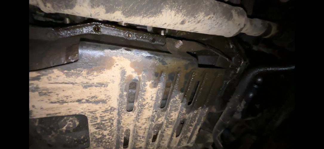

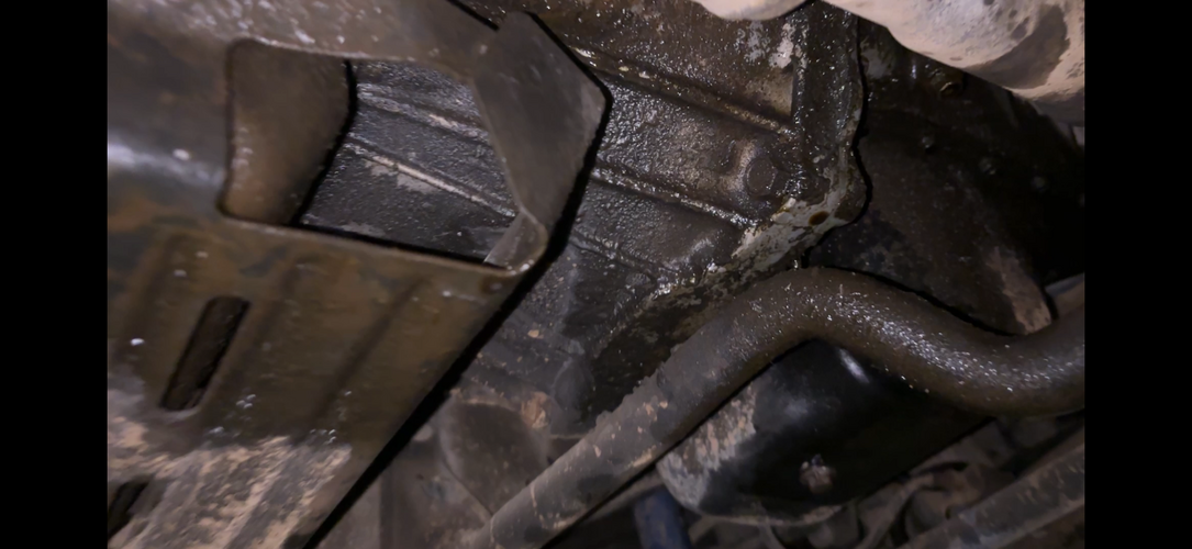

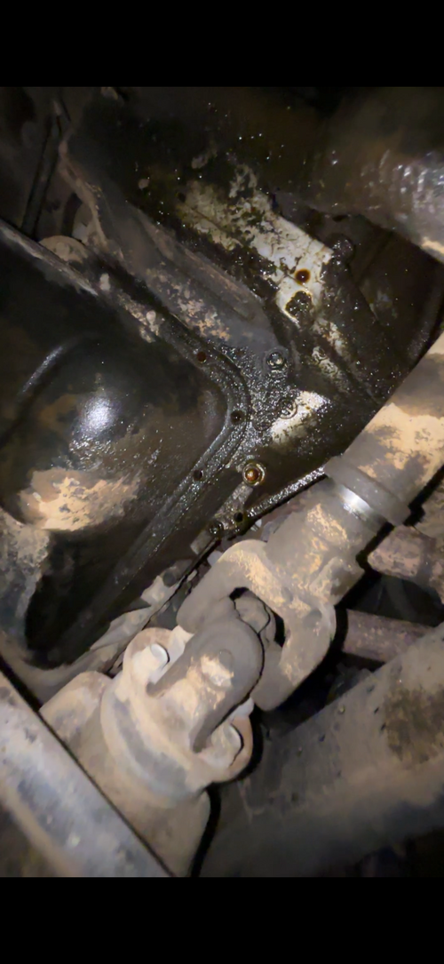

As of a few days ago I have developed a pretty substantial increase in oil leakage. It’s always had a minor rear main leak that I “shouldn’t worry about” but all of a sudden I’m leaving stains in my parking spot at work. There seems to be buildup around the oil pan gasket, maybe it’s coming from there? There’s also some oil (not atf) around the transmission pan. If anyone has had an experience like this I’m all ears.IMG_4290.pngIMG_4292.pngIMG_4291.pngIMG_4293.png

Looks like oil pan to me.

That’s music to my ears as that looks like a straightforward replacement. But if it is the oil pan would it be traveling all the way back to the transmission pan like it is?

If the leak is bad enough it will get blown back onto other things while driving.

Are the lower pan gaskets susceptible to leaks? Now that I’m reading into it, it seems like the upper pan is prone to leaks. Though, that seems like a PIA job to replace.
its not as bad as the rear main seal, but its definitely annoying to do. but yes it generally is the upper pan arch seal that leaks. if you dont have/have access to an engine hoist, you could use a long 2x4 and a floor jack underneath the crank pulley to raise the engine up in order to drop the pans.

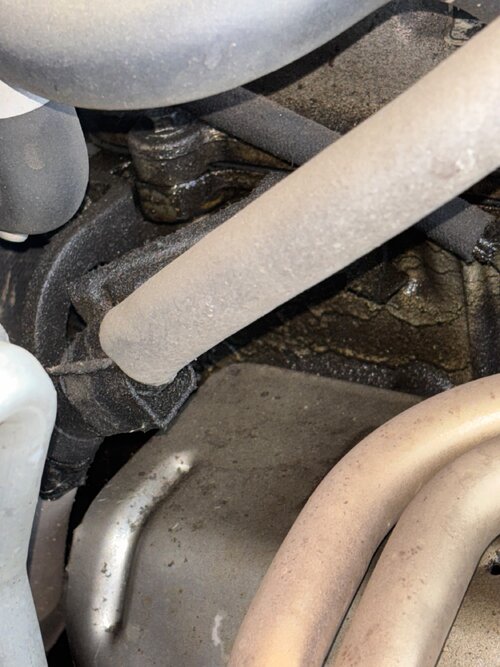

This picture is probably hard to make out, but there’s no way a valve cover leak would travel all the way down there that quickly in that quantity, right? I was told the valve cover gasket was done not too long ago, although it's obviously leaking. Could a botched valve cover gasket job warrant that kind of leakage?
That falls into the “probably not” category. I suppose that if you ignored a leaking valve cover for long enough, it would eventually make a mess down low. It’s more likely going to come from the lower oil pan, rear main seal, front crank seal, oil pump cover.
Another sneaky one is the timing cover. I’ve seen them leak just above the power steering pump where it meets the block. Makes a mess and the engine needs to come out to do a proper reseal.

I’m going to assume it’s something towards the back half of the engine based on where oil is running down. If I were to go ahead and start resealing things working backwards from easiest to replace possible cause we’re should I start? Might also go ahead and to the valve cover gasket while I’m at it as it seems straightforward.
id start at the front and work your way backwards. dizzy oring, oil pump cover, front crank seal, probably your power steering lines/pump/gearbox, oil pans, rear main seal, transmission input & output seals, HG/VC/valve guide seals/timing cover.
What Dwight said. ^^^

Agree with Dwight too. The dizzy oring is a really easy one to start with and is almost always a leaking point in a higher mileage 80.
