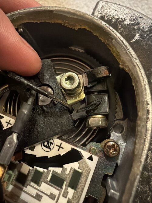

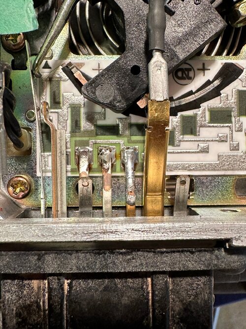

Took the top off the maf but I don’t see any obvious bad solder pads. Rechecked the resistance for the air temp sensor and that came back good again as well. So it’s just the open/close that’s the issue.
8,999
in da house
Then you are almost there. You got this. Check out the cleaning of them with contact cleaner. Bunch of youtube.... Is the flap sticking?
make sure there are no hairline cracks in the solder, clean the board with qtip and contact cleaner. Isn't the arm supposed to be over touching the flat contact?

I haven't seen that I'll take a look at it!
The arm was over I just moved it out of the way for the photo to give a better look at the connections. I'll give a nice to clean to everything on that main solder board and see if it helps the resistance values at all!

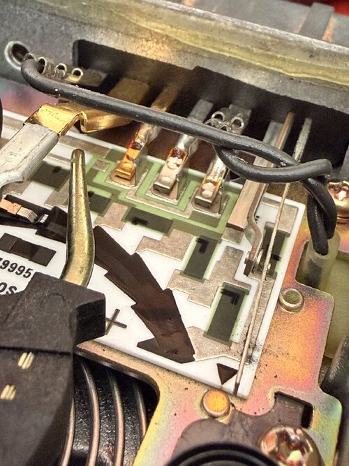

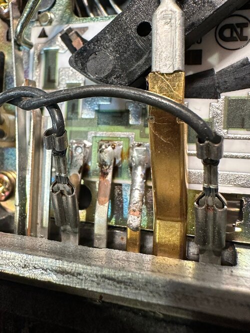

I might have found the issue!
Looks like some of the wiring shielded melted off. Going too see if I can somehow replace it
IoN6
Sep 2, 2019
1,476
That wire appears to be broken as well.

Well the wire isn’t replaceable sadly. Going to send it in to the eBay guy and hope he has extras to replace this part with.

Welp that eBay guy didn’t do anything but spray paint it and reseal it.
Still reads 2000ohms at fully closed when it should be 200-600.
I have no clue what to do atp so if anyone finds a in spec afm let me know as otherwise it’s probably getting sold.
