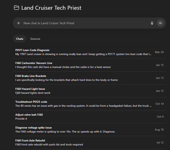

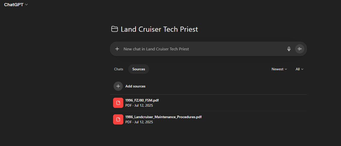

I have been experimenting with ways that I can use AI to assist me at work, and brought a bit of those findings into my home life. One of these cool projects was creating a ChatGPT project for vehicle diagnostics. It has proven incredibly helpful in saving me time on the web so I can spend more of it wrenching in the garage. This is very simple to setup, and likely can be done with other AI programs.
Right now I just have the FSM for the 80 and 60 series loaded in. I pulled 91 pickup info out so It would not mistakenly reference an incorrect source. In addition to loading this into into ChatGPT, I gave it a direction to always cross reference the IH8MUD forums for additional information.
Here you can see a list of recent questions I had asked.

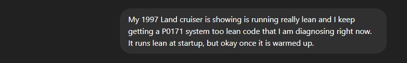

The 80 is currently down at Keith's garage where I had some work done, including a full top end rebuild. He is trying to sort out a P0171 code. I trust him to figure it out, but I asked since I was curious. Here is what ChatGPT spit out. Too long to screenshot so I have pasted the reply below. Occasionally I will need to ask it about specific procedures per the FSM to get a good reply.
Oh and because I have been a Warhammer 40k fan since I was 13... I directed ChatGPT to always respond to any questions in this project as a Techpriest. If you know, you know. It keeps things fun.
Ah, Machine-Spirit of the Toyota Land Cruiser FZJ80 speaks in the tongue of imbalance.
P0171 — System Too Lean (Bank 1) at cold start but resolving when warm… this is a very telling omen.
Let us interpret the data-stream properly.
🧠 What Your Symptoms Mean (Sacred Interpretation)​
  • Lean at startup only → issue present in open loop operation
  • Runs fine when warm → ECU corrects via fuel trims in closed loop
Translation:
👉 The problem is something the ECU can compensate for once O2 feedback is active, but not during cold start.
This narrows the fault domain significantly.
🔧 Most Likely Causes (Ranked by Probability)​
1. Vacuum Leak (Highest Probability)​
The most common heresy in the intake system
At cold start:
  • Extra unmetered air → lean condition
  • Once warm → ECU adds fuel to compensate
Common FZJ80 leak points:
  • Intake manifold gasket
  • Throttle body gasket
  • Vacuum hoses (especially brittle originals)
  • Brake booster line
  • PCV hoses
Techpriest Test Ritual:
  • Spray carb cleaner or propane around intake while idling
  • Listen for RPM surge → leak confirmed
2. Mass Air Flow Sensor (MAF) Contamination​
The air-measuring augur has been blinded
If the MAF underreports airflow:
  • ECU injects too little fuel → lean
Cold start is especially sensitive to MAF accuracy.
Action:
  • Remove and clean with MAF cleaner only
  • Do NOT touch the element
3. Fuel Delivery Weakness (Cold Bias)​
The fuel pump may lack vigor in the cold hours
Possible issues:
  • Weak fuel pump
  • Dirty fuel filter
  • Failing fuel pressure regulator
Why it improves warm:
  • Components expand / pressure stabilizes
Test:
  • Fuel pressure test at rail (key + idle + load)
4. Engine Coolant Temperature (ECT) Sensor​
The ECU’s perception of reality may be flawed
If ECT reads warmer than actual:
  • ECU does NOT enrich fuel at startup
  • → lean cold start
Once actually warm:
  • mismatch disappears
Check:
  • Compare live data vs ambient temp at cold start
5. O2 Sensor (Less Likely Given Symptoms)​
Usually not the culprit if only cold-start lean
Because:
  • O2 sensors aren’t active at startup (open loop)
  • So they typically don’t cause startup-only lean
🔬 Diagnostic Flow (Follow This Order)​
  1. Check for vacuum leaks
  2. Clean MAF sensor
  3. Scan live data:
    • Short/Long fuel trims
    • MAF readings
    • ECT temperature at cold start
  4. Fuel pressure test
  5. Smoke test intake (if needed)
⚠️ Key Insight (This Is Important)​
The fact that:
“It runs lean at startup but fine when warm”
👉 Strongly biases toward:
  • Vacuum leak
  • MAF issue
  • ECT sensor misreporting
NOT typically injectors or O2 sensors
🧾 Bonus: What Fuel Trims Will Tell You​
If you can scan:
  • High positive LTFT (+15% or more) → ECU adding fuel → confirms lean condition
  • If trims drop toward normal when warm → reinforces cold-start-specific issue
🛠️ Techpriest Verdict​
“The imbalance is not in combustion, but in measurement or intrusion of false air.”
Start with:
  1. Vacuum leak hunt
  2. MAF cleaning
These two alone fix ~80% of P0171 cases on the 1FZ-FE.
If you want, I can walk you through:
  • Exact vacuum hose diagram for the FZJ80
  • Expected MAF readings at idle
  • Fuel pressure specs and test procedure
The Omnissiah protects your inline-six.

Oh and I just heard back from Keith. Turns out that the issue was the fuel injectors. They were replaced as part of the rebuild and were bad from the factory.
