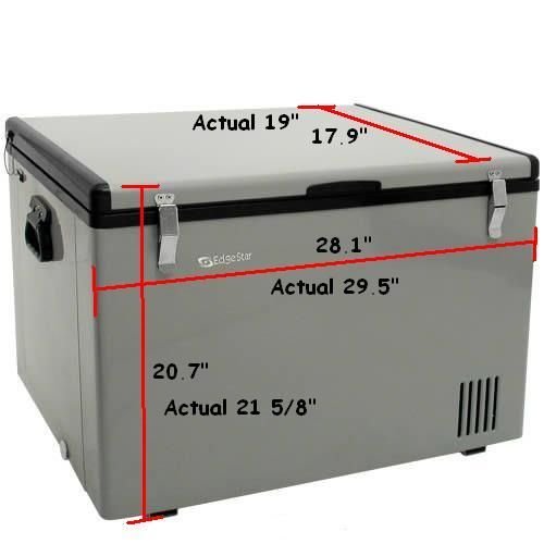

OK Folks, if you would please indulge me. In the descriptions I see on these, and on Edgestars web site it lays it out as Width, Height, Depth. Now call me silly but height and depth seem to describe the same thing to me.
I would think it should be Length, Width, Height. Can someone do me a favor and break it down for me...is depth really the width, and width really the length, and height really the height???? Not trying to be thick, but I have a very specific space I need to use it in.

Just measured mine to verify...
The 63Qt unit states:
Dimensions:
Outside Dimensions: Height: 20.7", Width: 28.1", Depth: 17.9"
Inside Dimensions: Height: 15", Width: 23.5", Depth: 12.5," compressor step runs the full depth at 7.75" h and 7.75"w.
Height is height - It is 20.7" high or tall
Width - You can call that the length...or distance between the handles
Depth - I would tend to call this the width...or distance from the latch side to the hinge side
So, basically what you said :hill:
Just in case...I put this together...No comment on my lack of Paint skillz :rolleyes:
EDIT: I took some actual measurements and updated the pic

Now another question for you, when you open the lid are the hinges recessed so that the lid doesn't cause any extra depth when you have the lid open at lets say a 90 degree angle?

I took some actual measurements of my fridge/freezer and updated the picture above...As you can see, the listed dimensions vs. actual are a bit different. I'm guessing the dimensions they list are strictly for the outside case without handles, hinges, latches, etc.
As for the lid, the hinges are NOT recessed...To open the lid 90 degrees you'll need about an additional 2 1/4" of room. Actually, to open the lid at all you'll probably need about that much additional room.
So for the FP630 that updated 19" of depth needed really needs to be ~21 1/4".
Hope that helps

Your information is greatly appreciated!!!!!! Exactly what I was looking for.
