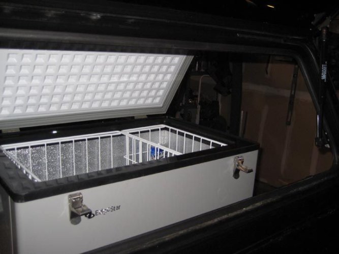

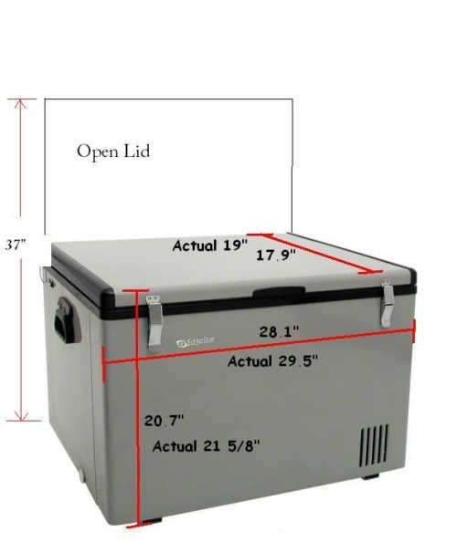

you know that's a good point about the lid- not only do you need to have clearance behind it, but that depth is going to be added to the height as soon as you open the door. When the door is fully open on this 63 quart Edge Star, it measures 37" to the top. I can't open this fridge all the way when it's inside my truck with the topper on, only about halfway.. my smaller Engel opens all the way though in the same space.
edit: picture with lid :hill:

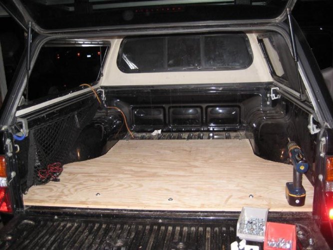

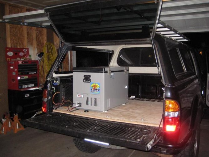

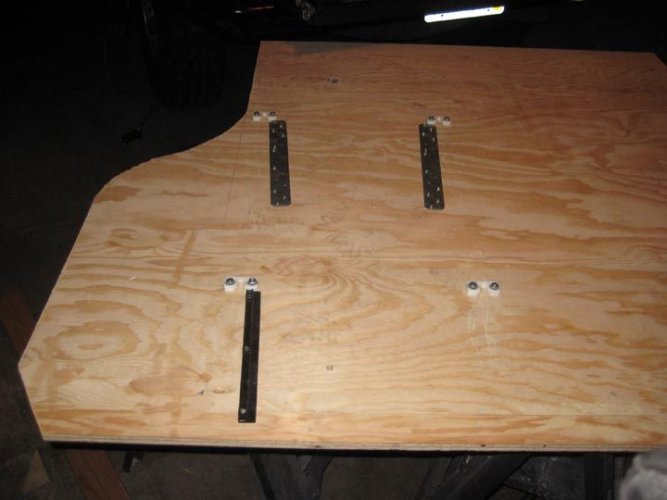

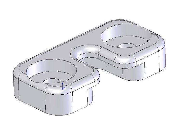

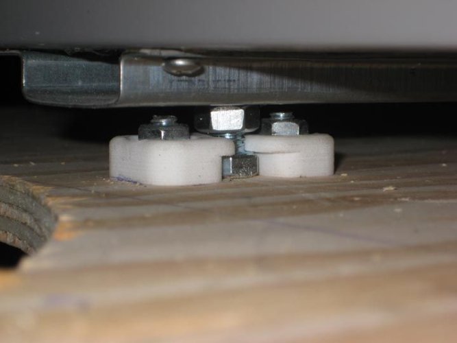

Ok this is what I came up with on Sunday. I'd remove the stock rubber feet from the fridge, and put some bolts in their place that I could use to slide into a custom foot clamp. This is modeled after now the Engel slide thing works.. then using black magic, I'd design & print some custom foot clamps. ;)
the thread type for the feet is your standard M8, same thing that comes out of your 3rd row seat brackets.
So then I made a plywood base onto which I could bolt random things, and temporarily bolted that down. Then I lined up the fridge, marked the location for at least a couple of my new foot clamps, then pulled the whole thing out and secured all 4. I found some random things in the garage that act as guides for sliding it in. Also by adjusting the gap between the bolt head and the jam nut, I was able to dial in a pretty snug fit. what do you think..

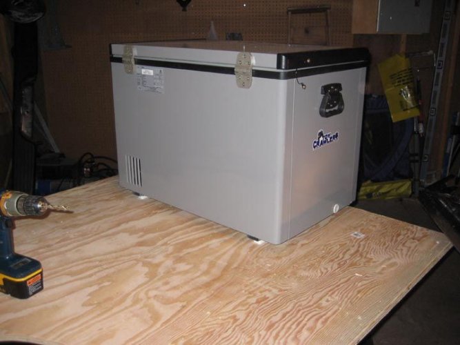

It's not exactly easy to slide, but a lot of that has to do with the weight. I'm using one of the stock Engel fridge feet as a stopper, so it'll take a screwdriver to remove it, then I can slide this out. I think later I'll upgrade to an actual drawer slide, but for now the fridge is secure and operational...
edit: one point of caution with the new "bolt feet," is they will wreak havoc on painted surfaces, hardwood floors, etc. I wonder if I can find some of those plastic caps, like the 80 2nd row bolts have... well another day perhaps, I'm going to bed.

Those look awful small, I'd keep a strap on the handles the first time you take your Taco off highway. The Engel one in my truck, similar location near the back of the bed, has broken a couple of times. A lot of weight + a lot of bouncing + plastic bits = roaming fridge. The Engel uses metal slides but the base is plastic and I've had to heavily reinforce the plastic. Don't let me forget to show you the fridge mount next time I see you.
7,880
Very cool Tim. Are the "feet" on the Engel similar? If so, I might be interested in procuring 4 of those feet mounts. :thumb:
RS Moderator
15,137
Martin the feet of the Engel are a smaller thread- but forget about replicating, I've already got an idea for a better way to do this- instead of the custom nylon pieces we'll bolt a big cutting board to the base of the fridge, then it will slide into a channel. This will get us by this weekend though for the next trip to Moab.
Jeff you should know by now I'm a plastics guy.. metal dealyos are a last resort. :)
Dave I've got the same Engel base in the 80. Maybe it's a coil vs. leaf spring thing, there's no question the ride is smoother and I've had no issues with the fridge base- mine is only screwed down to a piece of plywood in the 80 too. One thing that probably helps is it's shimmed in place by an adjacent drawer system, with usually a lot of junk on the other side of it, so even if the base flexed there's not much room for it to go?
