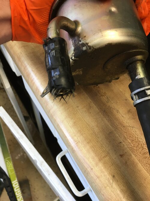

I went ahead and replaced the power steering lines since one literally snapped in half when I pulled the reservoir off.
It also looks like somebody just used a three jaw puller on the old power steering pump gear. It has some decent dings in it in three spots around it. I’m pretty sure this is where my knocking noise was coming from. I’m actually excited to find the damage and replace with the new one..

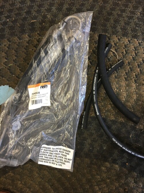

Are you talking about the High pressure hose? It's actually Japanese!!!! Assembled in China though, so I must be hosed.
was that a pun? good one.
9,779
Neither Bruce nor I live in Boulder. We live in unincorporated Boulder County.
I guess we'll see if the Rein Hose lasts. who knows
