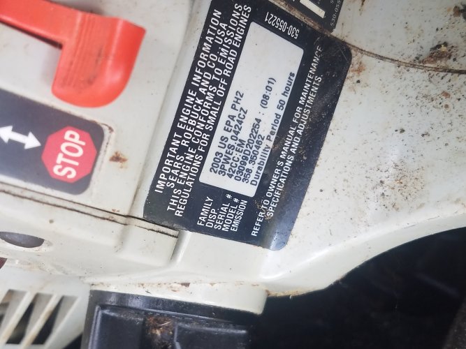

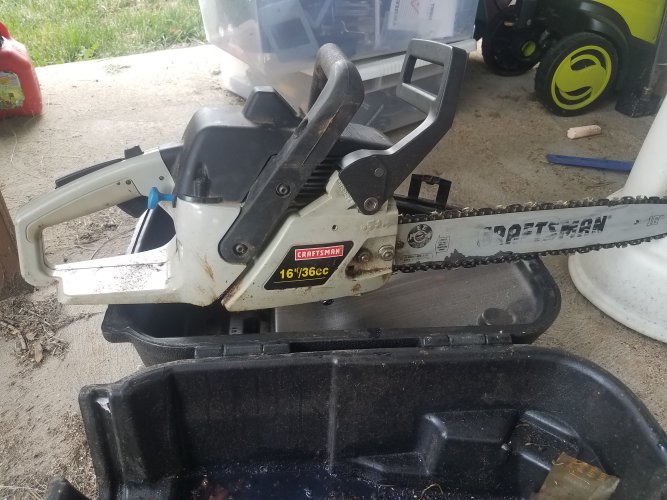

Anyone want a 2003 craftsman 16"? Just tore down an eyesore shed in my backyard and found it buried. Looks like it needs a thorough tune up

:woot: Sure, I'd be a fool not to try it out!

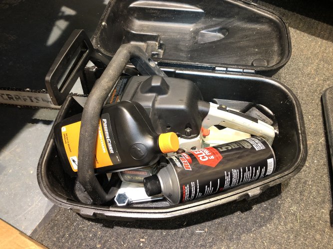

Deep cleaning of bar, brake, clutch area, general wipe down, clean air filter, new spark plug, new chain, oil bar pulley, add gas, bar oil level was ok at 1/2, clean oil and junk from bottom of case. Prime, choke, fast idle lock, 5 easy pulls, started to catch on #5, turn off fast idle, pull#6 its alive! Kit is ready for the trail.
If you must have video: https://markofsky-my.sharepoint.com...ZLqbjw991ToyEBNJNZ1n6zsTI6hY1LBZa82w?e=SvJULd

Hell yea! You’ll get your free out of that for sure.
