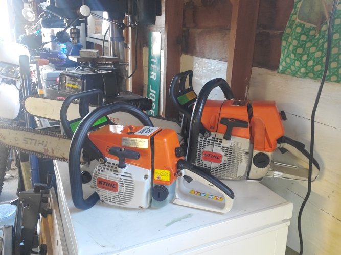

Hey, just stumbled on this thread! I'll add my bit: just got a heck of a deal this week on a Dolmar 510: 20 bucks and a pair of mule deer sheds. Seller thought it was broken. Just needed fresh gas and a few pulls. This is the smoothest saw I've ever ran, and super powerful for 50cc. Dolmar is a German brand that never quite took off in the US. I also run a Stihl 064 that I traded a couple hundred rounds of .308 for, and a little Husqvarna 435 for small jobs. I rebuilt the 064 and have replaced a lot of parts with NOS stuff. Now I have the Stihl bug, and I'm on the lookout for a project 044/440 or 046/460. Anyone got a broken one laying around?

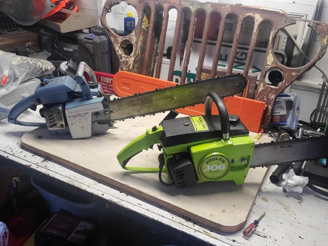

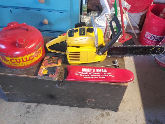

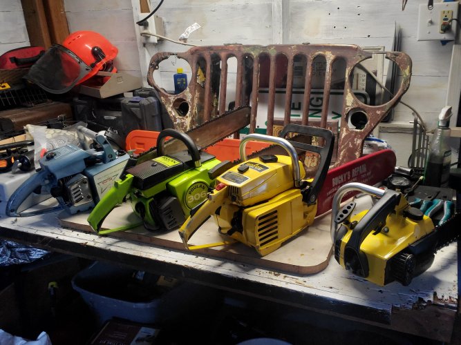

Well, now I've gone off the deep end. I posted a
local ad a couple months back stating that I work on/buy/sell chainsaws and now I've acquired these super cool retro saws, among others. Poulan 306a, Homelite Super XL, McCulloch Pro Mac 10-10 and Mini Mac 35, and Stihl 026. I also cleaned the frick out of my 064 and bought some parts for it. Still looking for an 044. I have flipped quite a few over the last few months: a few stihls, husqvarnas, and Dolmars. If you guys need saw work, I can probably do it for you.
