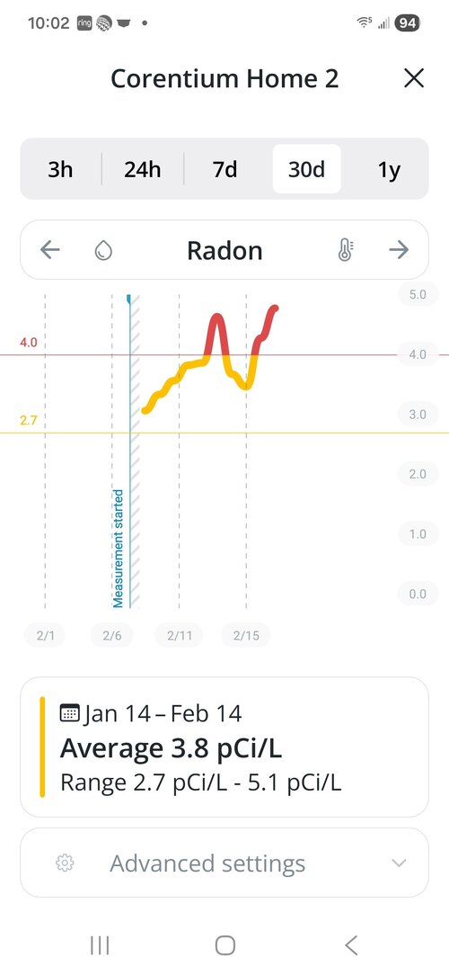

I bought an Airthings Corentium Home 2
I know you have to leave it for 30 days, but thought I would spot check some locations
10 days in the basement on the pool Table. Feb 8-18
No idea why the spikes. Indoor Humidity steady between 30-34%. It has been windy outside last few days
Moved it upstairs onto a bookcase in my office and will leave it there for 7 days

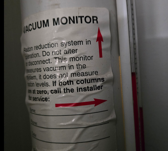

I do have a Radom mitigation system that is 20 years old. The gauge is in a place you can't see in the garage unless I pull the fridge out. I will have to get a look at that
Windy days can give you negative pressure in your house in relation to outside pressure depending on roof ventilation. We used to see the water drop in the toilets on windy days at our last house.

We have had the same sensor, unmoved for 43 days. The amount it swings is pretty wild. We can't tie it to wind, barometric pressure, diurnal patterns, moisture, anything... All of those things seem to move the needle slightly, but the values just seem to have a mind of thier own
I no idea if any of it is accurate. I also notice that it has climbed steadily over that time, which I dislike.
Our levels are generally lower than what you've shown - we do have a mitigation system, a very basic one, installed.

In my office it dropped down over a day and now is between 2.3 to 2.5 over the last 3 hrs. I know 3 hrs isnt anything to count on. I will leave it here for a few weeks to see how it trends and then likely move someplace else on our main floor (Ranch house)

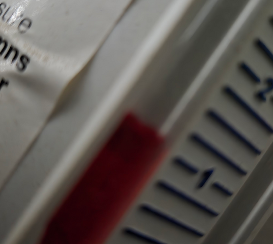

I took a look at the gauge on my Radon mitigation system. It measures vaccum and not Radon. I read between 0.5 and 1.0 shows the system is working. It shows about 1.1
