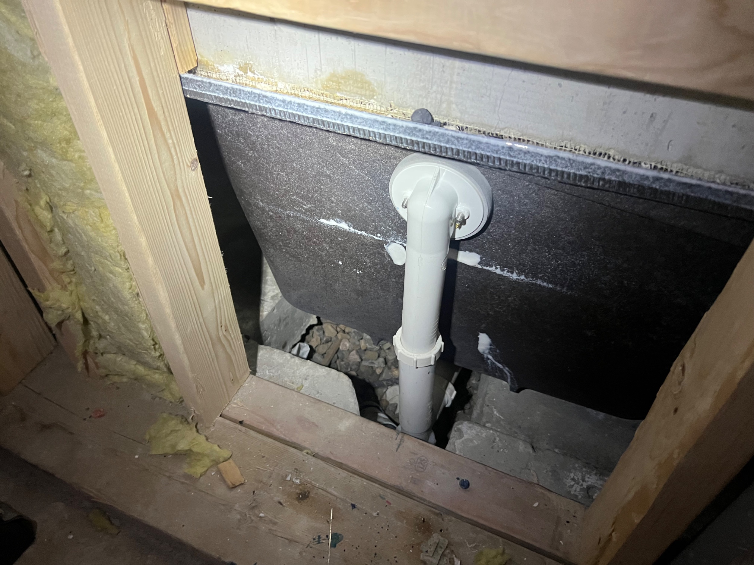

I just ran a test for Radon and it came back high. We remodeled a basement bathroom and I’m pretty sure this is the source. This bathroom was not part of the original home build AFAIK. There is a hole cut in the basement floor foundation for a bathtub drain. I could just fill this with concrete but then if we ever need to service the plumbing it’s a new nightmare. Any suggestions to seal this up in a manner that could be removed if needed?
Terrible picture for viewing pleasure. At least I have some access.
10,032
My two current leading options are spray foam to seal the hole. This would be a pretty easy install. That crap is pretty much impossible to completely remove in the future but cutting out enough to service the plumbing should not be to much hassle. If this does not work I've got a real mess.
Option two. Pour a thin layer of concrete. Thin enough that you cold break it up with a hammer and remove if required in the future.
Any other ideas?

You will want a vapor barrier, I would Sikaflex down a piece of heavy plastic and top off with a piece of sheetrock to protect the plastic.

Please expand on how you'd address the bather drain plumbing and the fact I can't really get good access under the bath tub.

This is my mindset. Looking to solve this myself if I can before calling in a pro. If I find a solution that significantly drops my readings I can wait until summer to have a vent system installed.
8,028
Hey Corbet, radon is really common here in Iowa. When I moved here I checked and it was high. It's not as easy as just sealing it off. I used a mitigation company and they drilled a bunch of test holes in the basement slab and tested the flow under the slab to determine where to install the air pump(s) I had good flow so only needed 1 pump, which pulls the gas from below the slab and pushes it out above the roof. My whole system was under 2k installed.
For your bathroom, they would probably just need a vapor barrier below that plumbing and then a radon pump could be installed further away.

Problem I have is that this is a finished basement with carpet and title floors. Drilling test holes is highly undesirable.
When we bought the house in 2008 we had it tested as part of the home inspection. It failed and the sellers did some mitigation which included sealing this exact hole with 5e old bath tub. They also had a vent installed on one side, no blower. It then passed inspection but with what level I no longer recall. I never retested until now as we reopened the hole. At this point I do wish I had more data.
