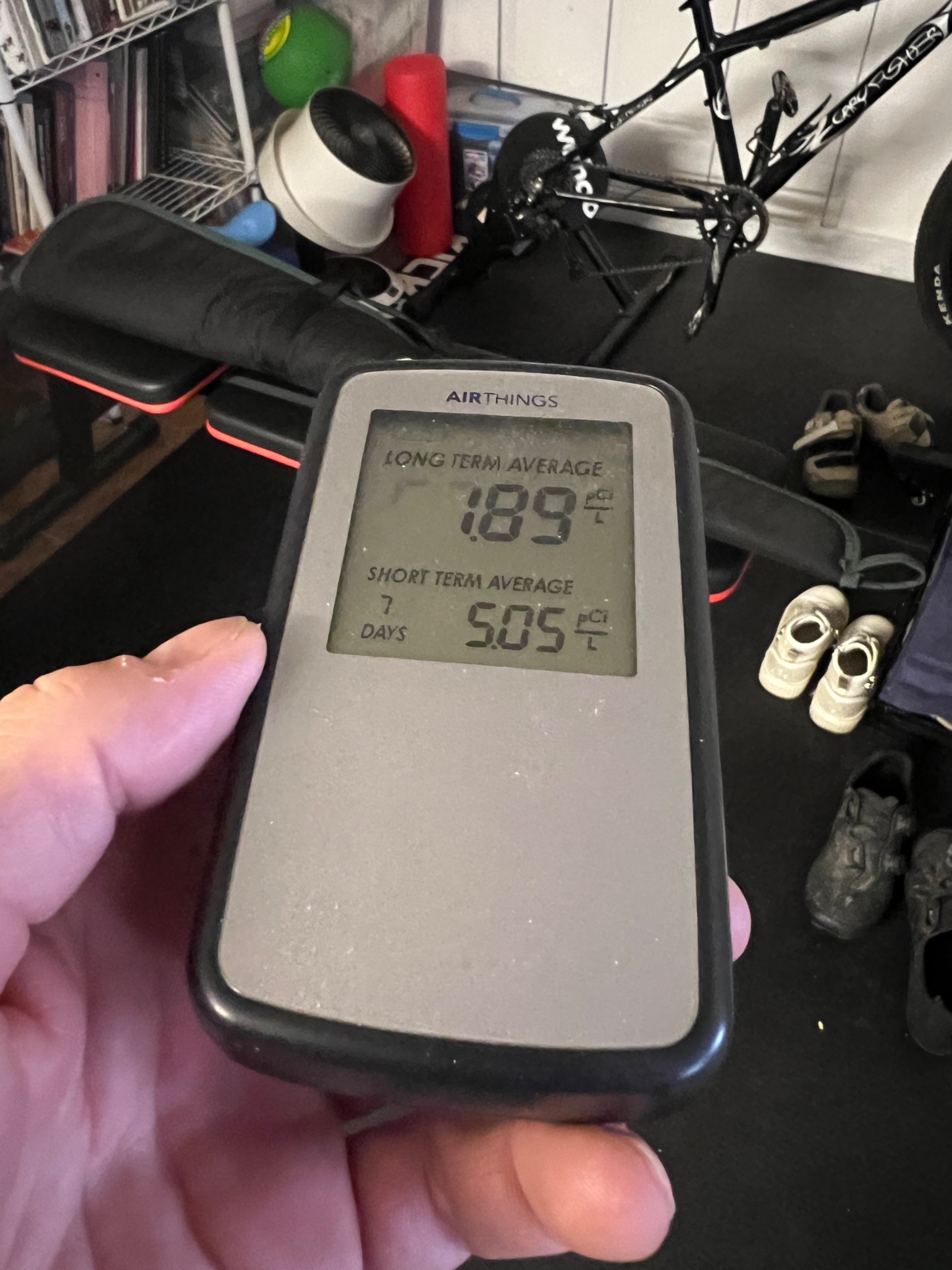

9,814
I have an older Airthings unit. A few others were recommended above. I like it because I can move it around and get readings from different areas and rooms to get a picture of what’s happening. Not only that but as mentioned previously in the thread time of year, weather, and stuff like doors and windows opening all affect it so having a device that you can monitor is convenient and paints a better picture than the test kits that take an average of a few days in one location. In our old place it was handy for confirmation or the fix. At the new place I’m still understanding the exposure… been checking different rooms and getting long term averages to get a truer picture. Started in daughters room which is upstairs and it has high ish numbers which may seem counterintuitive give it’s elevation. Basement kinda bad (adjacent to crawl), dungeon (slab on grade, pic below) worst so far.

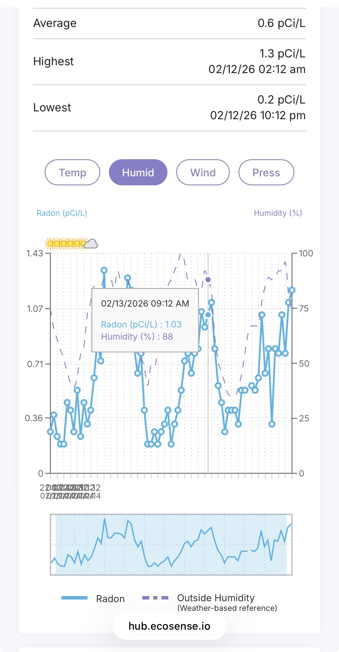

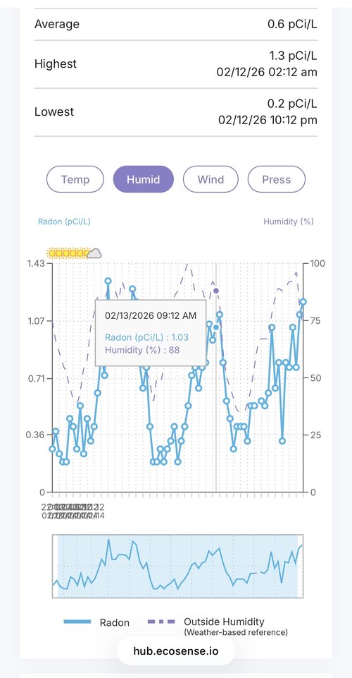

I finally purchased an Ecosense ecocube and having been monitoring for a few weeks.
The app will do a radon analysis mapping temp, humidity, wind and pressure.
Even though it’s warming here I am starting to get some spikes on levels, though still safe. Appears to coincide with a rise in humidity.

4,882
Makes the single level reading I got with the state supplied test kit seem rather inadequate. At least it was free but now I’m thinking a unit like the Ecosense makes, uh, sense.
