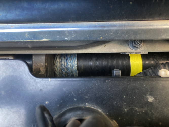

Note that I'm still using 5/16" on a 2.5" x 10" drum.
I've not taken the time to mark my rope to know exactly per layer lengths and if I'm ending up with the 32 turns the numbers say I should. But by the my-armspan-is-six-feet ruler I want to say (it's been a while) I have about 24' on the first layer and 30' on my second. I usually end up with around 5 or so turns of rope on the 3rd layer when I take the time to spool it carefully.
FWIW, the drum on my winch is approximately 15-3/4" around at the bottom and should be about 18" around with one layer of 5/16" rope on it.

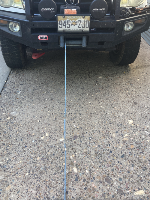

I'll have to pull it and check now. It's literally been 3 weeks since I even drove my truck and that was just to Palisade for the bluegrass festival.
14,252
Alright, pull my rope. ;-)

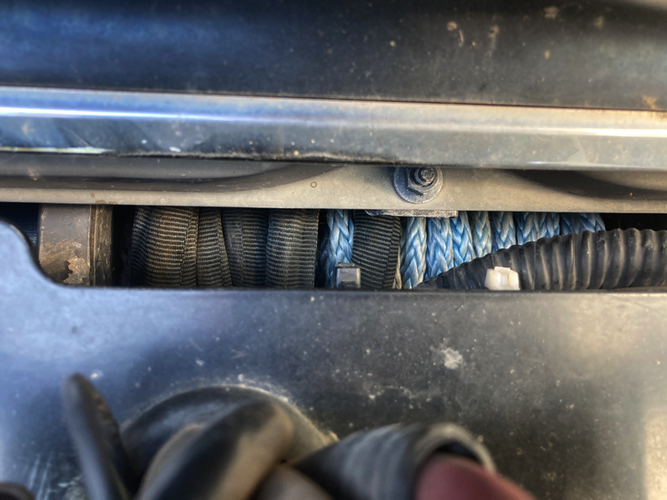

From the thimble to the Stop Here mark I have 11 arm lengths, so must be 65' of usable length I intended, not total length. It seems I have ~75' of rope. Which adds up. I have a 25' extension, the cut I made from my original 100' length. Duh.
From the white tape stop to the drum is I'd guess 5 or so feet plus 4 wraps still on the drum so it appears I wanted to keep I'm guessing 10 wraps. I normally stop unspooling when the white tape shows at the fairlead. The yellow tape is the tail of the rope. I'll have about 1/2 the drum for 1st layer pull.
Spooling lazily I got two and a half layers.
2.5ish.
It's a very badly spooled 2.5 layers. I gotta pull the truck to a dumpster or something. Walking the rope in never works for me, I always end up with gaps. I do not like being unable to really see dark colored rope in my ARB.
Two layers should have a circumference of 19.6" ideally. So that's pretty close, calculator says it should be 9.8' for 6 wraps and I have I'm pretty sure 12' (maybe 10', I dunno) of tubular webbing for the guard.
One thing is for sure, I need to be much more conscientious about my workmanship on spooling.
