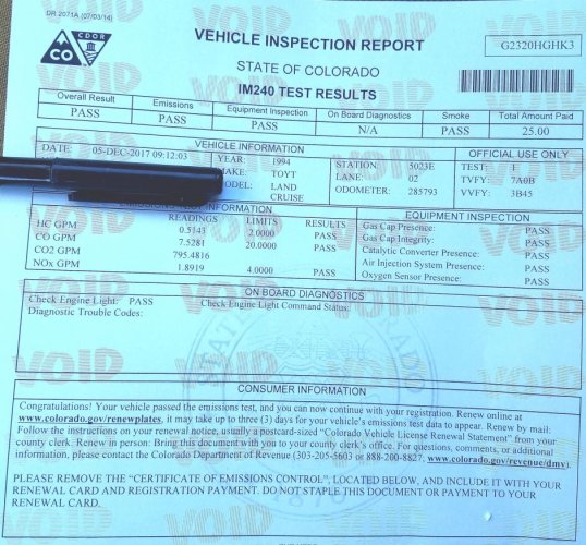

I listened. Also changed oil like you said. Remembered my emissions gas cap. I passed. Dacono site rocks. 25 miles of highway to warm up. 55MPH frontage road. 2 AWD lanes. No lines. Happy days!

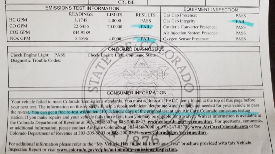

So I had a long day of emissions testing. Got up early to change the oil and take everything heavy out of the truck. Cleaned the air filter and the PCV valve. Put two bottles of ketchup heat in the tank and put about a half tank of premium gas in. Drove up to dacono to the testing station and I was turned away due to the size of my tires (315 75r 16). I was given a vehicle unable to test form and told the only station I could test at that was closest to me was in Sheridan. So I had to drive all the way to Sheridan and test down there. Got down to there and I was failed on the gas cap but I also failed on CO and NOx. The readings were not super high just enough to bust. What can I do to get those numbers down?
Thanks.

How are your plugs wires cap and rotor? Have you taken cat temp readings, or how old are your cats? Is your check engine light off per the above post?

Cap and rotor is about 5 years old. Plugs and wires about a little over two years old. I replaced the entire exhaust from the headers all the way back two years ago. I went with Toyota down pipes, Y pipe and tail pipe. I did after market with the resonator and cats. I bought bosal cats which may be the issue. I just didn't have 1500 for Toyota cars. The CEL is clear no issues. Slee worked some magic for me on my EGR system. Kept throwing a code 71.

Put little tires on and try the exact same thing. There are some emission tires running around somewhere.
I think Cheeseman has em.
14,144
Northside
Your problem is classic Cat problem, Ignition issues would drive up the CO but high NOx has cat written all over it. Getting the cats really hot is the key! I have a full set of 97 80 wheels and stock tires your welcome to borrow, that's what they are for. I'm in Louisville. When I had the 6 in my 80 I actually installed flanges on the exhaust pipe on both sides of the converters and swapped the high flows out for some inexpensive (relatively) universal OE replacement cats just for the test. Unfortunately, the standards we now have to meet are stricter than the 80 series was designed to achieve.

Right on, thanks Uncle Ben. That was my concern using aftermarket cats when I installed them. I'm out to golden today to pick up a new gas cap at least from Stevenson. I'll PM you to see when would be a good time for you to pick up the emissions tires. Thanks again.
