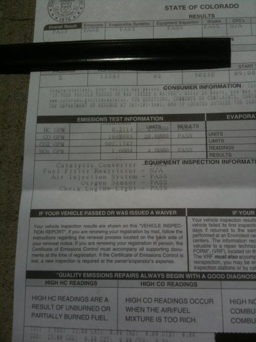

It finally passed!!!
So here are the numbers after swapping out both Cats.
I am still not happy with the CO number. It seems like that is still a bit high. (I plan on testing the PAIR reed Valve this week)
Any ideas how to drop that number? (I don't want to have to go through this again in 2 years)

I may ask Treeroot if he wants to get together and make some youtube videos on how to troubleshoot each of the components involved.
I would check the EGR, EGR vacuum module and VSV before putting on cats.
All three are pretty straight forward to test and a lot cheaper than cats.
Do you have a green top or blue top EGC vacuum modulator? (The green tops have a filter that can get plugged)
3300 for cats seems very high. There isn't much to swapping them out. I ordered 2 from CruiserDan and it only took a couple of hours to swap them out.
(I had to cut off all of the bolts with a sawsall)

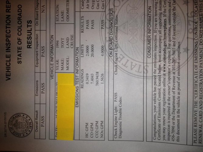

Passed on my first try this year :)
Myself and Treeroot cleaned the MAF,changed the oil,changed the air filter and ran a couple bottles of Red Heet with 91 octane.
Also I think it helped that it was around 40 degrees out.
(Sorry for the sideways photo) Darn iPhones.
The truck has never ran better.

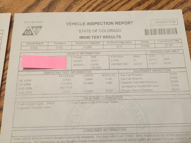

Here we go again....
So it looks like a new failure has popped up this year. :(
CO GPM and HC are very high numbers.
Did all the normal things. Cleaned the MAF, ran a bottle of Red HEET.
New air filter and gas cap....
Cleaned up the distributor. Also checked the timing and it is still spot on.
Looks like this failure is a pretty solid failure.
Also they managed to get the truck to throw a CEL 25 during the test.
Any advise?

Nemo
Mar 31, 2006
351
Newer cats or O2 Sensors. If not one of those probably would do the trick. The numbers to me make me think you could slide with O2 sensors but hard to say if you might need both? Didn't see how many miles on the 94? Edit just saw the miles. 243 and some change. Nicely done. :-)
treerootCO
5,424
The two O2 sensors and the two new cats have 57000 miles on them and have been installed for four years. I'm wondering if his truck has always ran lean for some reason and the cats worked to mask the high CO numbers. Too expensive to swap cats every two years.
Snowrun
Aug 20, 2009
500
Denver,CO
Simps80 and I changed the MAF last night. (just because we had a spare). It seems to run a lot cooler. I am planning on getting under the truck today and looking at the harness wires going to the O2 sensors. I am seeing a few post on mud about wires having issue. If that checks out I am going to see about getting a couple new o2 sensors.
