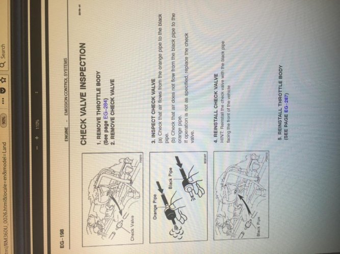

Emissions system wise, PAIR valve and cats are generally what control CO on your truck. Fuel injection system and ignition are obviously the #1 controller of emissions. A bad fuel pressure regular could easily cause this. Can you post a photo of the total result?

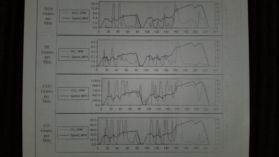

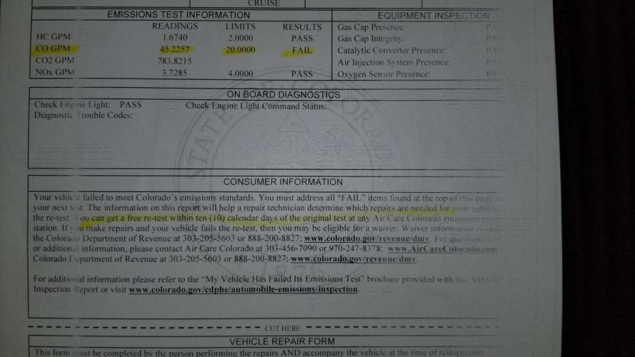

Here are the results from the last test.

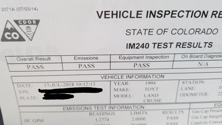

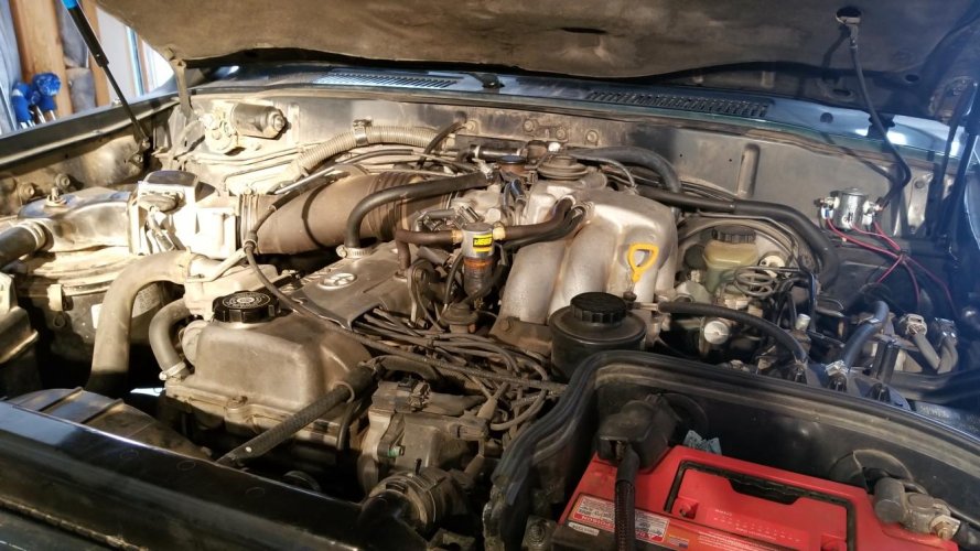

Finally flippin passed! Yikes!
