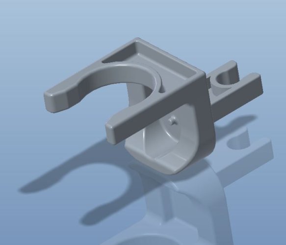

I modeled up the Speedo Cable clip in case anybody wants one.

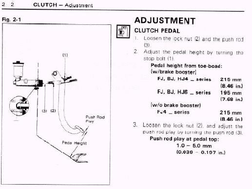

Clutch Pedal Adjustment:

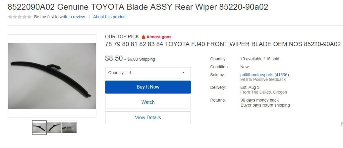

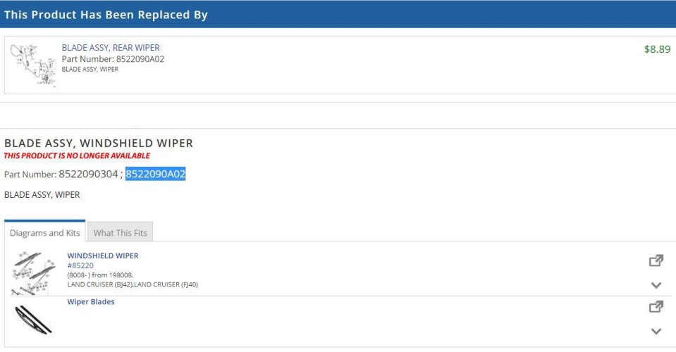

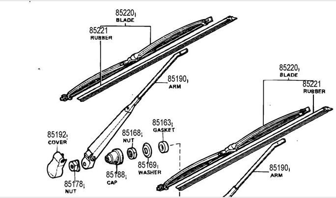

So they updated the OE wiper blades for the 40s from steel frames to plastic ones?
9,584
They are actually steel.
Maybe I got black where they should have been chrome... I dunno. let me double check.
9,584
Double checked and according to the diagrams it is a NLA part (8522090800) that has been replaced by a different one (8522090A02).
I got the 8522090A02's.
I'm not sure what the 8522090800's look like.
