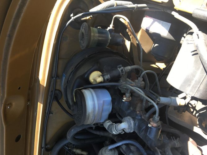

Is this the clip? picture borrowed from mud:
clutch-master-jpg.409876
9,584
Yep! That's the one!
15,201
So what goes in the clip? No clip here...

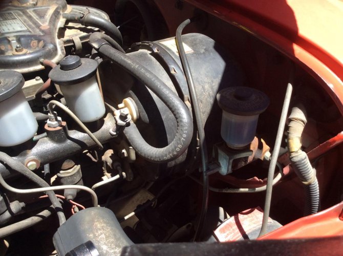

The first photo in this thread shows the routing near the top anyways.... nearer the bottom it goes on a metal flexible body clip thing on the big rib coming out of the firewall. The routing keeps it far from the exhaust.
I also just realized it showed the brake and clutch line routing :/
9,584
Awesome Thanks Bill!! That's a shot of the clip on the firewall. I'm going to install it tonight!
