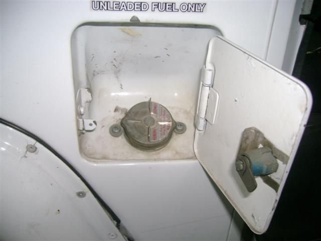

unleaded only sticker location from another vehicle as a cheat sheet for me.

That is one I just couldn't do... I got a new sticker, but put it inside the door.

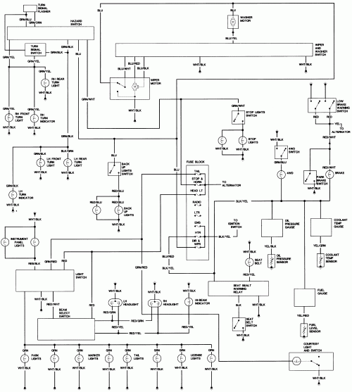

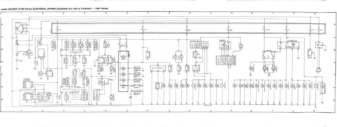

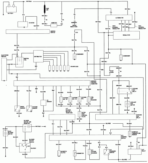

I spent some time today pouring over diagrams for the tail lights today since a PO butchered the wiring adding a trailer light converter to the rig... In doing so I noticed I used a Black wire for the license plate harness where I should have used a green wire. I'll have to re-do that one. drat.
Here's a collection of diagrams from similar vintages for posterity. Top ones are supposed to be for 1982.. bottom is supposed to be for an '81:
