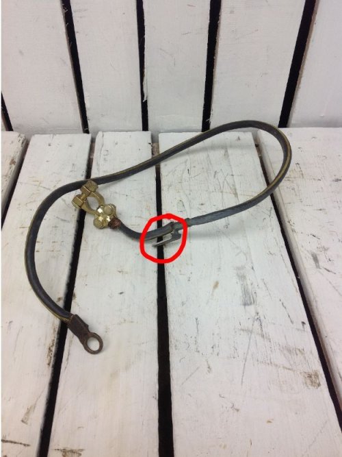

Here's another question....
Does anybody know where the circled part of the negative battery cable goes? I can't figure it out. I don't remember how mine was routed.
