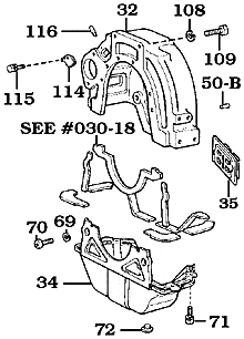

The deal is in the FJ60 there are no rear motor mount brackets attached to the bell housing. The 60 bell housing may not be threaded for the 40 mounting brackets. If you look at the picture I posted up in this thread, you'll see the mounting holes on the side of the bell housing. IIRC, the FJ60 doesn't use those, it relies on a cross member under the tranny/transfer case for rear support. Take a look at your bell housings. If the holes are there then I've been leading you astray.

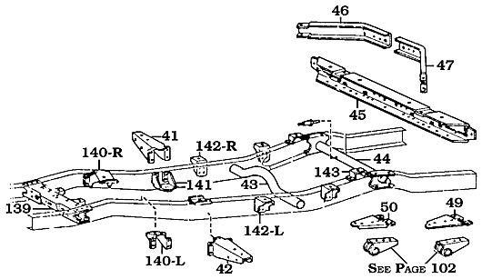

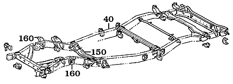

Here are the frame comparisons. The first pic is the FJ40 frame. Note the rear mount on the PS, part #141. The second pic is the FJ60 frame. Part #150 is the cross member. Could that be adapted for the FJ40? I don't know. :D
