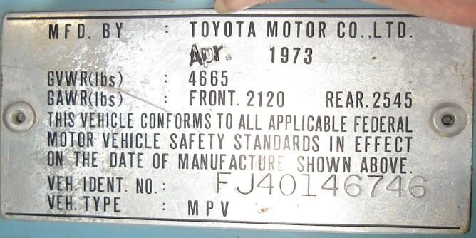

That's stock. 7/70- 3/73 and 3/73- 1/75 have a booster and 2 cup master that dumps out between the cups. As far as I can tell they are identical 47210.

Cool...and where can I go to decode my VIN to find out more info on build dates? :)
