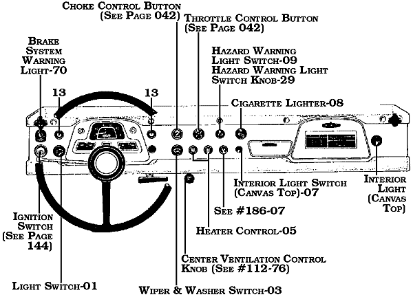

if you want to get rid of this switch on the right below the blank let me know ;)

Panic button?
It opens and closes the convertible top?
Might be a hazard switch. I have some old switches like that that are red.

From SOR's website. 1968-1972 dash. It's a switch for an interior light when you have a canvas top.

It's definatly a "room lamp" switch...

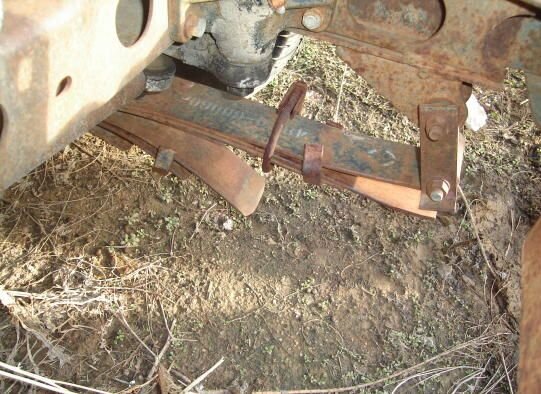

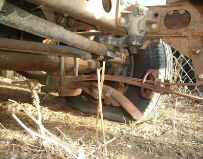

I have brakes. :) Found the right bolt in the coffee can, filled with fluid, and bled the system. The nasty dark rusty fluid is out and the brakes work well enough to stop the 40 from rolling out of the garage! :) So I moved on to the beautiful leaf springs. Ige is trying to tell me this is not stock, is she crazy? :D Got the damaged leaf off last night with some help from a BFH. Picking up the used leafs this weekend, will probably go ahead and swap out all 4 while I am at it. Had my first 40 related injury...went to go under the 40 to bleed the brakes and forgot the broken leaf was hanging so low...right on my forehead. Nice golf-ball sized knot. Luckily, I have a very hard head. Wife was surprised when she pulled in the garage at 10pm, and I come out from under the truck with a huge knot and blood on my forehead. I am a hockey player, so I guess she is used to it. Thanks again for all the support and advice! Hope to see a lot of you this weekend at the raffle rig.

Glad you're making progress. That spring looks stock to me, just not the shape of it. I found 3M wheels that look like a big black scotch brite to work much better than wire wheels, but you can eat them fast on sharp edges. Are you driving that to CM07? If so, you may have hit your head a little harder than you thought.
