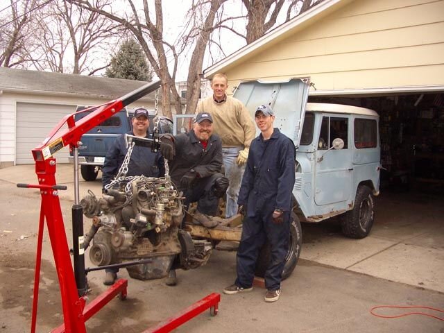

Heh. After scrounging up hardware and motor mount and assorted trial and tribulations, we posed for a group shot...Landing the Big One :-)
8,681
uh...isn't it supposed to be IN the cruiser?:confused:
10,762
It was about 15 minutes later :D. That was a lot of fun guys! Kinda too bad we had to go back to the 3spd tranny/tcase for now, but like you said Timm, getting the engine in is huge in order to get the thing on the road!

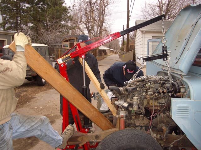

The engine is in. This one went in a whole lot smoother than it was coming out of the piggie. Echoing what Matt said, it was bunch of fun working with you guys yesterday afternoon. I'll see about getting some pictures posted up this evening. Now that the engine is in, Timm is one step closer to getting his FJ40 on the road.
